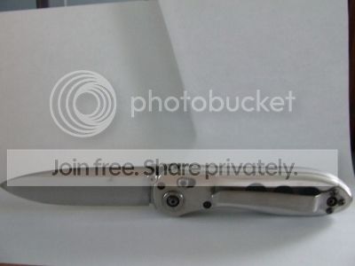

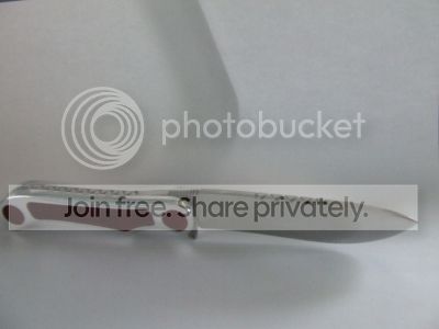

Would this count since I'm just starting out? The red one's made from a file, the folder took a lot of machining though.
I think they are talking about doing it semi-machineless, i.e. no belt/bench grinders, no drill presses, no power hammers, etc.
