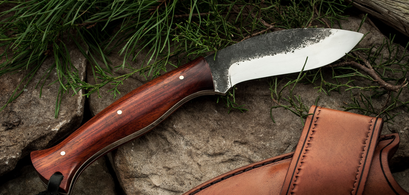

Which kami made it? It looks like a nice one. I have a WWII like it, and still really like it even if my favorite is a lightweight Chainpuri.
For those curious, only a month later the mystery solved as to who made such a knife.....busy girl dearest Yangdu was kind enough to answer my question after i gave up on normal channels...it is Ganga Kami work....and fine, it is...
Knife by Ganga being used to spread and lift boardwalk with screws pulling loose...had to stop before wrecking my walk.....same same when i bashed rails and post tops with knife spine and flats.....good knife....
