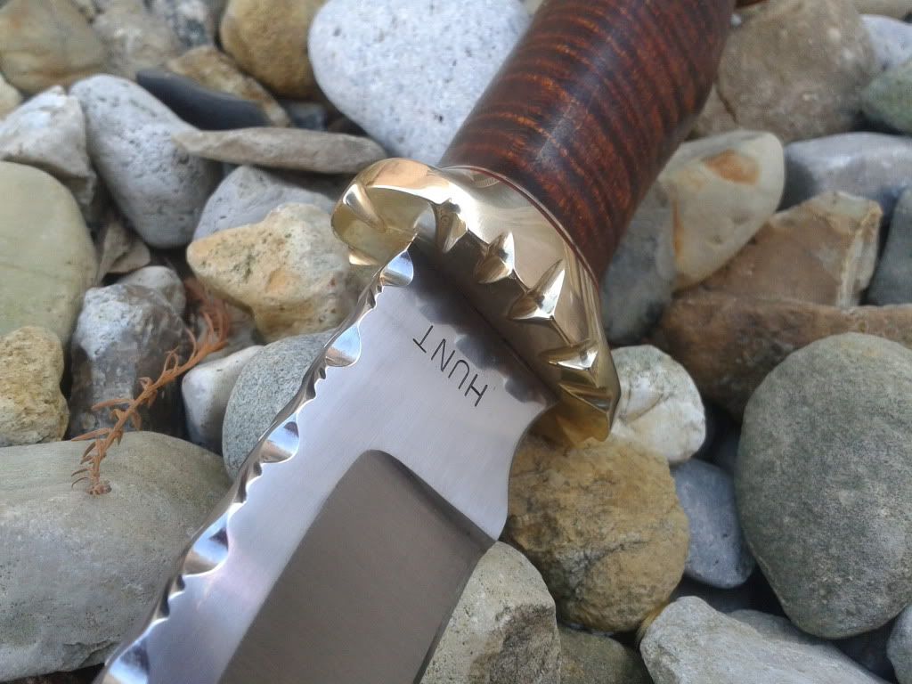

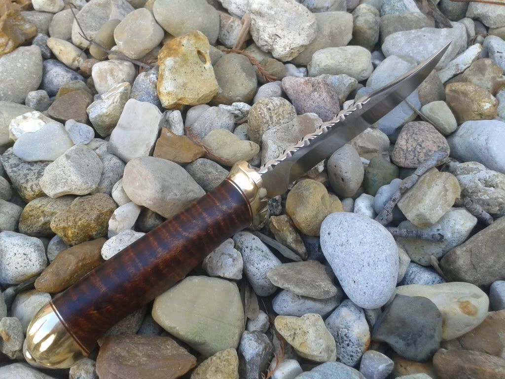

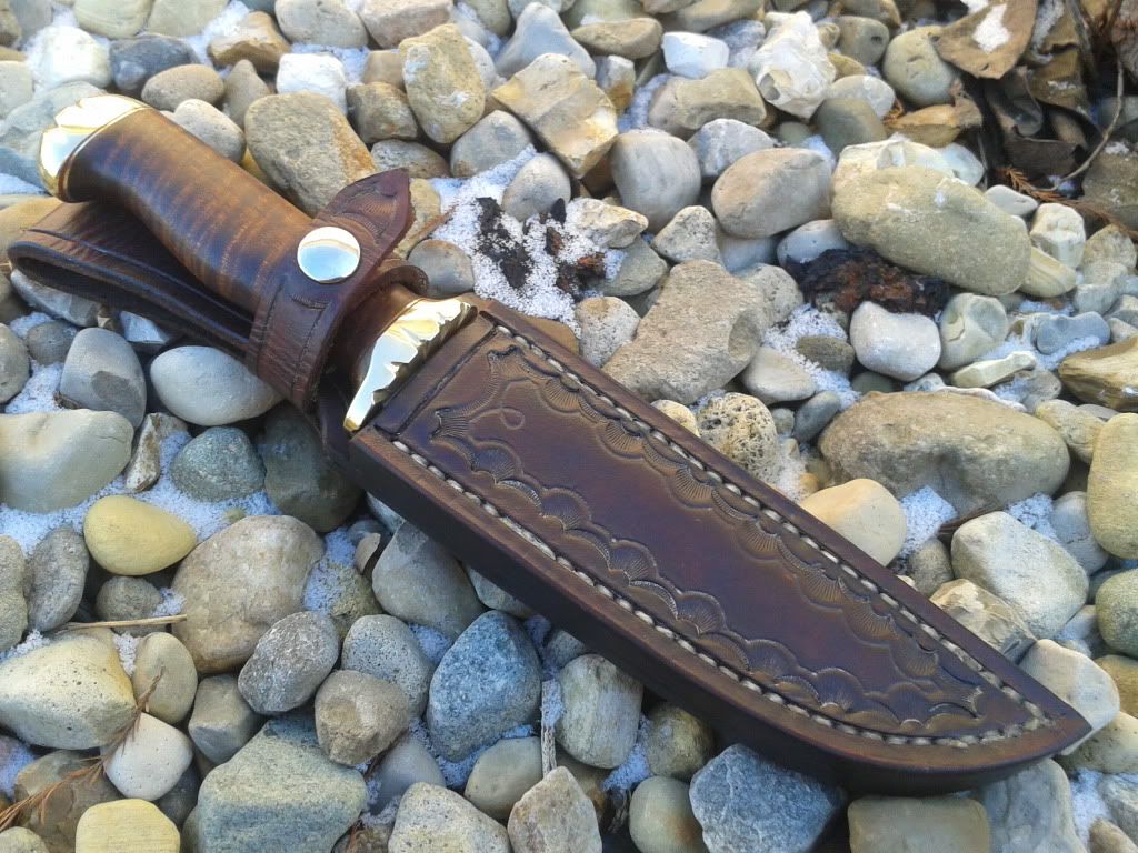

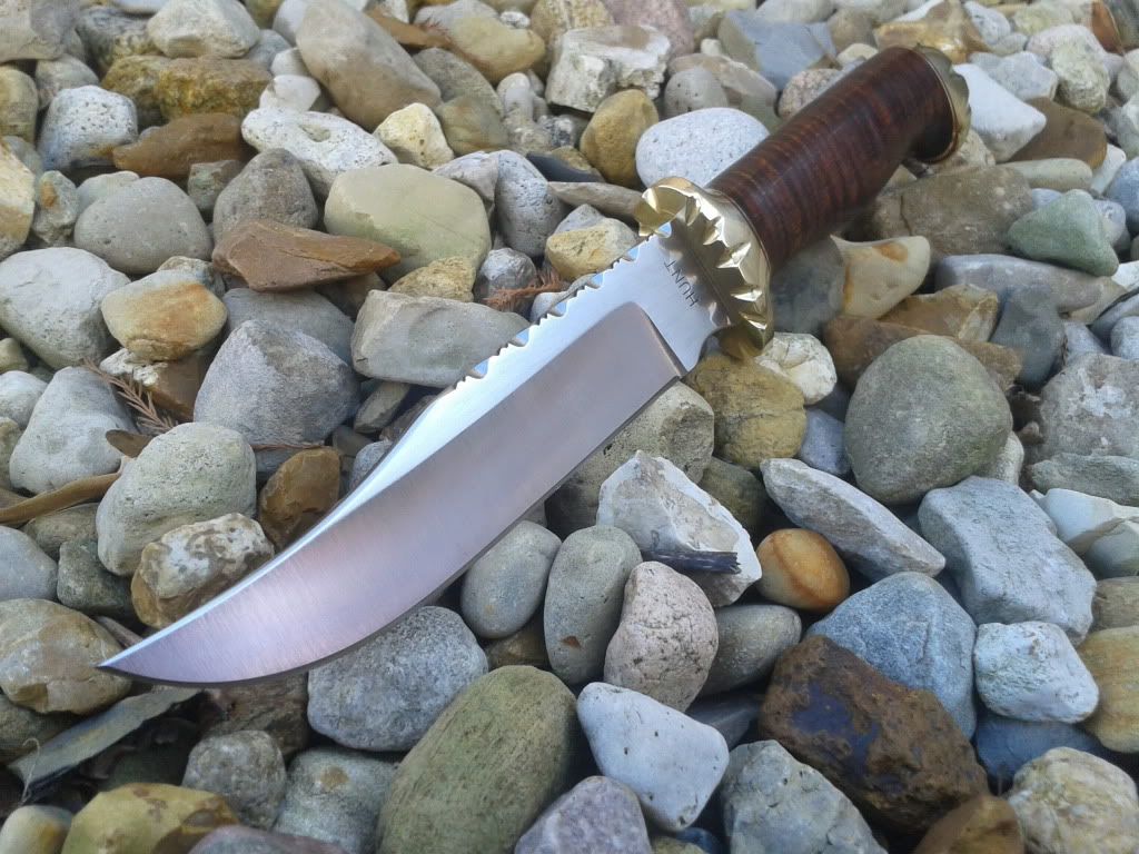

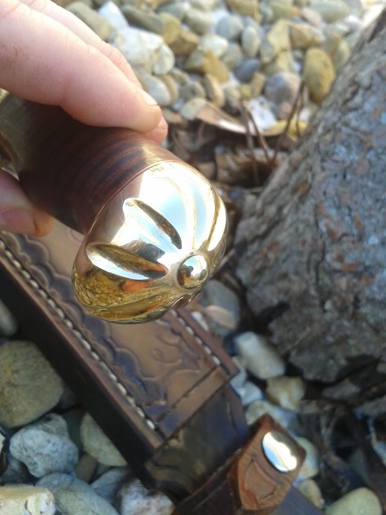

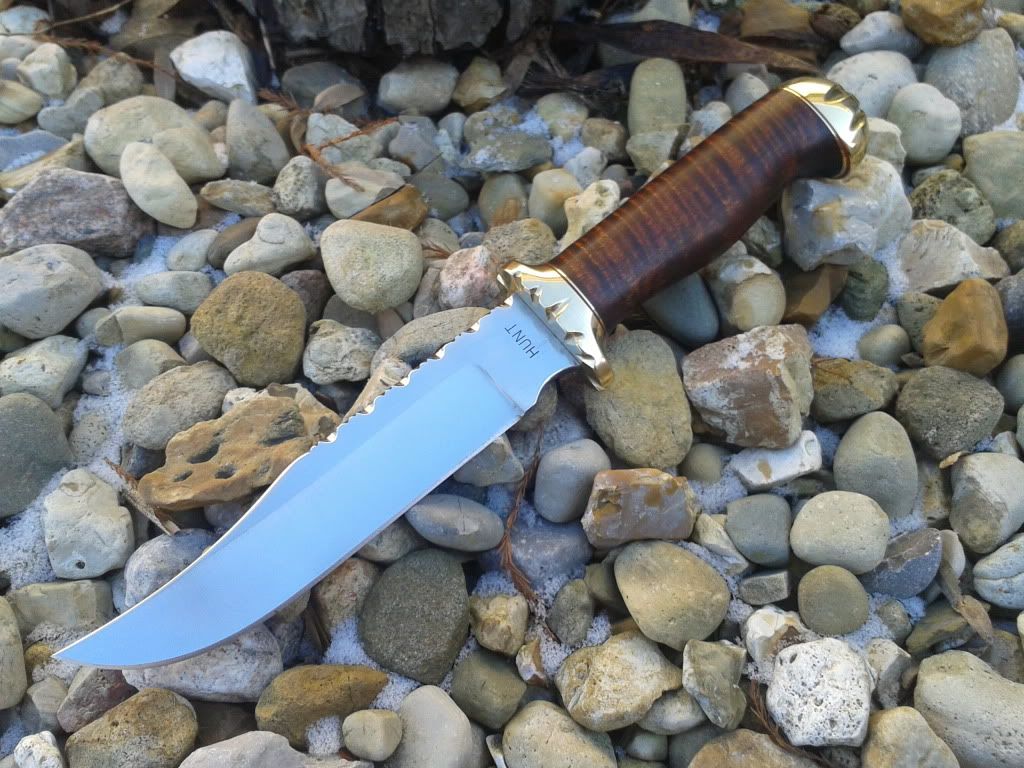

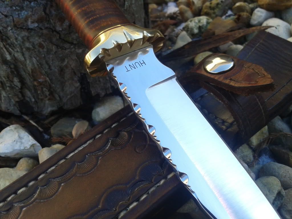

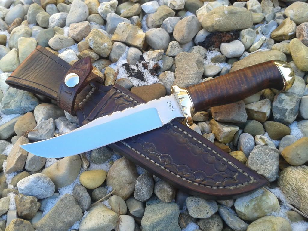

Now unfortunately, I didn't have time to get pics of the first two knives. Turns out, Uncle Dave was traveling through this area a couple of months ago, and asked if he could stop by to see the shop, I of coarse accepted, and literally finished the two knives a day before he came by, and off he went with him. But, I did get pics of Uncle Daves knife, and here it is..............
Specs:

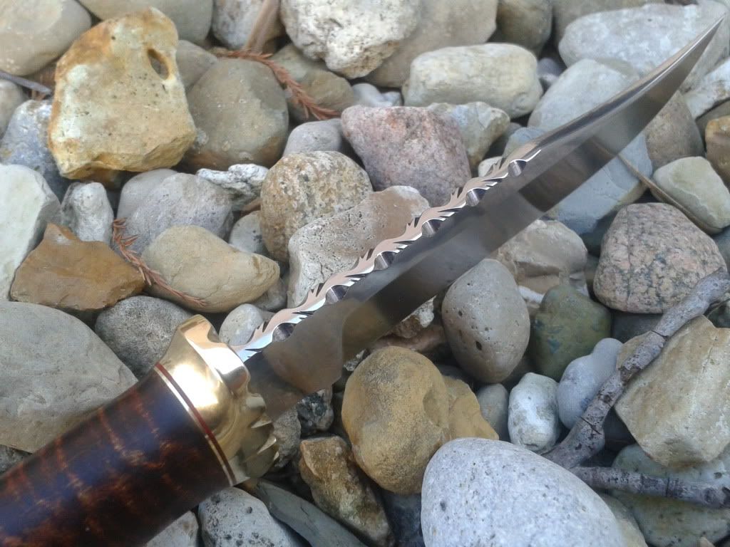

6in. hidden tang blade 3/16 thick 01 hollow ground, 57 RC
11 in. OAL

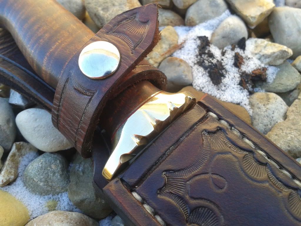

Curly Maple handle, red inlays, brass furniture
Vine fileworked spine, and what I call rising sun filework on figergaurd and pommel.
Medium brown dyed handmade, handtooled, handstiched sheath.
I was really glad to do this project, Its fun for me to get back to doing one offs and doing stuff to let my more artistic side shine. Not to mention that this will also end up as a family heirloom according to Uncle Dave. The thought that it may be admired by people well after I'm dead and gone really makes me feel good that it turned out well.
Thanks for lookin!
