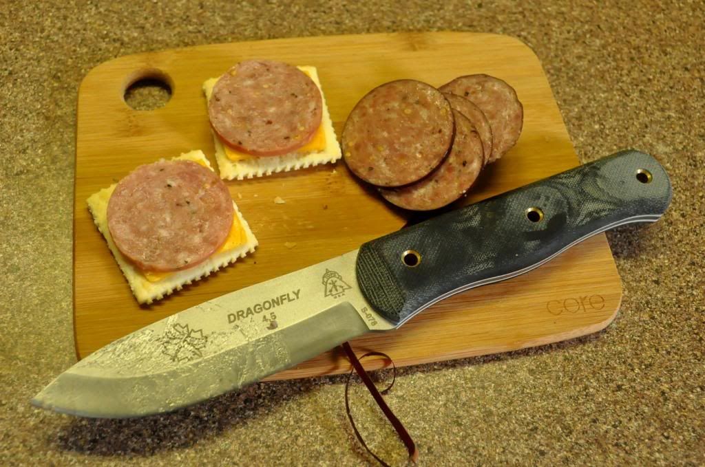

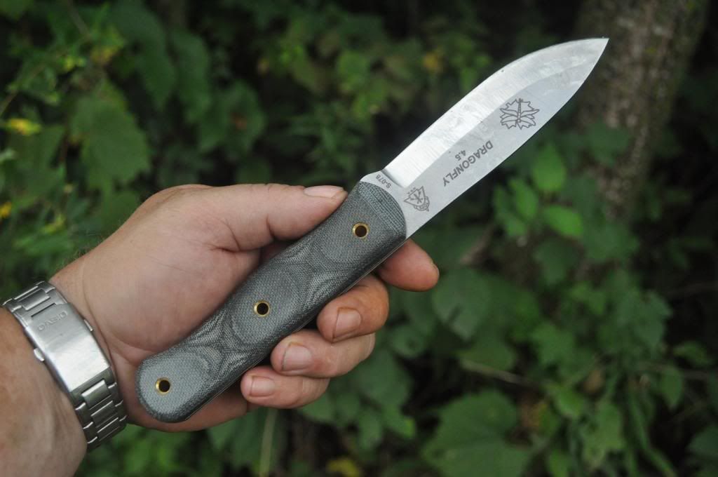

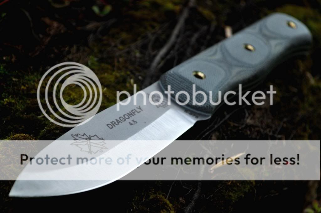

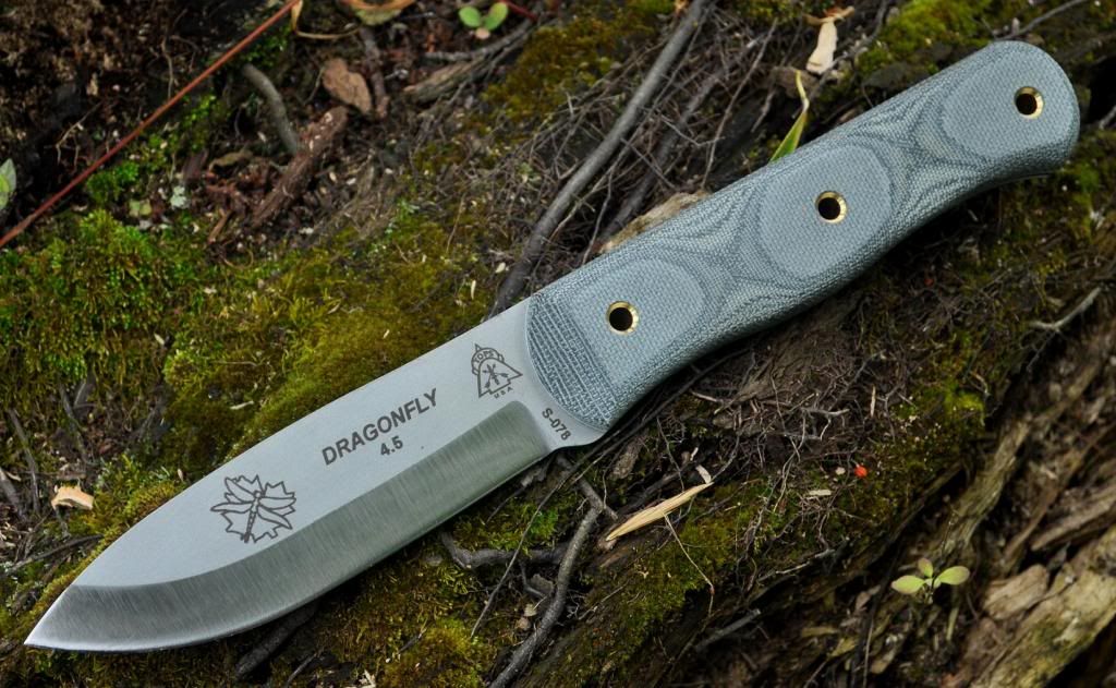

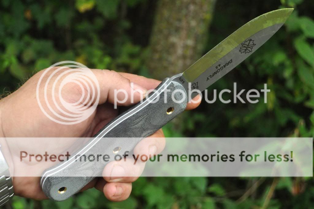

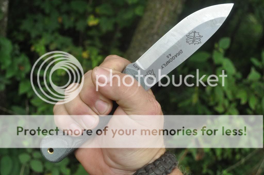

I've heard many times that people don't like coatings on carbon steel blades, so I thought I show a little something different from TOPS Knives, The Dragonfly bushcraft knife designed by Caleb Musgrave
The specs from TOPS' website
O/A Length: 9 ¾”
Blade Length: 4 1/2”
Thickness: 1/8”
Steel: 1095 High Carbon Steel
Handle: Black Canvas Micarta
Blade color: Beed Blast Finish
Sheath: Ballistic Nylon
Designer: Caleb Musgrave

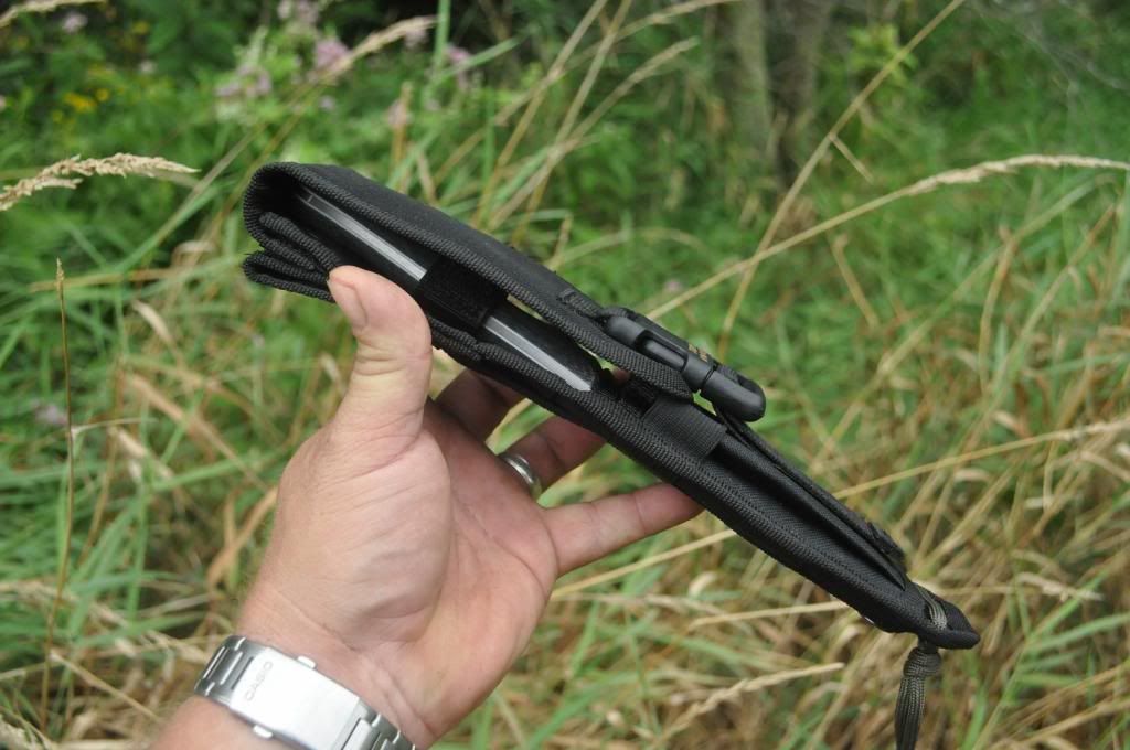

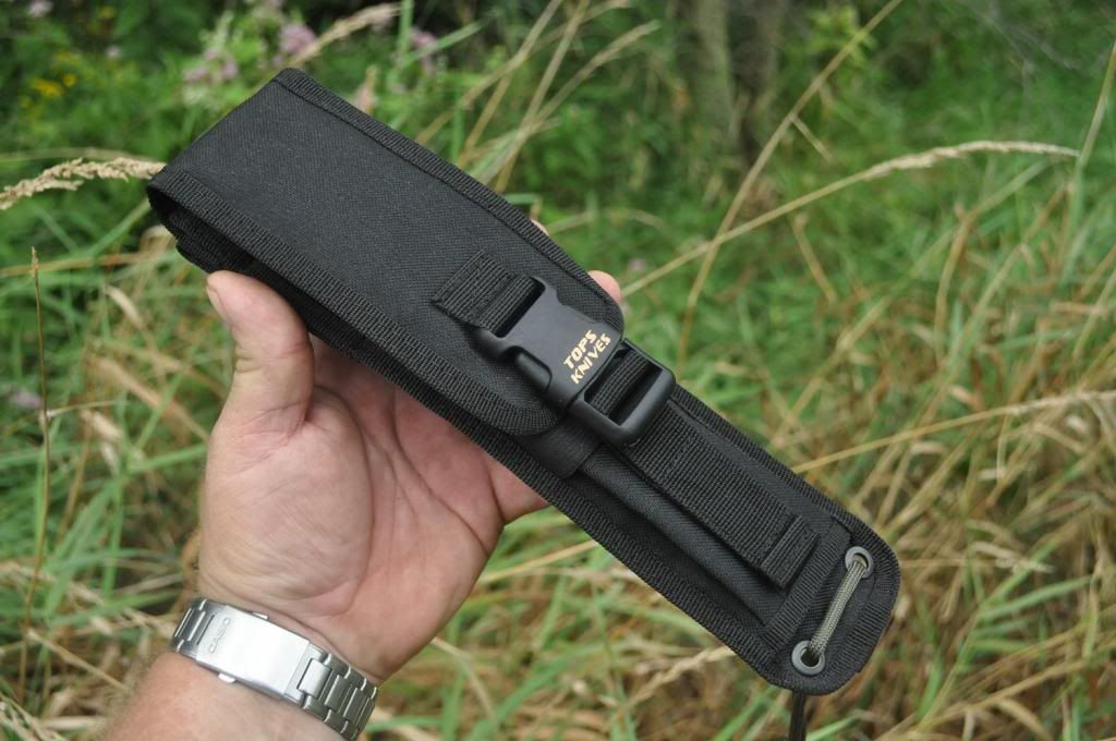

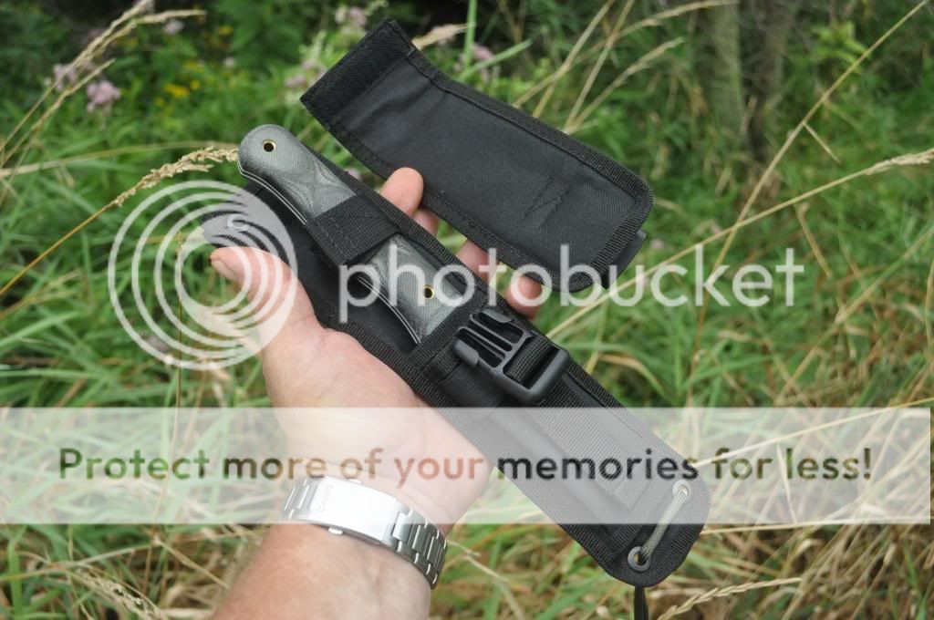

The sheath is one of the common designs by TOPS, a flap cover nylon sheath with hard liner. The flap is removable for a more traditional style sheath

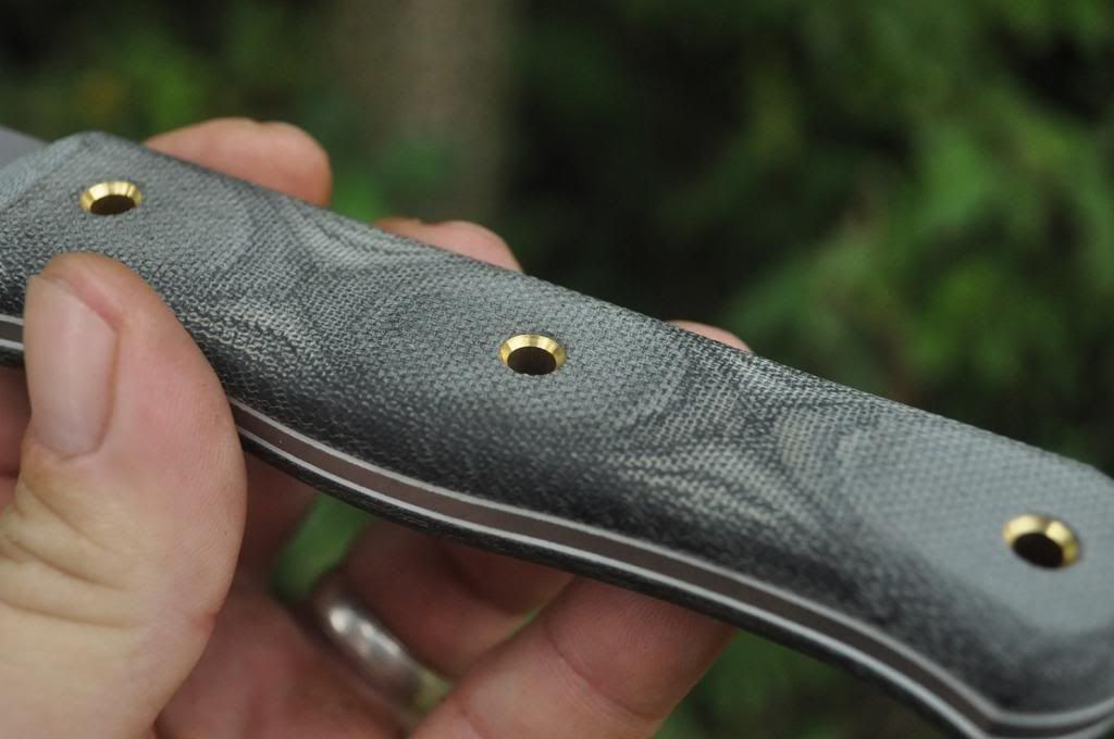

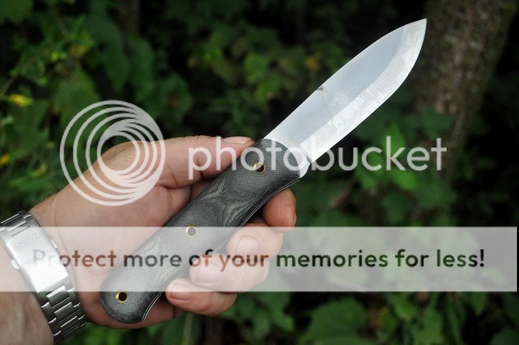

The fit and finish are the usual high quality.
It is a full size knife
It came with a nice sharp edge, nothing new there either.

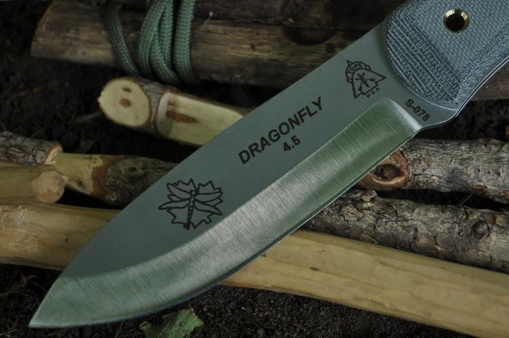

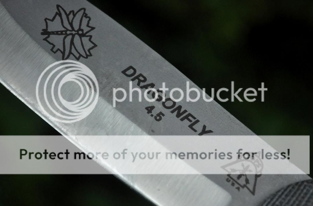

What you may notice as being new for TOPS, is the un-coated Hi-carbon 1095 steel blade.

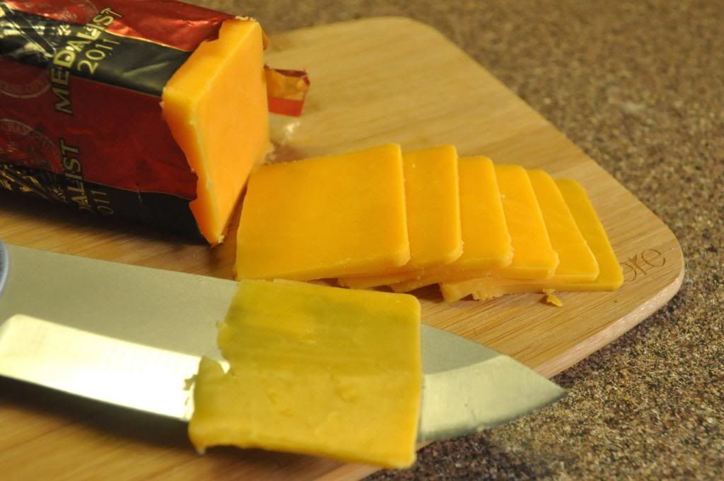

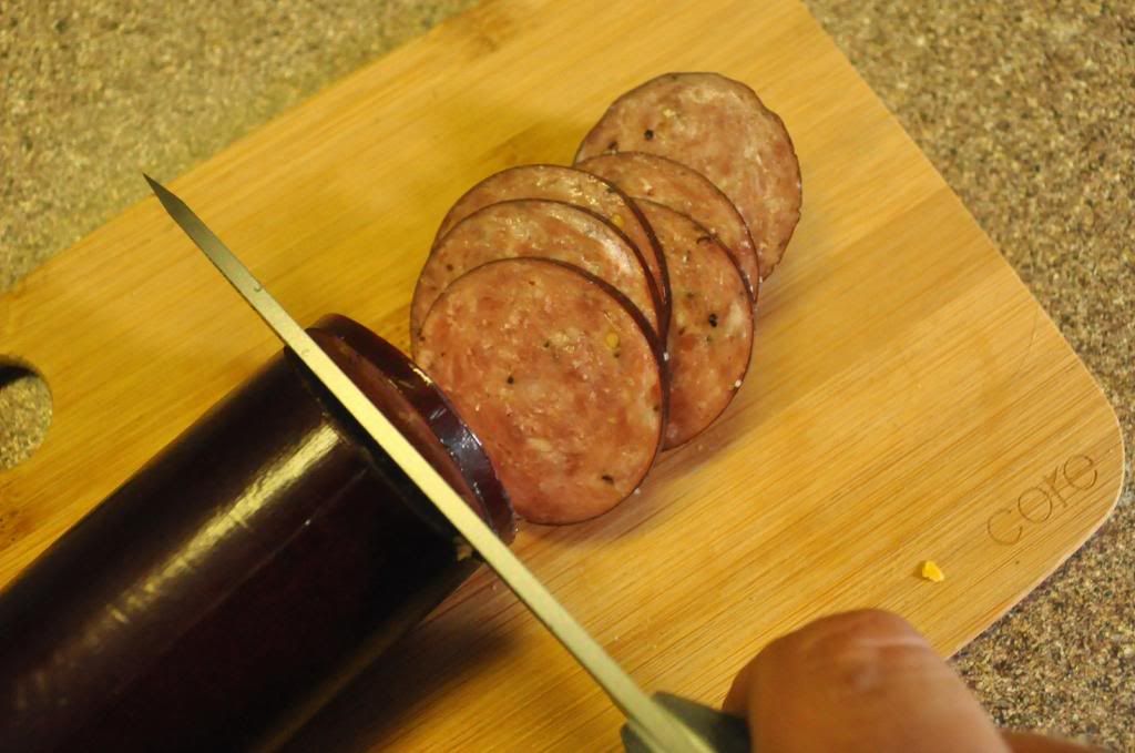

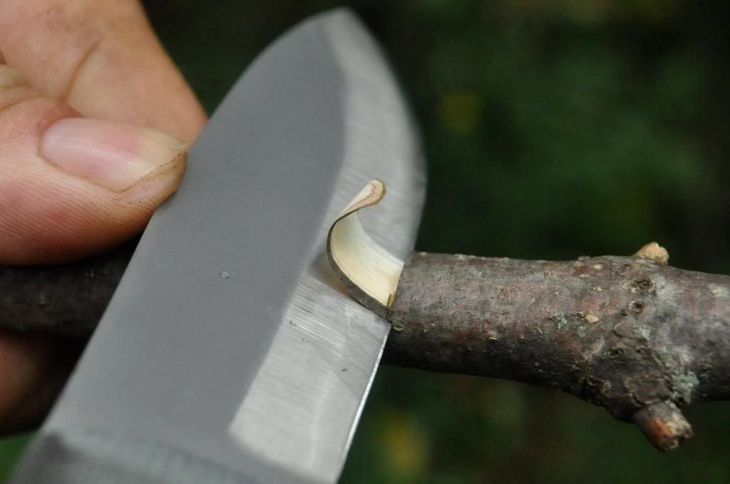

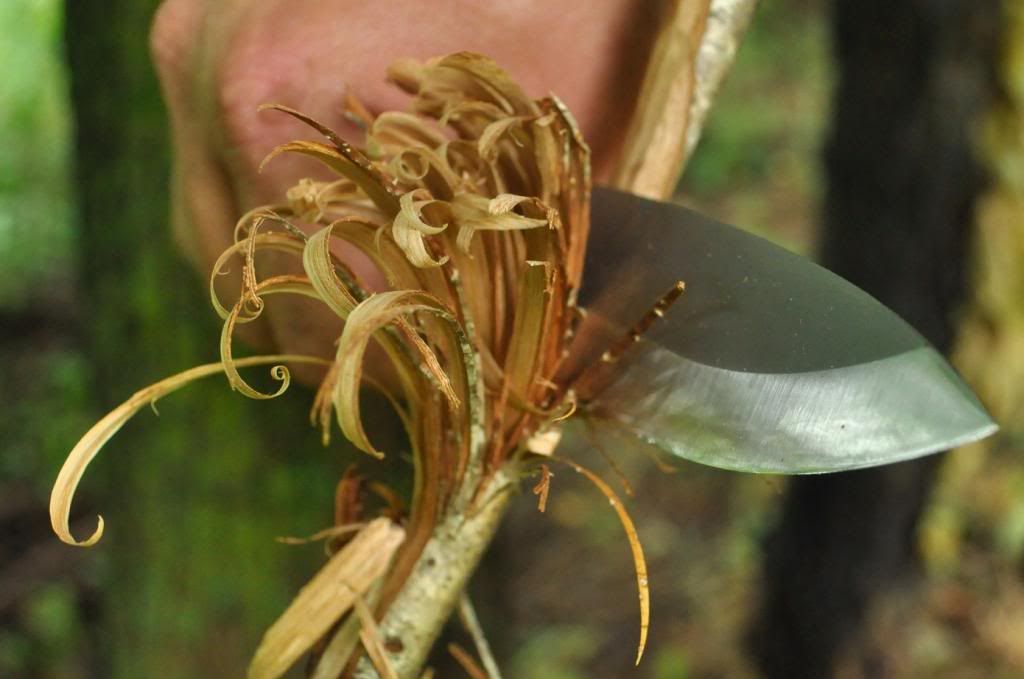

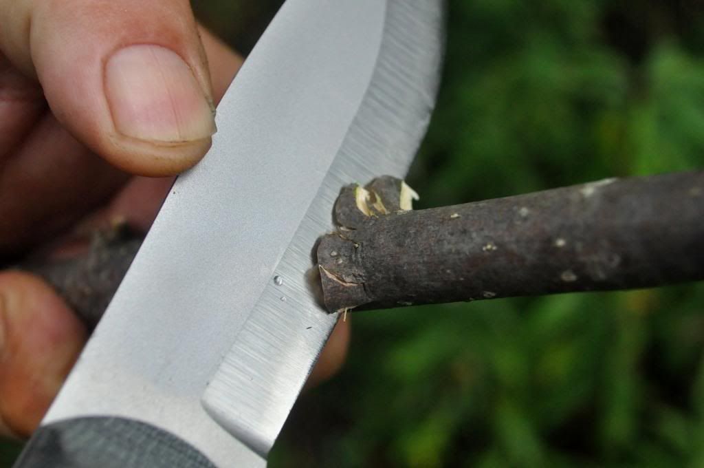

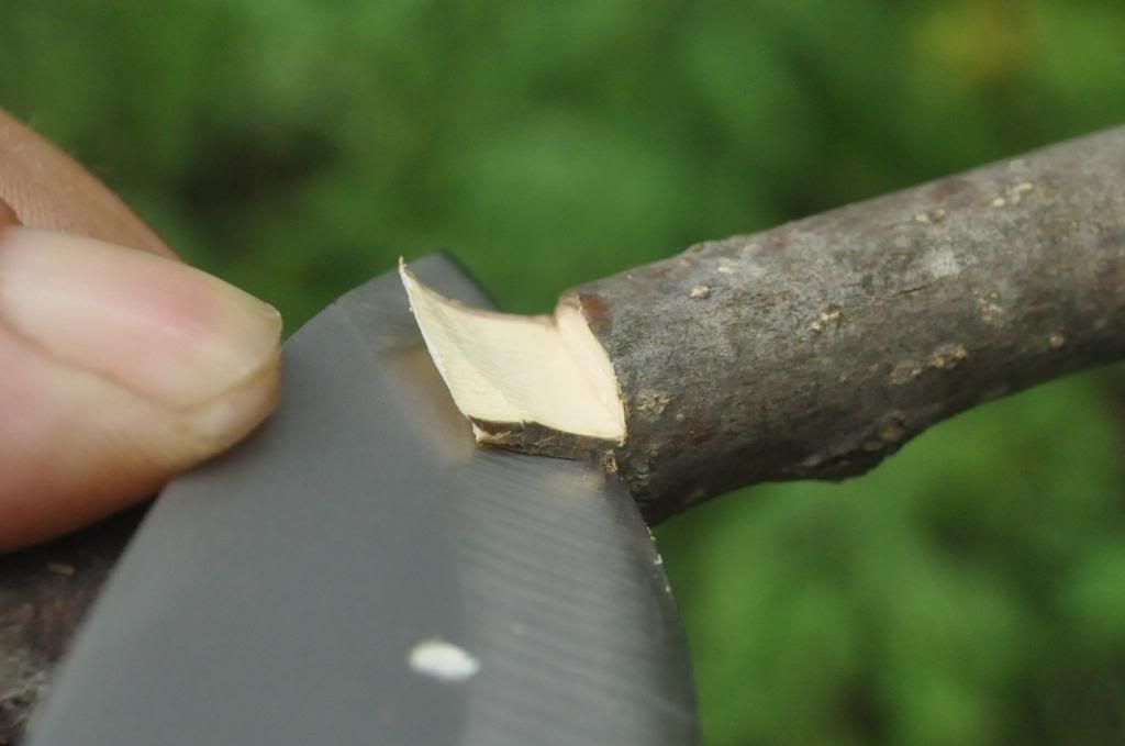

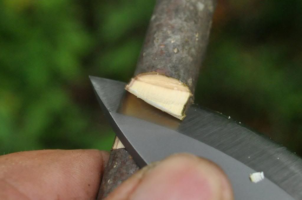

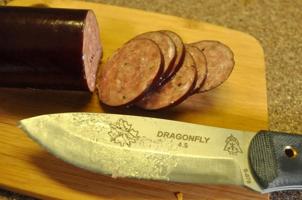

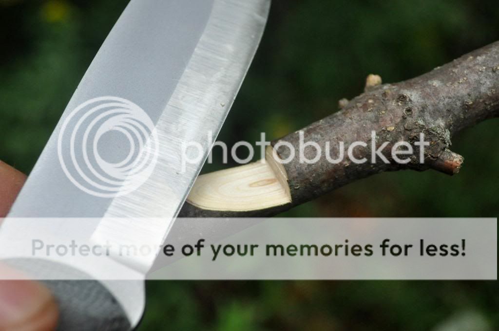

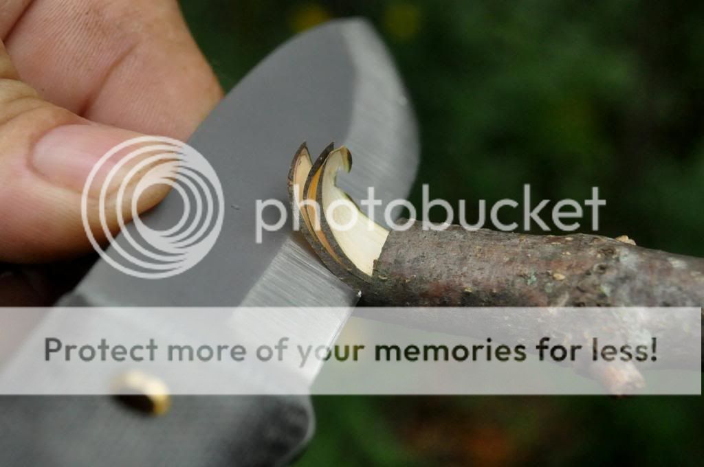

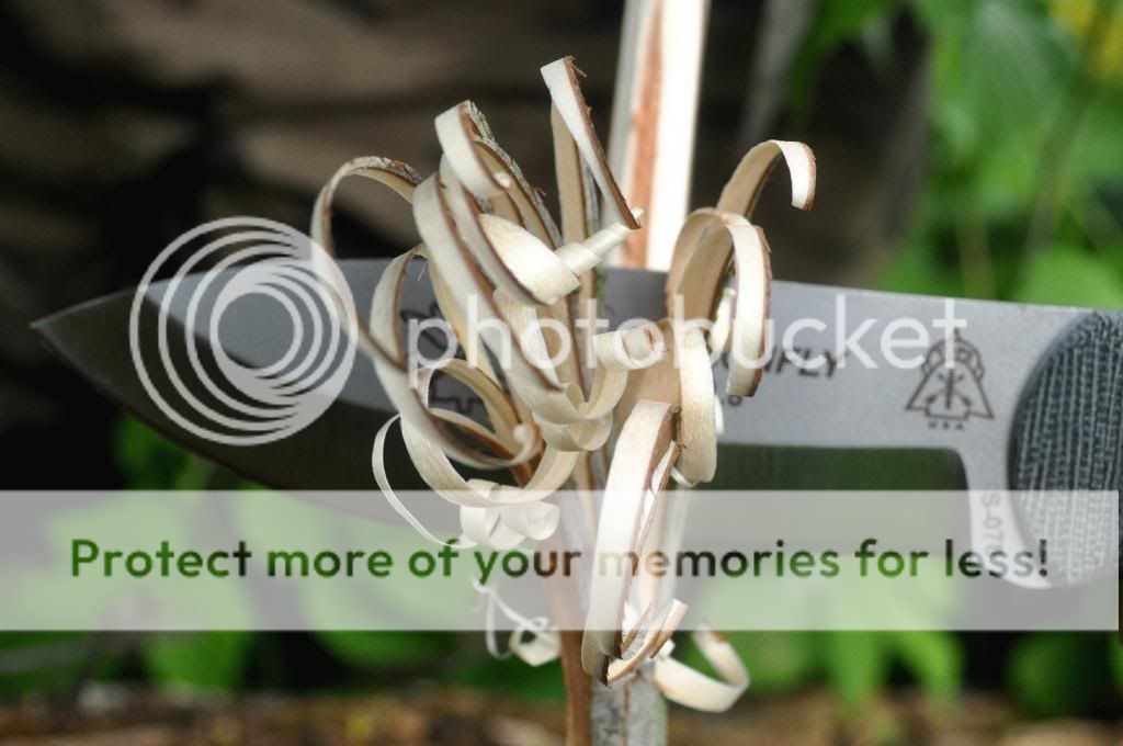

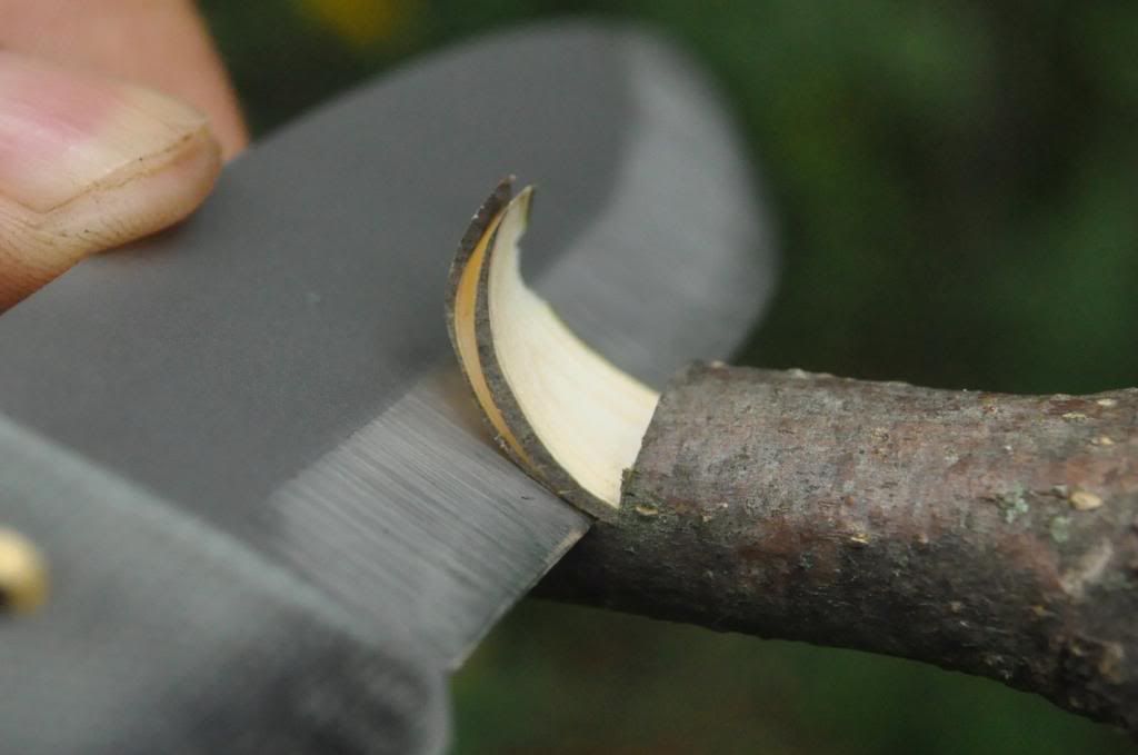

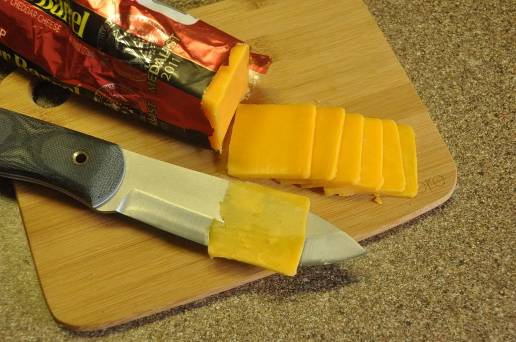

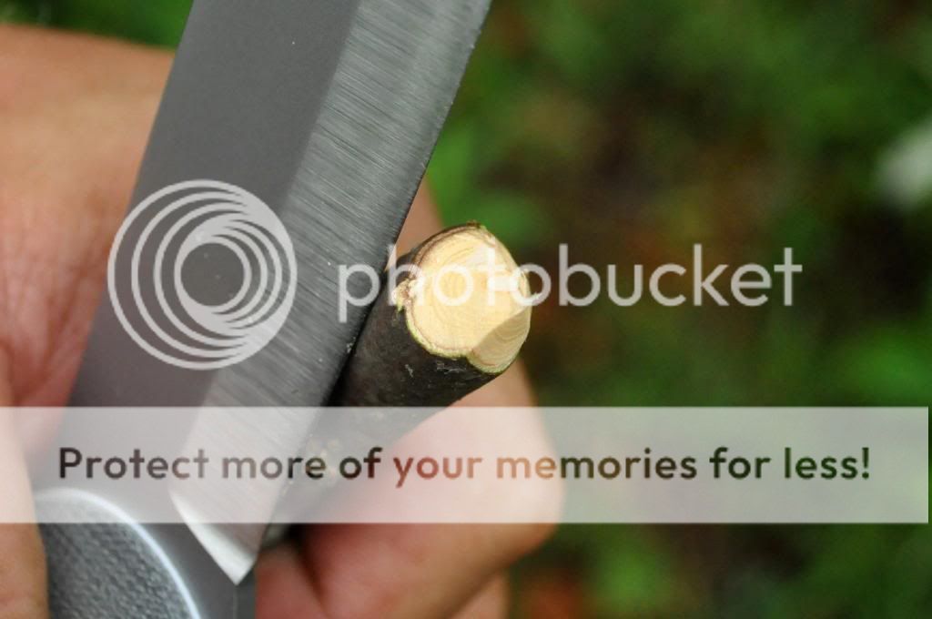

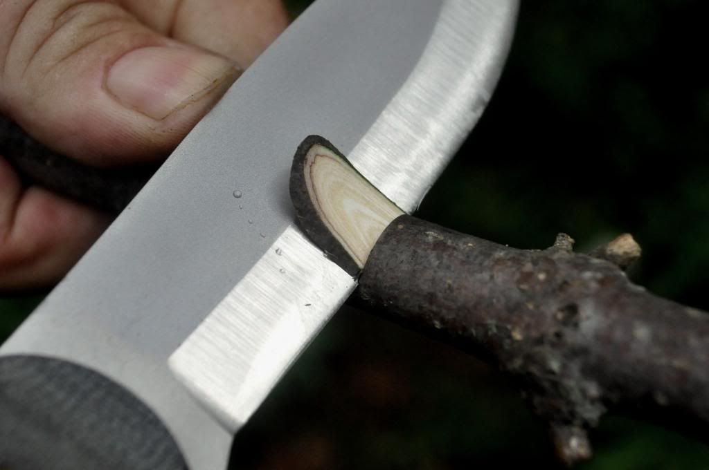

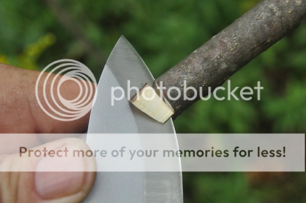

One thing I really like about it is the higher-than-normal scandi grind. One of my complaints with a lot of scandi grinds is that they don't work all that well with food prep and making thin slices. This hybrid grind doesn't have that issue and thin slices of cheese and summer sausage for snacks were easily done. I can slice cheddar cheese thin enough to see through.
All in all I think Caleb's design works very well. Definitely one of my favorite production bushcraft knives to date, especially in this price range.

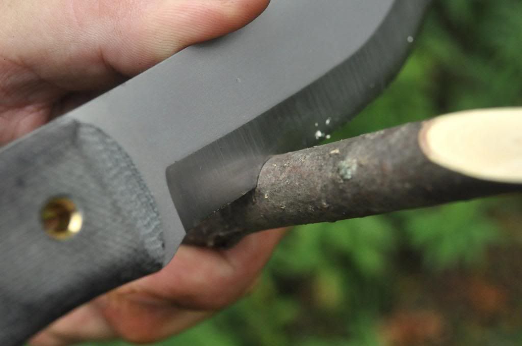

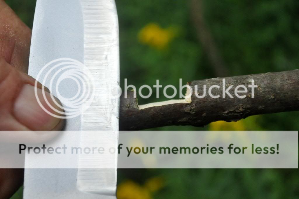

1. why are you calling it a "scandi" grind when it is ground on both sides. Looks more like a short saber grind to me.
2. Does the grind appear to be uneven on the left side of the blade or is that some kind of optional illusion caused by the shape?
3. Why would the put a bead blasted "finish" on a blade and them grind the bevels, leaving what appears to be a fairly coarse machine finish?
4. What is the street price for this knife?
Excellent pics of the knife at task. I wish more knife makers would offer their blades uncoated, when they do they always sell out. Excellent choice in cheddar !!
Looks impressive :thumbup:
Yep, not bad at all for a production "bushcraft" knife.
Couple of questions.
Actually I referred to it as a "higher-than-normal scandi grind, and a "hybrid grind". The height and secondary bevel make it technically not a true scandi grind. If to you the grind translates into a short saber grind, that works for me too. High scandi/short saber equals pretty well the same difference to me. Every scandi grind I have ever seen has been ground on both sides. To my knowledge single grinds are usually refer to as chisel grinds, or single bevels.
I thinks it's mostly illusion caused by the shape of the blade and angle of shot, the grind appears to be pretty well even from one side of the blade to the other, with some slight variation as is present in all grinds that are done by hand.
As for the bead blast/not bead blasted thing, for that you'll have to ask the guys at TOPS. It is one of the early pieces of a new design, picked up at the Blade Show, and the bevels are done by hand so maybe them just working out the grind.
Looking at the intro price on their website, I'd guess in the $120-ish range

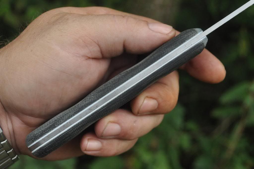

Other than the no-coating, I like the downward "thumb slope" design feature in the handle's front, transitioning to the blade. This seems to especially function well for a dedicated "wood(bush)craft" knife.

I did not say that it looked uneven from left to right, but that the grind looked uneven on the left side bevel. I was wondering how that could possible happen on a Berger CNC grinding machine. You answered my question. As for the scandi grind, my understanding is that such a grind is only on one side of the blade. This knife is ground on both sides, ergo a shallow saber grind. Correct me if I am wrong.

Yep, it feels pretty good in a pinch grip. The handle contours aren't heavily featured, but the handle is pretty comfortable in various holds, and has good control-ability.

And Joe, Scandi grind typically means that the grind has a Zero bevel grind, they are ground on both sides but that wide grind is the edge bevel, just really really big ;) so you do not have a secondary bevel that a lot of knives would have.
As they mentioned before a single side grind would be a chiseledged ground blade, although those don't always have a zero bevel, a chisel edge is one of the sharpest you'll find as there isn't any resistance on the other half of the blade, just the one bevel side so it cuts, push cuts especially, easier.
