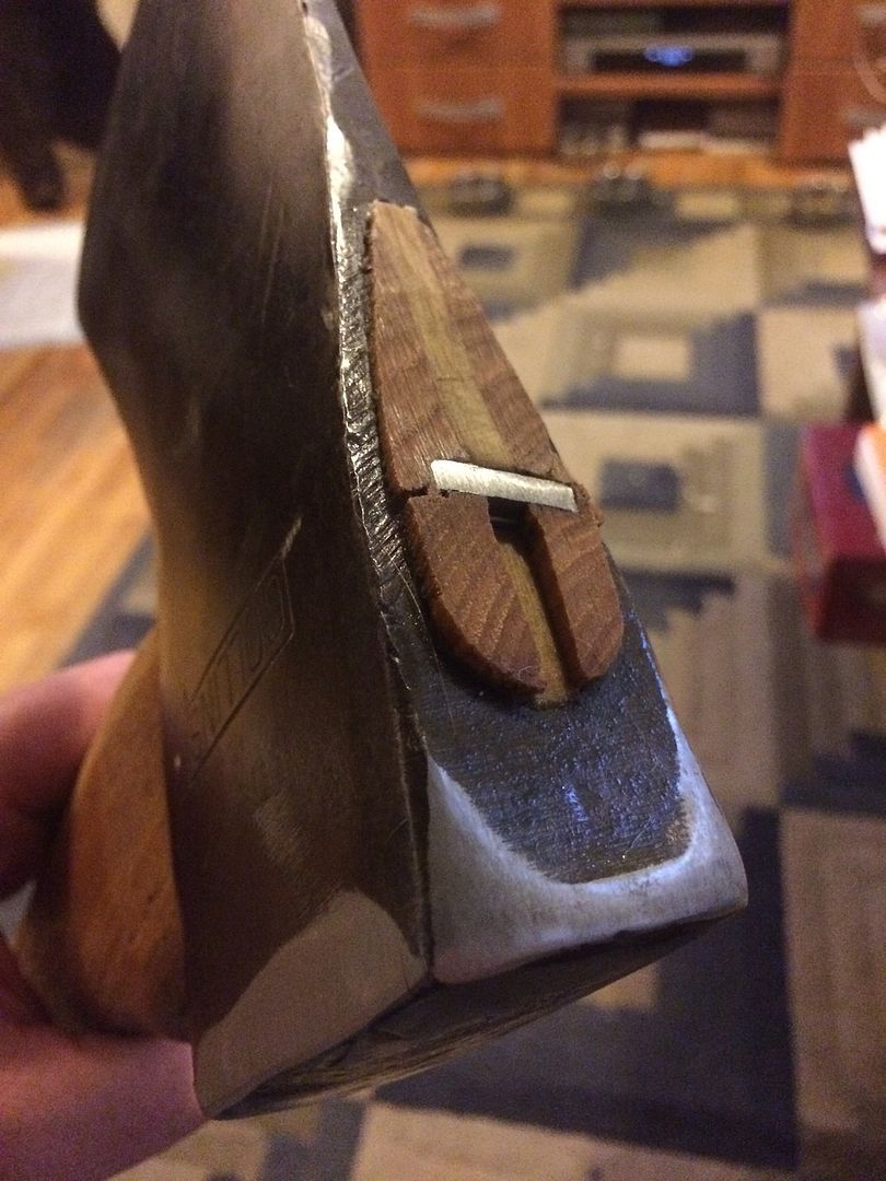

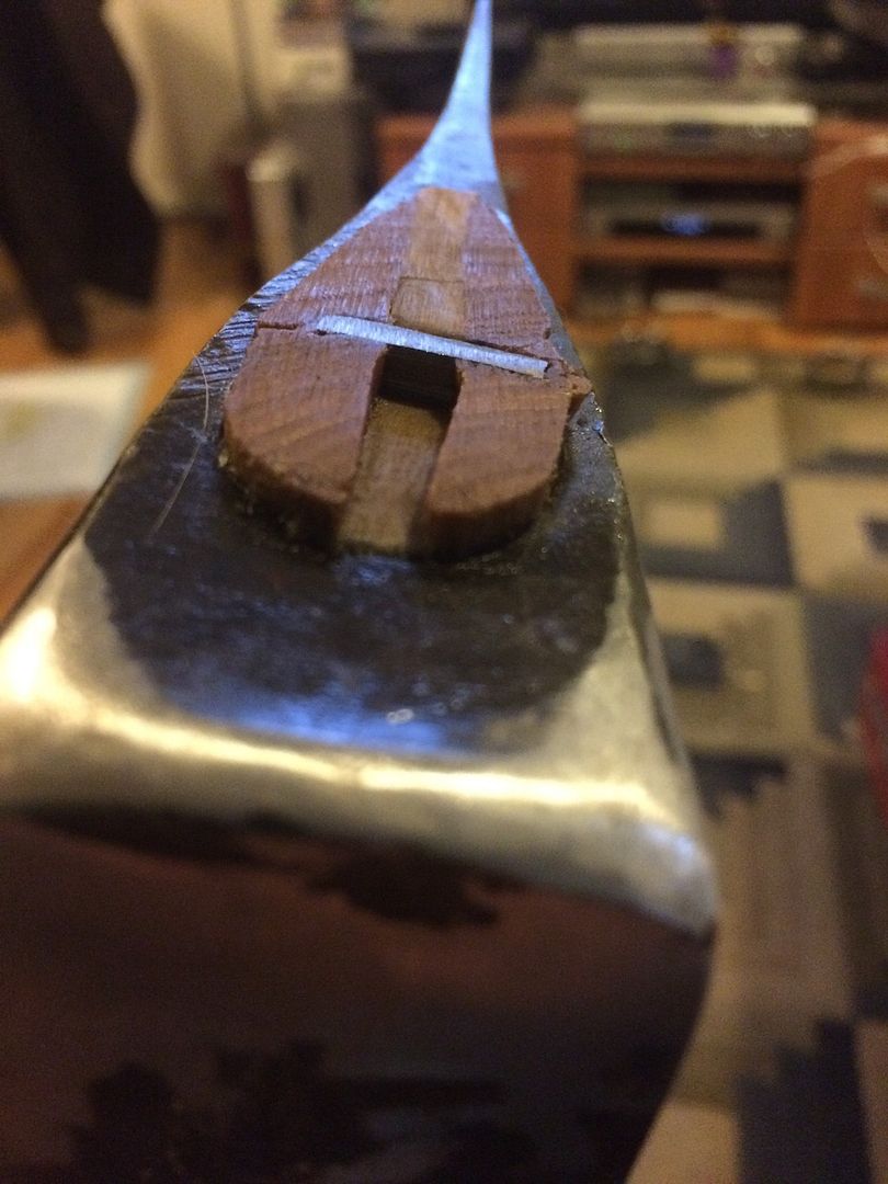

Hello,
I am new to axes and have very little experience with them, but recently my interests with knives kind of spilled over into the axe side of things.
I decided that due to the lack of options out there for new American made axes that I would find some old axe heads and put handles on them.
I found some axe heads and purchased them, but had very poor luck with the handles that were available locally, so I ponied up and bought a council velvicut handle for this particular axe. Everything went fine until I put the metal wedge In. The pictures should explain what happened. I am wondering if this is going to be a huge issue and If I should get a new handle and not chance anything going bad when I go to use this axe. Is there a fix? Am I worried about nothing?
I would also like to know what this pattern is called. I believe it is a "zeke" pattern, but am not certain. What is it best suited to be used for?
Thanks for any info
1. drill a hole on the exposed flat side of the metal wedge with a drillbit, you can also cut the protruding wood of the handle with a coping saw.
2. place a small wood block or scrap of wood near the back of the eye and inserrt the tip of a square screwdriver (solid one) into the drilled metal wedge to lever it out. pliers and visegrips might help, brute force will be required.
3. carefully drill out the wood wedge with a small drillbit, avoid touching the handle. use screwdriver to lever out wood fragment out of kerf.
4. once the head has been removed and the handle saved, lower the head onto the handle about an inch and resecure it with a fatter wood wedge, making sure it bottom out. Id suggest not using a metal wedge again unless you are certain the wood wedge is bottomed out against the bottom of the kerf. also next time you use a metal wedge, id suggest cutting the fibers diagonaly, alongside the growth rings, ive had less splitting this way.
good luck!
This is why many of us refrain from using metal wedges. Good wood wedging rarely needs a metal wedge added.
There's a chance that the crack will run down through the eye and weaken the haft. If that happens then replace the haft. But for now just forget about it and use it.

Remzy is correct, and he does excellent work. You can very likely save that handle. Definitely don't use a metal wedge. You have lots of room on the shoulder of the handle to refit. With a good wooden wedge in there that is nicely bottomed out, leave about 1/4 - 3/8 of an inch sticking out of the eye. When that has all been done, put the axe - head down - into a container with 1/2' of Boiled Linseed Oil and let it soak for about 48 hours. The portion of the haft that is sticking out of the eye will swell. This is better than a metal wedge. Good luck. REMEMBER - IF YOU USE BOILED LINSEED OIL WITH RAGS, BE SURE TO DISPOSE OF THE RAGS SAFELY. THEY CAN SPONTANEOUSLY COMBUST. I thoroughly rinse them out and then let them dry on the grill of my barbeque (not lit of course.)
