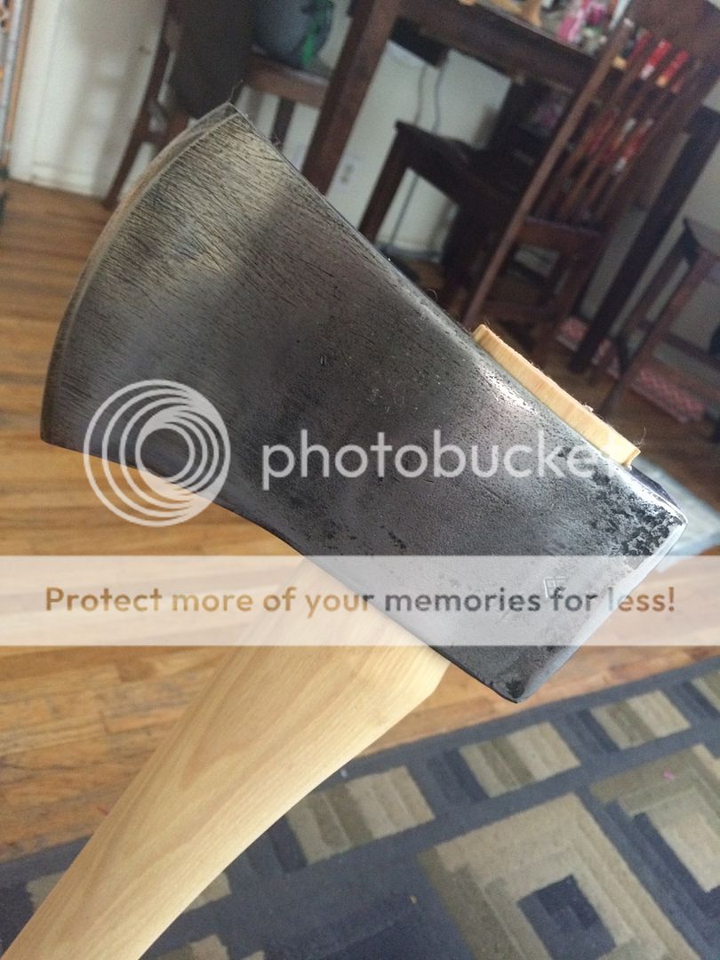

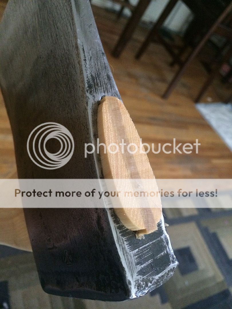

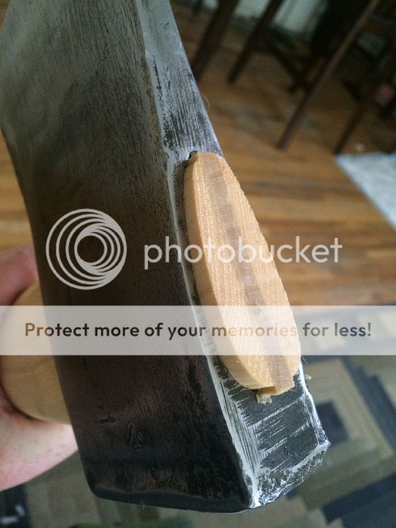

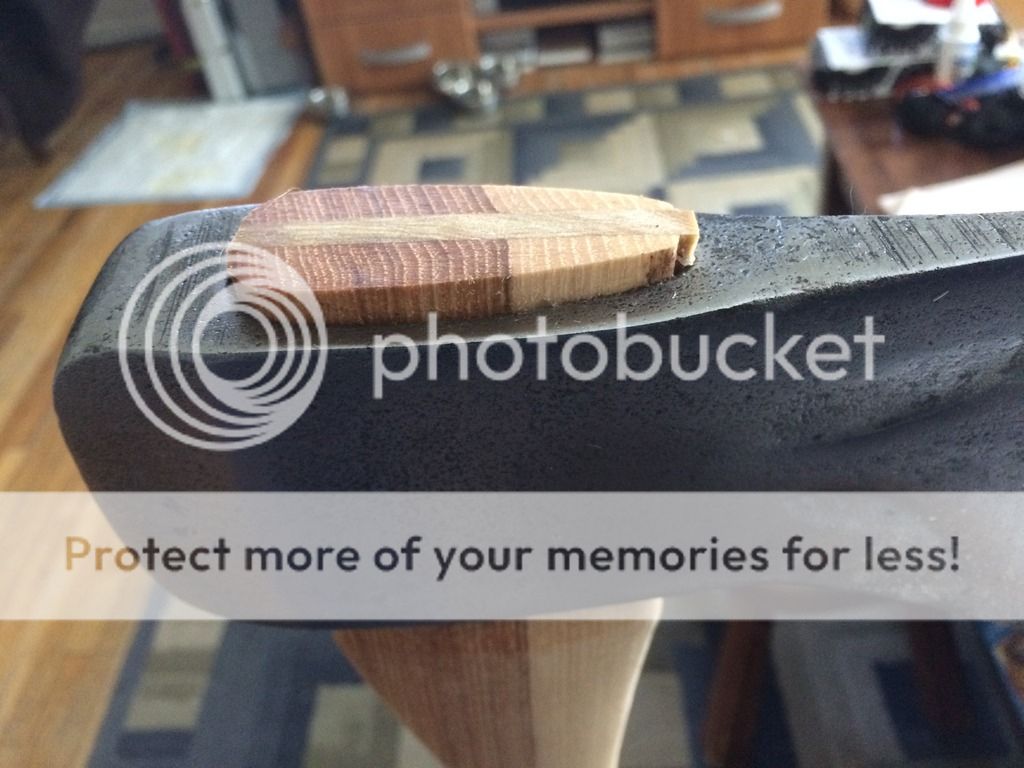

....Curt, what do you mean for the wedge to be "bottomed out"? Do you mean in the kerf? I would never bottom a wedge out due to the fact that if anything did come loose, you could not drive it in any further.
The main reason why you never want to bottom out a wedge is that nothing should ever stop the forward progress of the wedge except for the sides of the kerf. That's the only way you can assure that the kerf is filled tightly. Pre-fit wedges into the eye of the axe to verify that they won't be held up by the ends of the eye. Cut your kerf at least 2/3 of the way through the eye of the axe.
