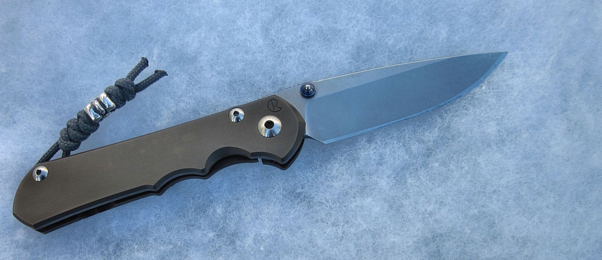

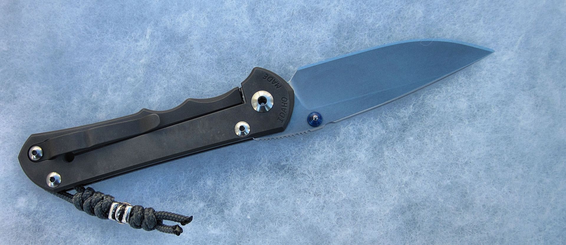

A little customization, care of Oxi Clean

I did this with a ZT 0550 scale a couple years ago and it was a uniform darker finish. It didn't have the patina'd look that yours does.
Ok this is just awesome. I really like the spotty finish on the inside of that top scale in your pics! That is so cool. I can't believe I missed this Oxi technique when I was researching Ti anodizing.
Ok, so how long does the Ti hold this Oxi finish? I have heat treated some heavy use Ti parts and noticed the colors seem to wear off, or I should say down after lots of handling.
Do you guys think this would work well with a smooth, non bead blasted Ti??

I think it is hard to tell at this point how long it is going to last or even if the coloring will be enhanced overtime just by handling it. Apparently, according to another custom maker of titanium knives, titanium can take on a slightly different coloration just due to exposure to oils in your hand through use over time. Mind you, I have no first-hand evidence of that one way or the other; its just what I heard. So far, I have not really noticed much if any change at all.
I don't know if it would make a difference though I think it could, but I believe the Sebenza titanium handles are sand blasted, not bead blasted. Also, BellaBlades posted above but he tried this process on some handles that he rubbed and found that the final finish was much more even but also more slippery. See post 18 above.
Finally, I want to add that a lot of people have commented that they do love that multi colored spotting on the inside of the handle. Unfortunately, that is the only spot on all four sides of two handles that did that and I'm not sure why that did it but it happened nowhere else. I felt I was very thorough in cleaning the handle before I did this in order to make sure that there would be some level of uniformity and how it turned out. Don't get me wrong because I still love the way it did turn out, but obviously there are no guarantees when you do this. Maybe it was something with the titanium that was unique to that area. I don't know. In my opinion, the worst thing that you could do is try it, not like it, sandblast the handles and then try again. No harm done in attempting to change the knife to make it your own. Best of luck.
I did the oxi treatment to my insingo tonight. I'm pleased with how it came out. It changed the scales just a shade darker. Even tone with some splotching on the inside of the handles.
