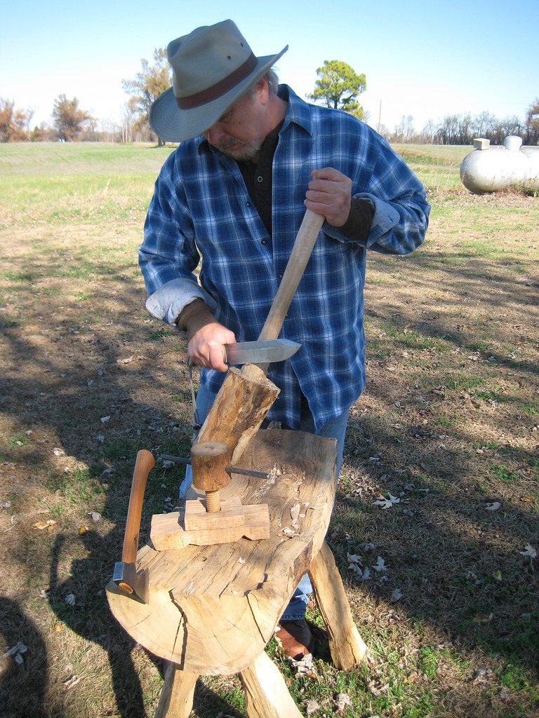

A little drawknife action with the BK9
Thanks for that Trade. Really enjoyed it. The 9 has enough blade to grab that it works well for that. Did you find the clip point at all in the way? Congrats on the new chopper... It's a beaut!
Not at all. I rounded it over with that in mind when I modded it. Thanks man.
nice shave horse!
I'm going to have to make me one of those once I get my shop done so I can get my tools out of storage.

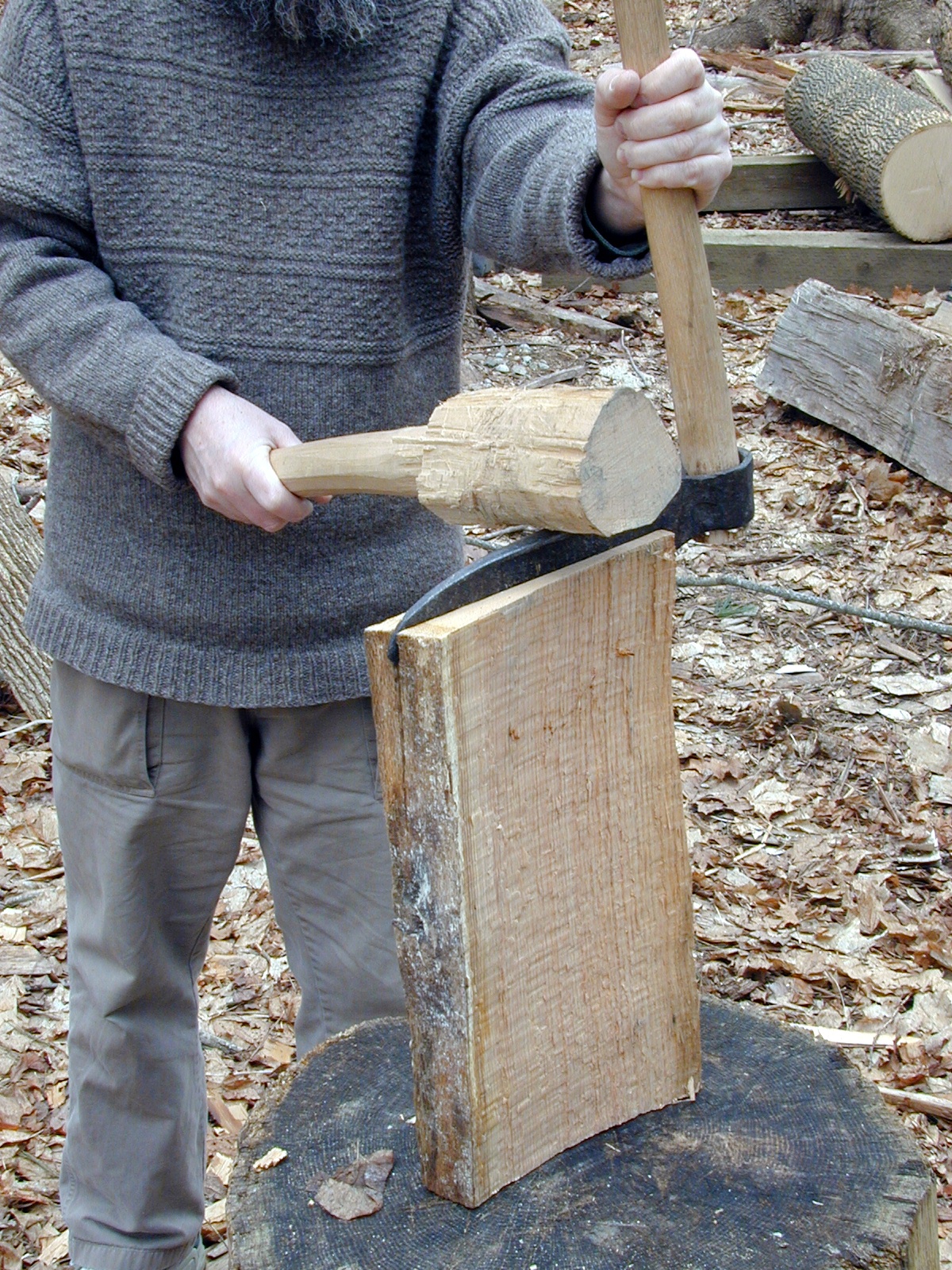

That' it right there !!! I knew I seen you somewhere before, your that guy from Silver Dollar City !!!! :)
Splitting shingles and all that, whew !!! man you guys know they make power tools nowadays :D

First off, that table is so damn cool and now I need to make me one. I'm taking down a really big pine within the next few months and I suspect it's going to find it's way into a lot of great outdoorsy furnishings. Also, I need a 9. Also, I need to be able to tap holes and thread wood stock. Toys; I needs them. Great photos Trade.

That's not me splitting shingles. It's a google grab. I haven't been that skinny since the seventh grade. :o
Trade, in all seriousness you've got quite the set-up there. I'm a Carpenter and for the life of me can't figure out what that is, although it looks very well built...

It's a shaving horse, Swiss cooper's pattern. A foot operated vise used to shape and finish all kinds of furniture, staves, etc.. It holds the piece so you can use both hands on a drawknife, spokeshave, or hollow auger. I used to make windsor chairs and all manner of stuff, and give demos and classes on traditional woodworking.
