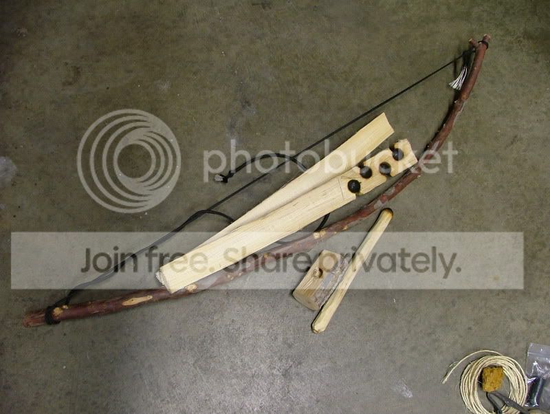

Well, I decided to take the 5 out and practice my fire starting skills today. I'd like to get good with a bow drill and flint and steel, so I chose the bow drill today! Here we go!
First, the bow drill:

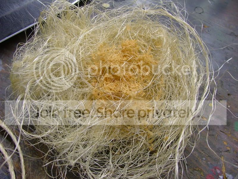

Second, my twine "nest"
Next, I added some pine dust from turning a pen on my lathe:

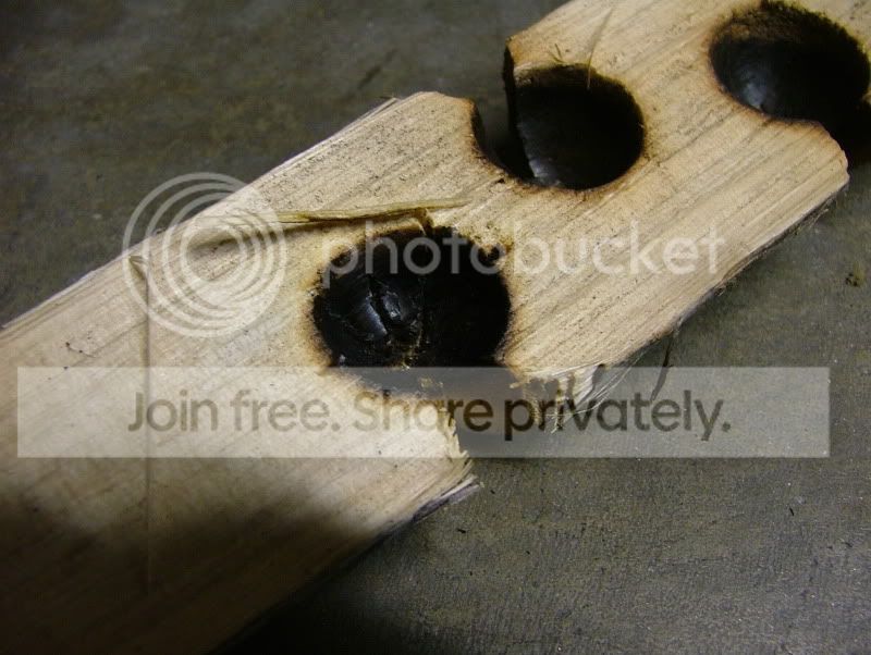

I was taught to "rough up" the hole to help make the coal a little faster:

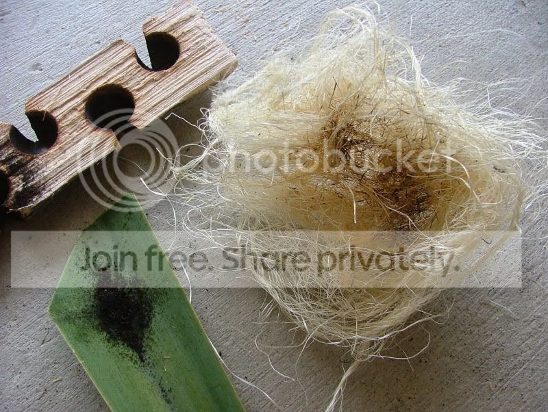

A little something to catch the coal with:
I couldn't take pictures of myself making the coal, so here's the evidence of my first failed attempt:

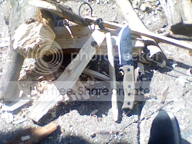

I tried two more times with no luck. So, I did what any self respecting person would do; I threw up my arms in frustration and got my trusty fire steel out:
That "custom" scraper is nice, huh?!

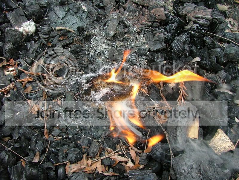

Well, feeling a little cocky with the fire steel in hand, I walked over to my little fire pit because I was so confident it would light. What do you know! One strike and we have fire!
Well, as you can see, I still need to practice a lot with the bow drill. I can get a coal no problem. My problem is making the coal ignite the nest. Does anyone have any recommendations?

Hard to tell from the pictures, but a couple suggestions:
1) Looks like you're glazing the hearth board - need more downward pressure. You can drop in a few grains of sand, give a couple spins, and de-glaze the hearth board. Scrape the glazing off your spindle with your knife.
2) Looks like your hand hold is getting a workout - use a touch of bar soap or even oil from your face to reduce the amount of friction
3) The spindle looks like it could be a bit too long - it may be hard to keep from oscillating with it that long - if it oscillates, that moves the "hot spot" around in the hearth board and lets the coal cool off enough that it never cherries up but just stays as black powder (which can still be used to ignite, just MUCH harder)
4) Have someone watch your body position - you want your weight directly over the spindle and lock your hand-hold wrist into your shin... you need excellent form to get it to work quickly
5) Relax - it's hard to start friction fire if you're tense
6) Keep practicing!
BTW - the tinder nest looks EXCELLENT

If your getting a glowing coal out of your work then your doing a good job. It sounds like your not blowing enough on the coal to get it to heat up even more which is what it takes to spark up your tinder bundle. You made a great tinder bundle, that wasn't the issue. When you get that coal get it into your bundle and start blowing, constantly! You'll start getting a lot of smoke and keep an eye on it for it to flash. That's one thing I've seen people do quite a bit is not get enough air to it to make it ignite. Try this and see if it helps you. Keep it up, it takes a lot of work!
