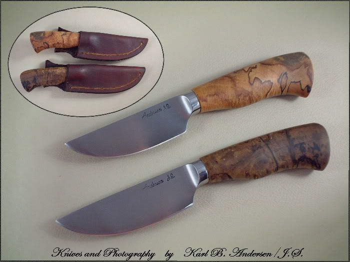

I'm having a little fun playing with 52100 round bar, and had recently been inspired to do some smaller integrals for easier carry.
These are a full through-tang construction and made in a fixed assembly all the way through with a threaded tang and finial construction.
For a through-tang, I simply don't know of a stronger construction method.
End-grain Spalted and Stabilized maple for handles.
I'll be taking these tomorrow to the 5th Annual Fox River Knife Rendezvous in Island Lake.
Thanks.

Kevin, on that small one, the cutting edge of the blade is about 3 3/8".
From the tip to where the handle material begins is 4".
Overall is 7 7/8".
