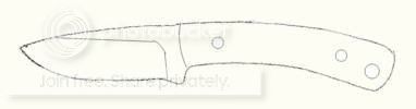

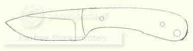

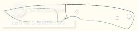

Ok yall, my bro and I are just about ready to make our first knives out of a saw blade. i was wondering what you think of the design we came up with.? do we need to do something to it, or leave it alone..?
the first is a hunter pattern: total length-7 1/4 in, blade-3 1/4
the second is a short skinner: total length 6 1/2 in, blade-2 1/2in
the third is a skinner, with a bit longer blade and simple handle: total length 7in, blade 2 3/4in.
we would really appreciate any input on the design, something that looks good, something that should be changed for some reason, etc... There is something i just do not like about the handles though, dont know what??? my bro likes the laynard hole, i would prefer something that looks more "rugged" i guess is the term.
Thank you

Those are great designs. I really like that top one. The only thing I would change is the pin at the rear of the handle looks a little off center.

I really like top and bottom designs. Nice work. Just my 5c worth: If you make your own design you will feel a greater sense of accomplishment when the knife is finished that if you just copy someone elses template. I think they look great. You can always tweak and make adjustments (some) while you are cutting out the blank. Good luck.
PS How did you put pictures in the post?
To me the second pin needs to move forward considerably on each picture. Measure the distance between the pin near the ricasso and the thong, cut in half, and mark your middle pin at that distance.

The designs look fine. Build them and see how they come out. Don't plan on being satisfied with the first few you make, hopefully, you won't be.
