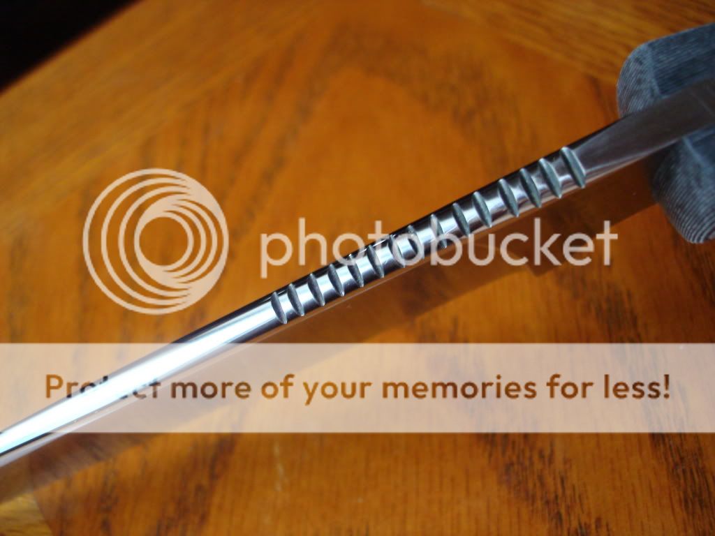

Just got a new Browning competition knife, pretty nice for the price IMHO. :) This is what it looks like fresh out of the box...
The knife has no guard which makes it easy to choke up on the blade when doing more intricate carving, so I thought it would be fun to try my hand at some jimmping. :) Pluss I've allways liked the look and feel of a nicely rounded spine, so I decided to give that a go too.
I don't have many tools but I finally broke down and bought a $30 bench vise, which made this process easier. :thumbup:
...So I filed out some jimmping with a medium sized triangle file, then I used some gun-blue to patina the insides of the jimmping.
Then I used a 12" flat file to start the rounding of the spine. I eyeballed it as best I could,
Then I used sandpaper starting at 60 grit, and working all the way up to 2000 to finish the rounding. And here is how it turned out...
A sharp eye can tell that it wasn't done by a CNC machine, but I think it turned out pretty nice for my first time. :D
Also the handles were horribly thick and blocky with sharp edges, so I sanded them way down, and put some soft curves in the scales to better fit my hands...
Nice work. I was playing with one of those the other day, and thinking that they would be even better if the handles were worked over a bit. The rounded spine and jimping are just icing on the cake. :D
cool work!!! looks great.
I'm a bladesports competitor in the netherlands and have used the browning on two occasions. For bladesports, it's really not a good knife, it's too light, especially on the 2x4. Hacking with the browning easily takes up more than twice the time it takes with a more modern competition knife which has more weight behind the edge near the tip (being almost flat over the whole blade)
Thanks for the compliments guys. :)
-zyhano, I see what you're saying. This knife is pretty light for its size, especially towards the tip. I'm OK with that though, since I just plan on using it as a fun camping/hiking knife to play with. :D
Again, to anyone who may be thinking about getting this knife, I would highly recomend getting some rough sandpaper and be prepaired to use it on the handle! That thing was both blocky and slippery to my taste. That's why I didn't go any higher than 60 grit paper. I left the scales a bit rough to add some extra grip without being too harsh on the hand. :thumbup:
I've used it a bit now, chopping some branches and vines, I'm pretty happy with its feel and performance so far. It's a fun knife. :thumbup: :thumbup:
That looks great, especially for your first go! I might have to do a little looking into that beast...
