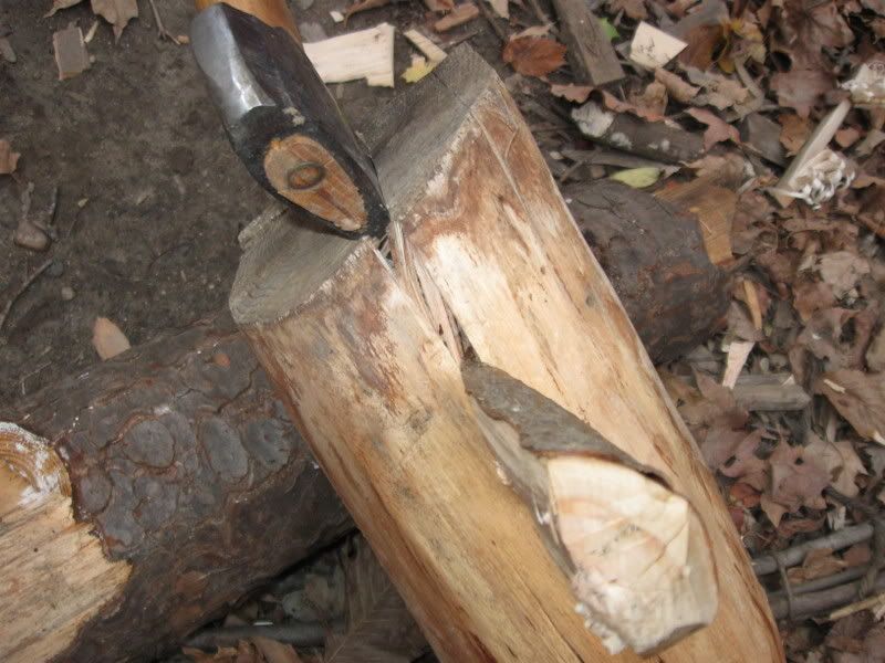

splitting large wood with a packable axe:

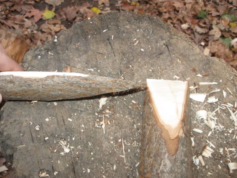

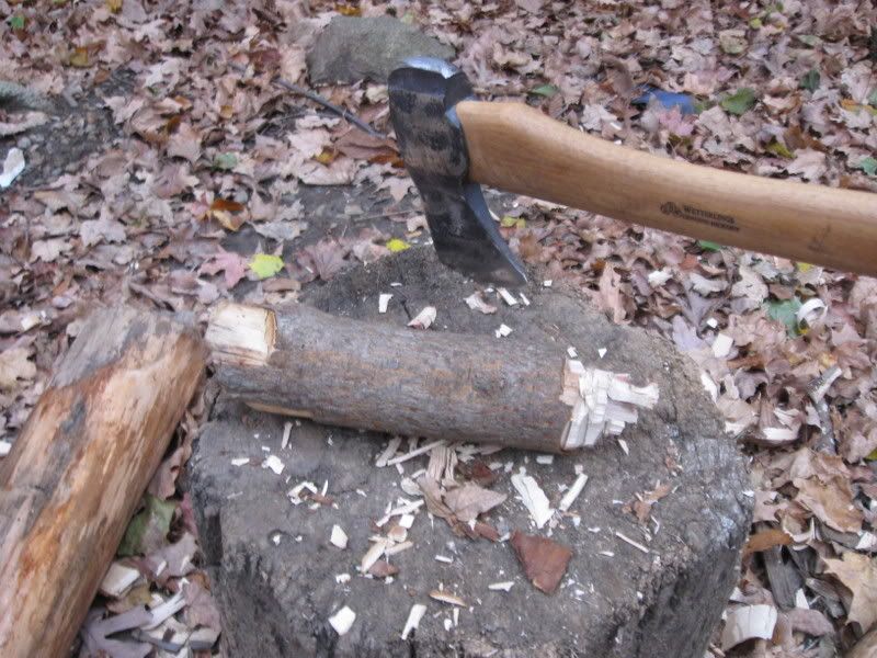

take a hardwood branch 2-3" in diameter, seasoned is best but green will work too. cut off a piece about 8-10 inches long. a saw makes this easier but for the sake of demonstration i stuck with the axe.
split the piece in the middle, i used a baton for precision.

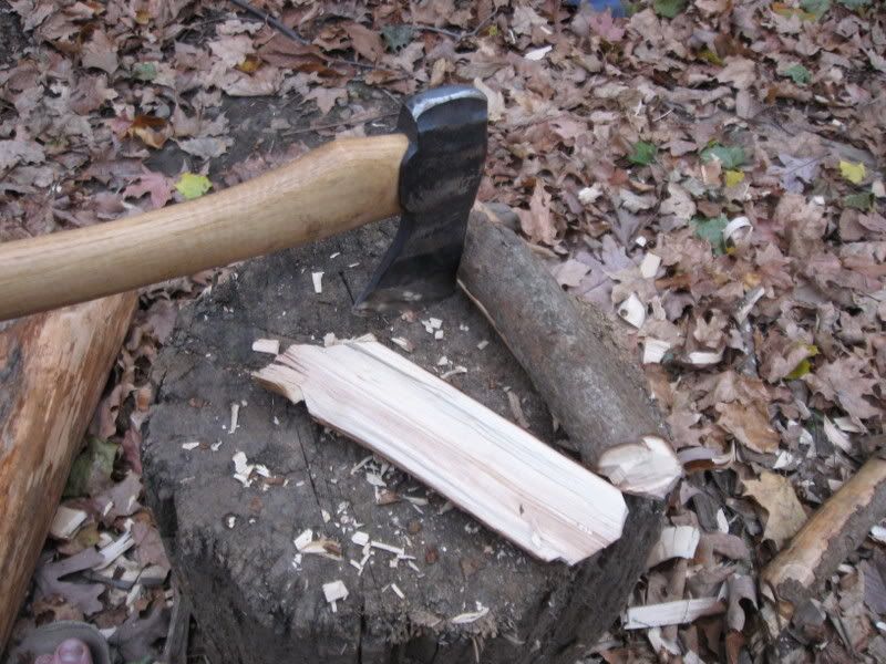

trim the ends even and shape the blocks into wedges with short chops. if you used a saw for step 1, straightening the ends isn't necessary. you want the front edges rather thin. this can be tricky with an axe, but if you lay the wedges down on the log and use short soft chops you can get a pretty good edge on them.

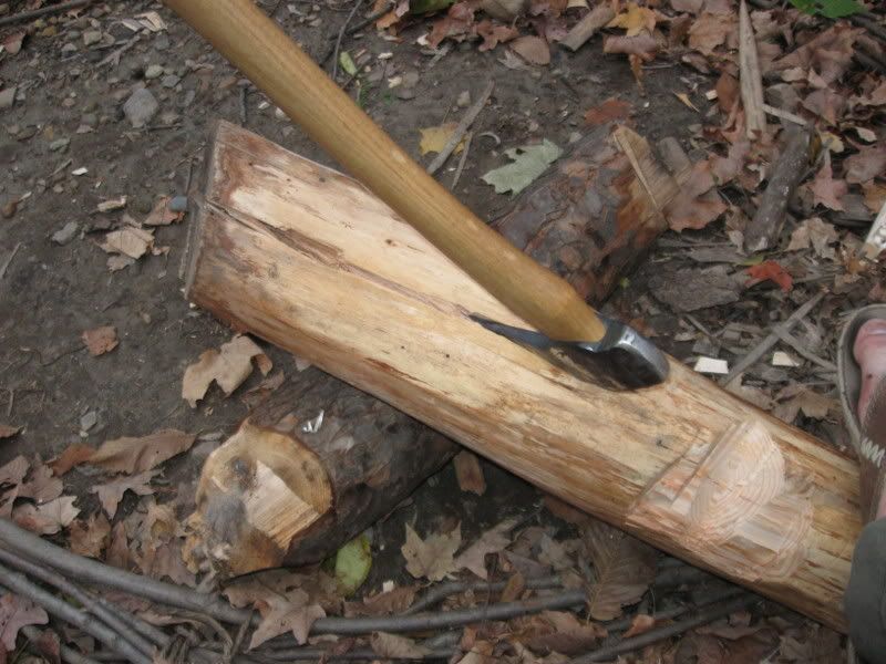

use a baton to drive the axe about 1/2" into the log across the end to create a score line. this will make the split open up more easily.

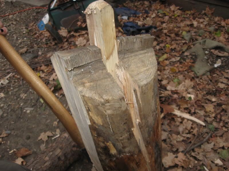

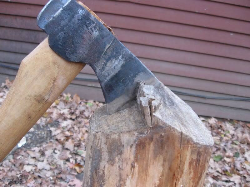

next, use a heavy baton to drive the axe into the end of the log deep to start the split.

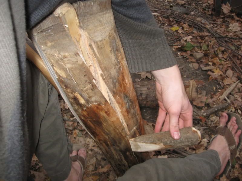

as the split starts to open either on the end or on the sides, drive in a wedge wherever you can fit it.
(continued)

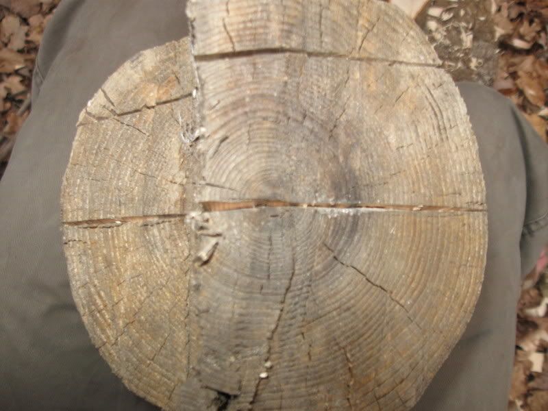

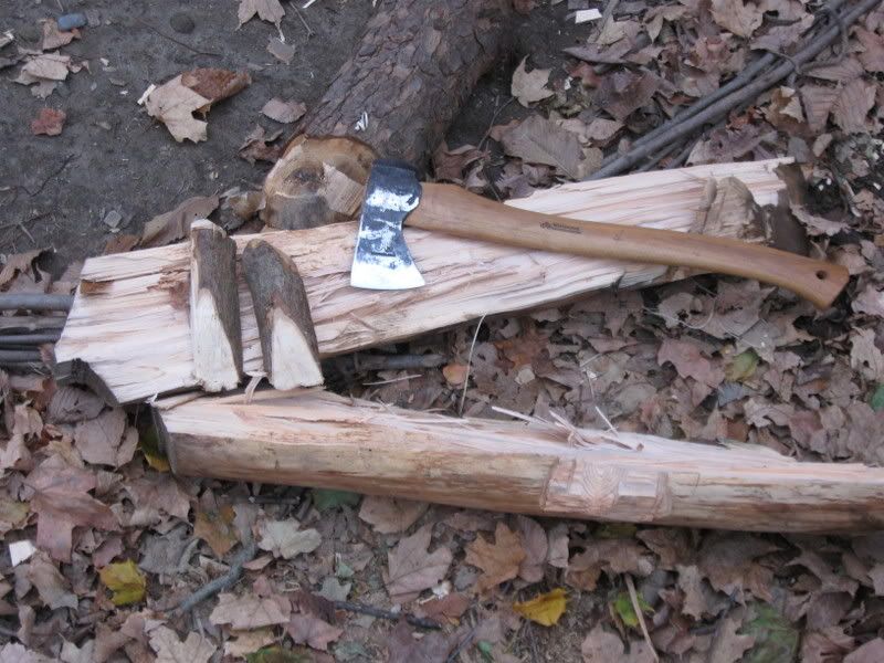

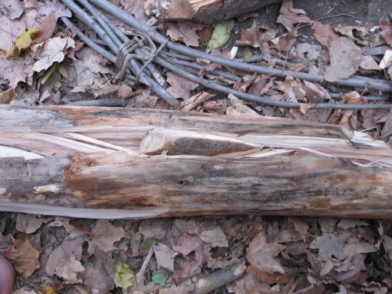

now work the other wedge so that you can free the axe. use the axe as another wedge to spread the split farther down the log. drive the wedges in, spreading the split and widening the split until the log falls apart. if you didn't use a natural split in the log, there will be alot of wood fibers across the split. i use my axe to cut these.
hope this helps someone. it was fun anyways, and this wood really hung together. i was tempted to grab my iron wedges, but i kept pounding and got it apart. ;)
