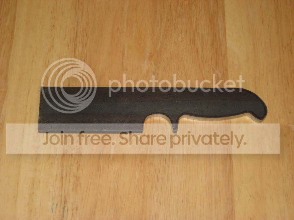

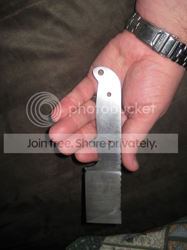

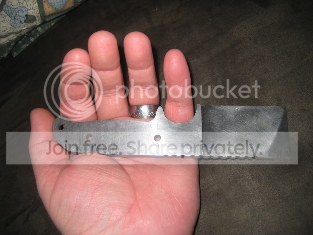

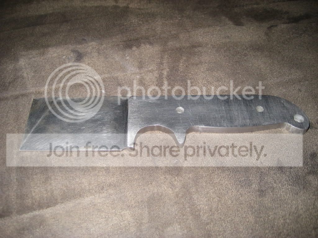

I have made a little progress on this. I still need to sand the blade to remove more scratches, and I think I will remove a bit more material from the handle to thin it out some more. It is still rough. I have started the light green G-11 handles, but will wait till I have the handle how I want it.
I did some rough file work on it, next time I will plan the pattern better, and maybe get some small needle files to make it easier. They I was going to do an alternating pattern, and originally did not have the filing marks meet in middle, but had to fix some. The only power tool I have is a crappy hand drill. Next time I will use a guide for the plunge line, and a round file to do it. I only spend a little time here and there, so progress is slow.

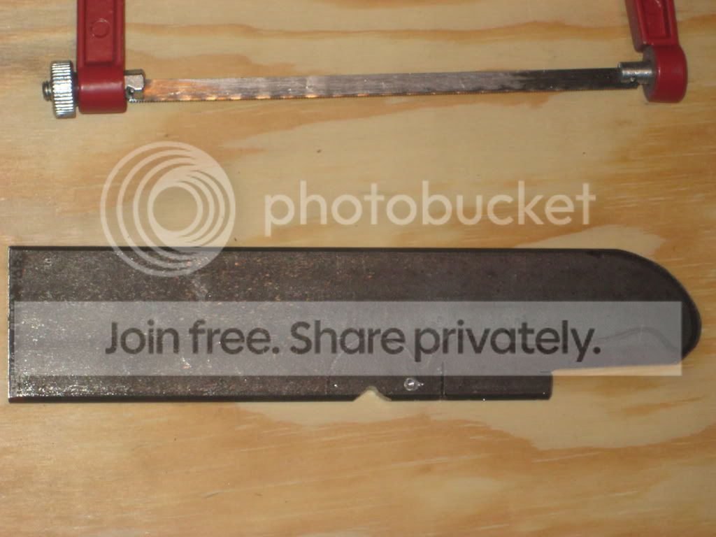

Here it was cutting it out.

You are in Washington? Where? Come by here on the next one and use my bandsaw.
I am in Spokane. Originally from Moses Lake. I would love to come to your shop some time and learn a few things. I have a larger one that I started in Utah, but will likely finish this small one first.

the steel is 5160 1/4 inch that I managed to talk JT out of. I have enough to make more knives when I get these ones finished. hopefully the next one will have fewer mistakes to fix.
after I got some better bits they drilled just fine. The hard part is not making the holes look like ovals. And I did snap the tip off of one of the smaller bits

I could not drill this stuff to save my life, and that's after getting Cobalt bits, cutting oil, annealing the blank again, etc. I finally managed two 1/8" pin ovals after lots of time and cussing.
My standard bits would not cut at all, I think I got some titanium coated that were rated for drilling metal. They worked fine. A drill press would be nice.
