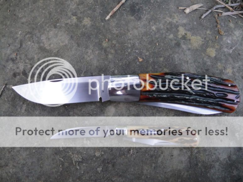

Nasty, that Ray Cover is off the hook! It's like lookin' into a fire-- I can almost smell the smoke!
