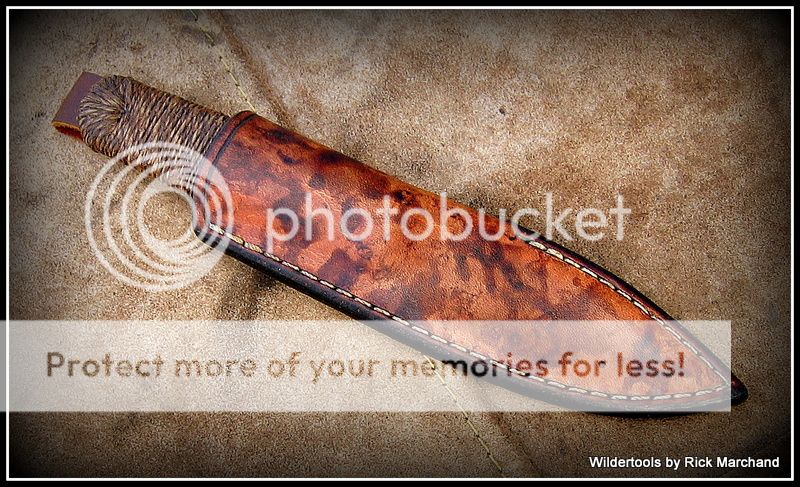

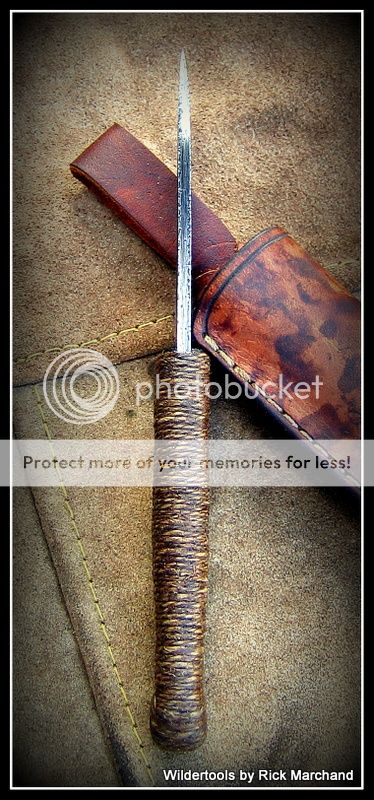

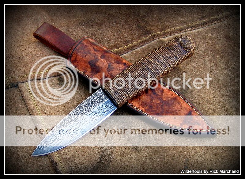

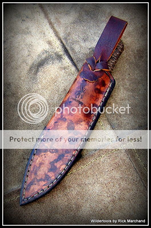

Hey folks,
My niece has been accepted into a ranger program here in Ontario. She will have 2-3 yrs of schooling with a lot of fieldwork ahead of her. One of her suggested personal wares was a small fixed blade. I couldn't bear the thought of her buying a Wally World special, so I quick wipped up a small user for her. I don't have pics of the one I gifted her but here is its twin that ships out to a customer, come Monday.
Snub Lore
1095
1/8" thick
6 3/4" OA length
3 1/4" blade
3 1/2" handle
Tapered tang
Handle is leather backed, hemp wrapped, epoxy soaked
Hand stitched sheath, wax dipped.
Thanks for looking.:thumbup:
she won't be able to help but make good use of that little unit. A fine shiv indeed.
dang, can I trade one of my uncles for you?
That's a great bushcrafter there! Your niece will have the best blades in her entire class I'm sure. Good luck to her.
Red
To me this is the same as driving with no seat belt. Hopefully she wont need it.

It's all about perspective. I might look at guards like never taking the training wheels off your bike.:)
It is odd for some... but tell that to a culture like the Saami who rely on working blades for everyday life. Few of them have guards.

Many folks prefer a knife without a guard. It is just another option.
They have obviously never had their hands slip up on the blade and give them a nasty gash now, have they?
Nice looking blade regardless.
