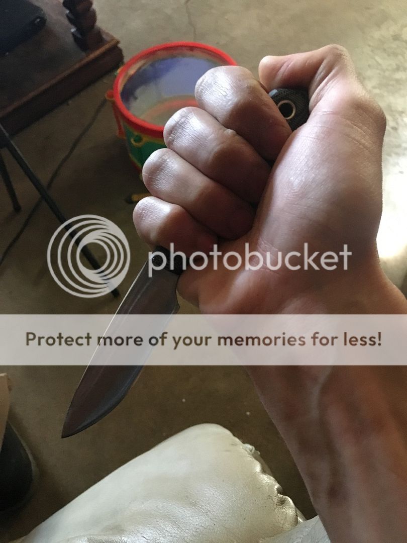

Great Job! Is it comfortable in all grips? Including Reverse Grip Edge In?
Yes it fits my hand particularly well, (wonder why?) and in pretty much and grip my fingers just fold over it like sheets on a bed. Wierd analogy lol.
