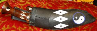

Pic 1: A shot of the throat of the YCS sheath, reworked. Note the rattlesnake skin at the throat, and further in, you can see the black kydex liner. The tool keepers are detailed in pic 4. Also note the diamond and yin/yang pattern on the face of this scabbard. This scabbard is made for lefties, like me.

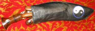

Pic 2>: A pic of the back of the YCS scabbard rework. Frog removed to show the way the tools line up under the leather.
Note that the two kardas fit in spine-to spine, as opposed to the normal alignment. The Awl fits nicely between the kardas, so I decided it didn't need its own sheath. Pic 4 shows what this tool keeper section looks like before adding strapping tape and final leather cover.

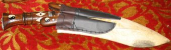

Pic 4: This pic shows the basic construction i did for the tool keeper section of the YCS sheath. Each karda gets it own mini-sheath of kydex with a leather collar sewn on. First sew the leather to the flat kydex, then bend it around the blade for sizing and do the long edge sewing. I then sewed the collars of the sheaths together, and the awl fits snugly between and under the karda sheaths. Then take strapping tape or duct tape, tape it in place on the wood scabbard forms, and sew on your outer leather. See Pic 8 for wider view.
Pic 5: This pic shows a few of the elements of the scabbard. The top wood form is showing the inside of the sheath, in which I noted some cardboard glued into the sheath. The bottom woood form is the outside, and you can see the indentations from the sarki's tooling of the old leather. That became the back of my lefty sheath. The black thingy on the right is one of the kydex scabbard liners, with a leather throat tab attached. I dropped that off in favor of rattlesnake skin, tho. The kydex is attached by nylon thread to the throat of the scabbard, under the snakeskin.

Pic 7: A front pic of the finished custom YCS sheath. Note the nylon thread on the frog, as opposed to the lacing. I did this because the redesigned sheath was too small to use the original frog, so I essentially "took in" the waistband of the frog to fit again. Proof that the redesign lowered the profile of the sheath! Note that I matched the diamond&yin/yang pattern on the handle in acrylics on the sheath. That old leather sucked the paint right up.
Pic 8: A wider view of elements in Pic 4. You can see the spine to spine karda mini-sheaths, and how they will align on the scabbard. After laying these out, I just warpped the whole sheath in strpping tape to check the fit, then did the leather over that. Strapping tape is excellent stuff for this. Even if the adhesive fails, you've got fibers wound all around the scabbard, much like Filipino scabbards.
