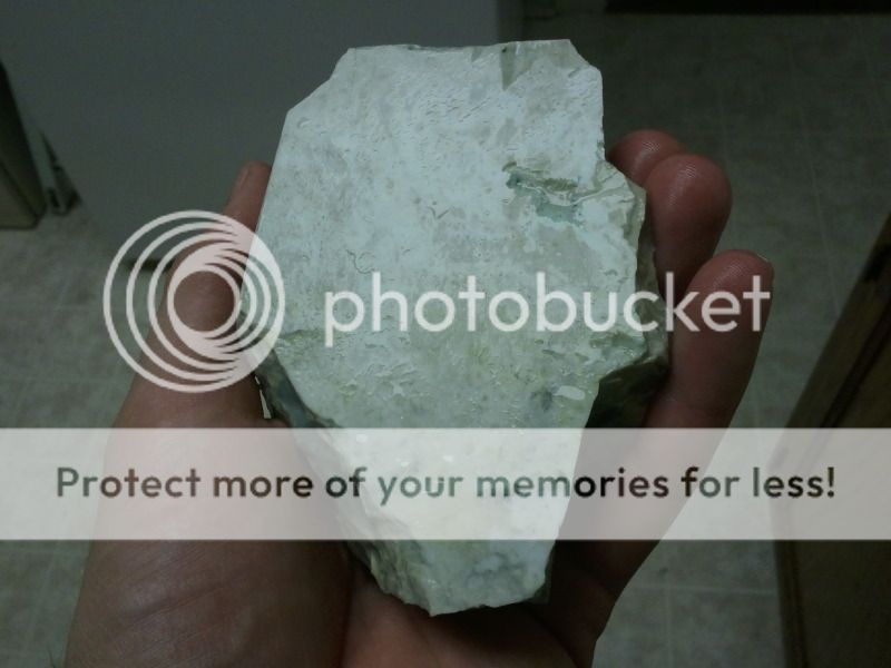

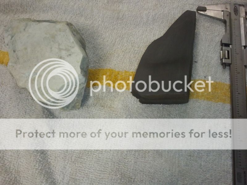

So I have been hell bent to try and source some stone locally that can serve as a sharpening stone. I have collected a few pieces over the last month or so of rockhounding twice a week. I am not a geologist, so all I can conclusively tell you is that they are indeed rocks.

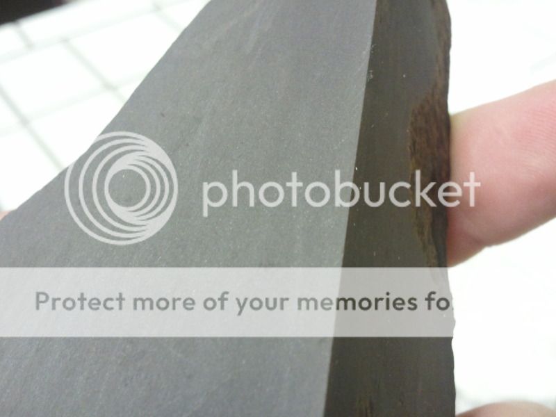

First one is hard, very very hard! It chipped out my Estwing rock hammer severely and took almost 7 hours of hand lapping with a 220# diamond stone to get a reasonably flat surface. It has a soapy feel to it, hard as can be, slow stone.

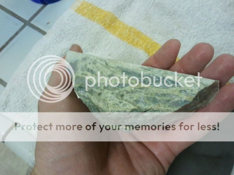

The next one is a very fine stone, it feels like an 8K stone at first but building a slurry it quikckly slows down and works like a 12k+ stone. It needs a 30 minute soak seems like. It cracked across the face once I started lapping it, so I won't be able to hone razors on it, but knives are no problem. It is slower that the other stone, but softer and leaves a finer polish with self slurry.
I was unaware of how I should use these stones, at worst they will end up in the fish tank! I did some experimenting with various steels, kitchen knives, pocket knives, plane blades, hard steels to soft steel. these two rocks didn't gouge like the others I tried, the grit seemed fine enough and uniform enough to work, so I pretty much just went with the flow. I am not a very good freehand knife sharpener, but I can normally get a very sharp edge on all my knives, and edge bevels are pretty consistant, but not perfect. so this was good motivation to learn freehand sharpening.

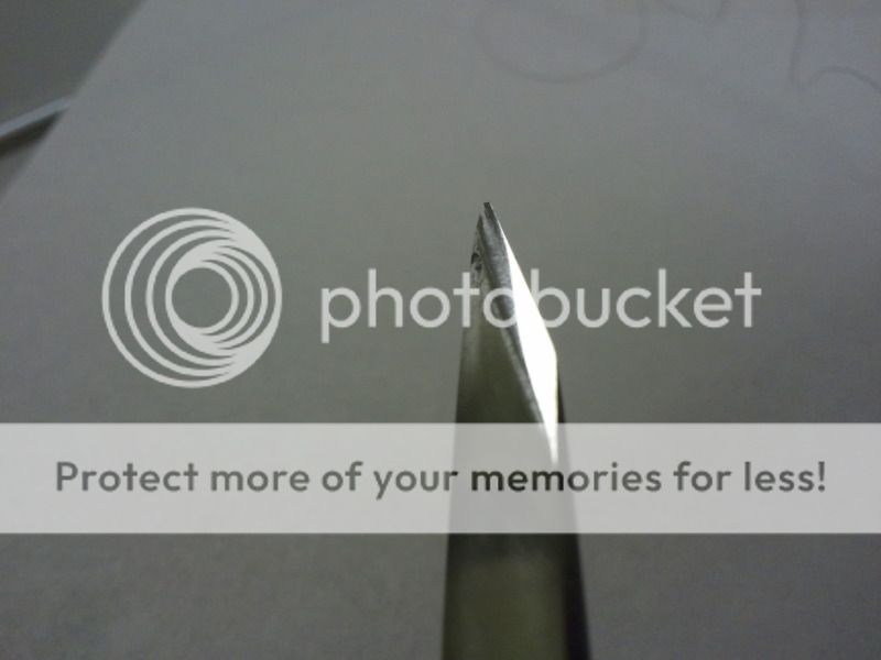

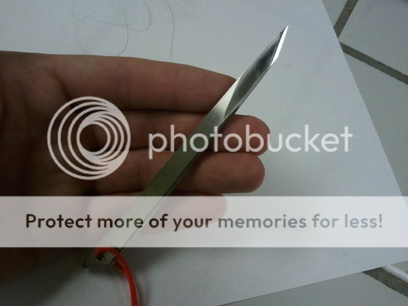

The knife I really tried to work on was a wood workers marking knife I made a year or so ago. It is 1080 steel, ground, heat treated and sharpened by me. It has excellent edge retention, is not a super tough steel, easy to sharpen as well.
here is a shot of the edge after using the black stone only, it polishes up nicely!
It took about 15 minutes to take the working class edge and get it to hair popping sharp, but I wanted to be able to whittle hair from freehand sharpening! I focused on my blade angle, consistancy, pressure, water on the stones, my breathing, and everything else I could think of. The knife is chisel ground with a slight URA grind on the back side. No stropping, no nagura stones, nothing but the edge it had and these two rocks!I finished the blade on the black one and used the white for some corrective passes.
a few mintes later and testing the edge it will now whittle hair along its entire length of edge!!!

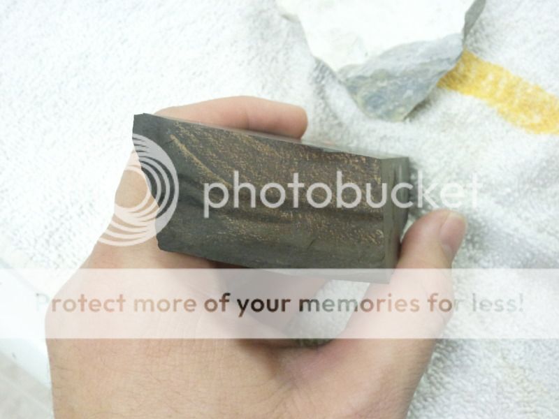

Now it was on to my found stones. I started with the black one, soaked for 30 minutes and then went at it. I found that from the previous finish I needed to keep a slurry from building up to cut aggressively. Once I got a fairly uniform finish I went to the white stone. It really polished up the good spots and showed me what else needed to be worked on. Back to the grey for a bit. Another run on the white and it was looking good, but not working up a burr.
This time I built up a slurry with just a couple passes from a 600 diamond stone. I slowed down and used little pressure. The self slurry was building nicely and I could feel the sticktion from the edge. It was polishing up well! I got a very small burr, just what I wanted! I switched to no pressure and edge trailing strokes only to work the burr off. Now this thing is laser sharp!
I decided to try and compare it to other known grits I have, I went to a CrO2 balsa bench strop first. I did several laps each side and it left scratches in the finish from the stone! Holy Cow! This stone might be the perfect finishing stone! I went back to it to try and polish out the CrO2 scratches and then right to the untreated leather. This was a minimal improvement, showing that the finishing properties of this stone are likely sub micron once a good slurry is worked up. I am very impressed with how this stone is working out! I have never had this knife this sharp!
I will try take some pics tonight after work to put up here! I know I am going to go look for more of this stone first chance I get! It feels like halfway between a soft Arkansas and a Surgical black for hardness, and finish is very close to a high quality Jnat.
