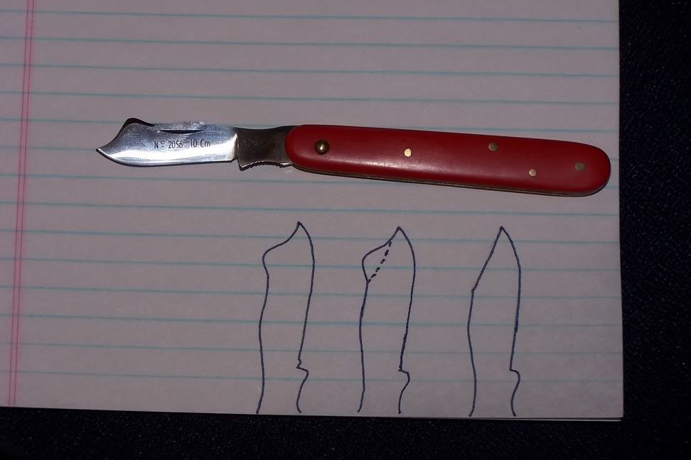

would a dremel be suitable to do this simple modification of a budding/grafting knife blade? the original blade shape is on the left, the intended cut is in the center, and the right is (hopefully) what the blade would look like afterwards.
will this work? I don't want to start, and end up with a crappy knife. :)

I'd sooner use a 4x36 belt sander. 2x48 or 2x72 would be even better and produce less heat but the 36 will work for a reprofile like that. I think I'd mount my drill in a bench holder like my portable Craftsman lathe and put a larger drum sander in it before I'd use a dremmel.
The smaller the wheel is the more you have to watch out for heat build up. Keep the blade cool by having a cup of cold water near by.

so this leads to another question: using a dremel, heat build up would be my biggest problem, right? and to keep it from ruining the blade, I would keep dipping the blade into the cup of cold water?
I noticed that while buffing some mirror polishing jobs I was doing with the dremel, the blades started to get hot to the touch, not enough to burn my hands by any means, but hot nonetheless.

If all you have is a dremmel just use the biggest drum it can handle. If it gets hot enough to burn your soft tissue areas its too hot. Skip testing with your hands or fingers. Touch it to your arm or if you must use your hand use the mid palm instead of the fingers. Caluses lie to ya.

back to business though :) so the dremel will work, and if it starts to get hot, dip it in the cup of cold water?

Only suggestion I would offer would be if you're using a grinding wheel or a cutoff wheel, to have an assistant constantly pouring a stream of water over the cutting (grinding) area. It'll be REALLY messy, but it'll help a ton to keep the blade cool, and will be best for preserving the temper of the blade.
If Dremel is the only tool you have, use it.
Lay the knife in cold water about 5-10 mm under water. Use long shaft on the sharpening device you use. Change water now and then so that the blade is cold during the work.
Takes some time to do but it works.

Just file the tip down, and finish it with the Dremel. You won't hurt the blade's temper until you get it hot enough that the steel changes color.

Or dremel it down and file the rest - only dremel in 10 second hits and dip in cold water between - finish with hand file when hump is smoothed out - you'll be fine.
