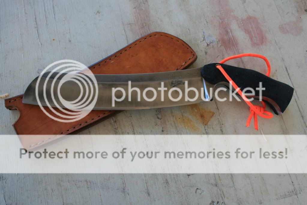

Many of the participants are themselves makers. I do know them all. I myself am one of the makers. In this competition, Many of the competitors used my knives.
Here are some images of two competition knives that I use and make:

I'd also be interested in the hardness of these blades.
The blades that are made from 52100 are 59-60 RC
The blade made from CPM M4 is 61-62
These are the 2 materials I primarily use for competition blades.
respectfully,
Jose Diaz
Which could explain why many looked to have the same contour and blade design. I was wondering about that. They look to be blades designed for competition. Is that the case?
Yes, these blades are designed with the competition as their purpose. I have used this design on back packing excursion, to replace my hatchet, and it served me well. But I would be lying if I said that these blades were not designed for the cutting competition task.
