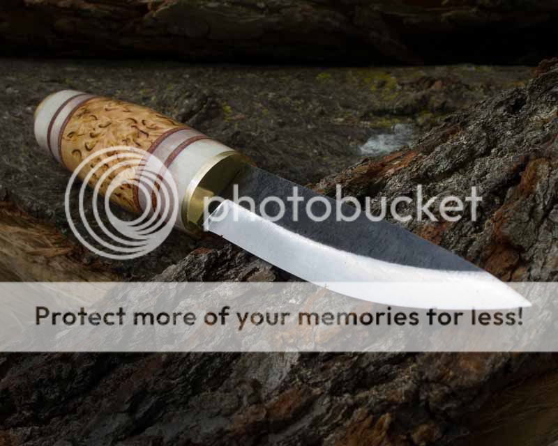

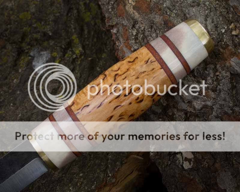

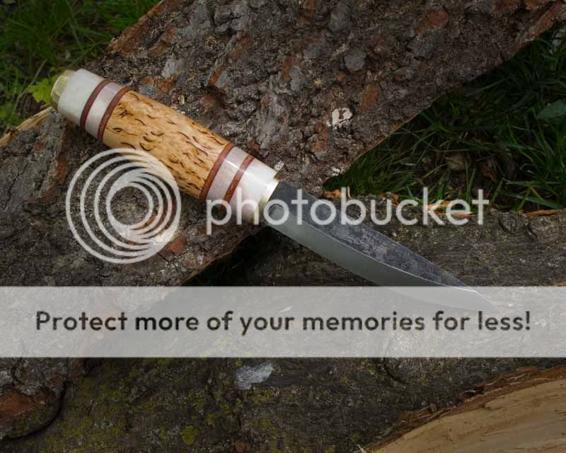

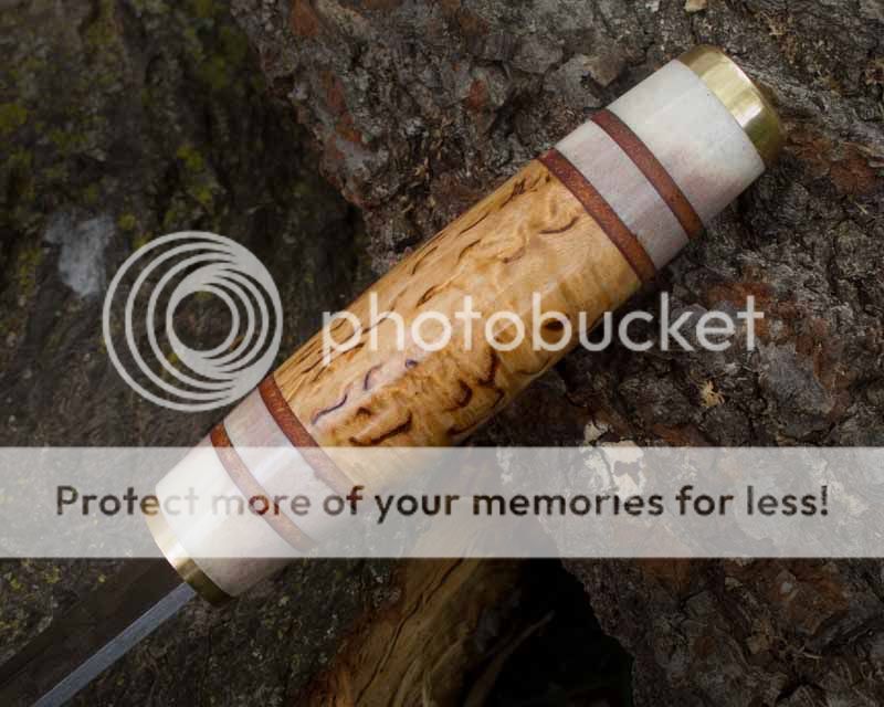

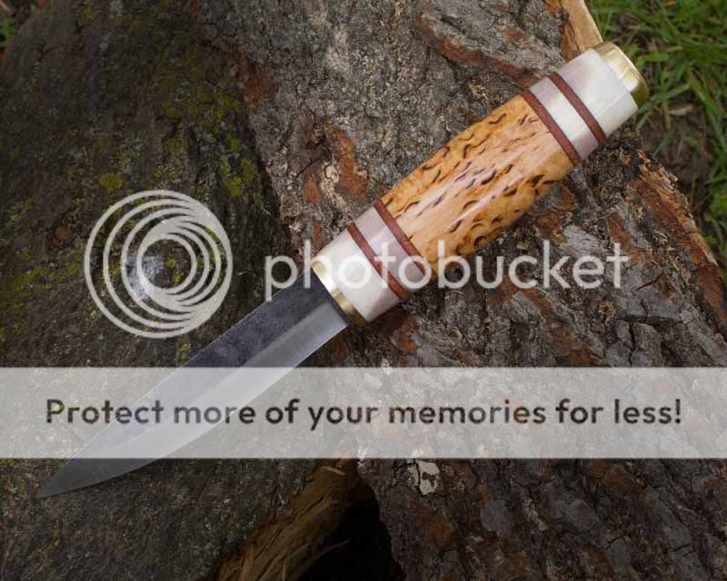

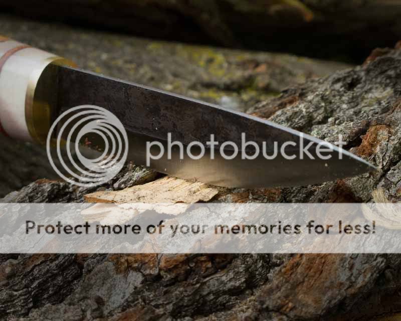

You would think, as a knifemaker, that I just had loads and loads of knives sitting around. Truth is, I only have a couple. I hate stuff sitting around, not getting used. So, if it sits too long, I find a new home for it. Also, it is an indirect way of me honing in on exactly what I like and don’t like.
Anyway, the point of this is that “my” one or two knives that I usually grab are pretty plain and simple, and used well. Almost to the point that when I show them to someone it is almost borderline embarassing to say that I made it. It is like “I make knives, and here is a fugly abused one :)”.
A combination of me wanting to make me a nicer one and incorporate a couple new things, I come up with another full tang, stick tang knife for me. The cool thing is that this one is for me. I am sure there are people who will not like the thickness, or the grind or the handle. I can already hear the cries of the “the grind is too thin” etc. But, I know exactly what I was going for here.
For years, even before I made knives, I was (and still am) a huge fan of keeping scandi bevels flat. Sharpening on waterstones, except when field sharpening was required. Depending on the steel, original grind angle, and intended use of the knife, I might put a one or two stroke micro bevel on.
I have seen some real hard core user knives that started off as flat scandi’s. Through the course of LOTS of use, and TONS of leather compound stropping, the bevels took on a very nice polish and just a hint of convexing. A touch of rounding on the top corner and a touch of rounding at the cutting edge. Through use, I have found that the touch of rounding will let me go thinner on my bevels than I normally would, and a touch of strength is brought back into the edge. At the same time, the bevel is still flat enough to get the wood carving control that I personally want.
This is a very, very tough balancing act. For me anyway, because I am ultra picky when I am going after something very specific like this. Tiny little things that I doubt most people would realize. People have been making a “scandi-vex” grind for quite a while. I don’t quite consider this that style of grind, because to me that implies more “vexing” than I am going for here.
If anyone has ever used a Kellam, that is more what I am after, but in my own steel, own heat treat, and my own handle and build design. Others will probably argue that the Kellam grind is put on flat, but it is not. The last bit of the edge has been polished right into the bevel, giving very much the same effect I was going for here.
The way I did mine is to get the grind very close to complete on the coarse belts. The next finer grit, took it even closer. That is when I dumped the scandi jig, and went freehand. I started with a deformable belt (a trizac) and polished, and made sure I got a burr on both sides. In the free hand, I induce probably about a .5 degree tilt. Between that, and the deforming belt, I got what I wanted. I finished on a series of cork and felt (all deformable) to continue the very mild convex process and finish.
Before I even put time in the handle, I did quite a series of tests on the blade. Carving, batoning, making some simple items? Why did I bother doing all that? If the grind wasn’t what I wanted…..too convex, too thin, etc, I did not want to bother putting more effort and money into this particular one. But, it worked out great for me. So, I freehand polished the bevels one last time, and started the handle part.
Oh yeah…..a couple details. The stock thickness is 1/8”. It is O1. The initial bevels were put in at 9 degrees per side before all the hand work.
That is probably enough words, so now I will just post the pics.
This one will be a strop and use, strop and use knife and I am very happy with it so far. My new user.
It doesn’t matter to me if you like it or hate it……I would love to hear your inputs experiences with similar knives (ie Kellam, overly used scandi, whatever you got…….). Everyone’s use dictactes the geometry and style and what works best for them. The past couple years in the woods for me have been leading me towards this, and even though I am very excited right now, I know enough to never declare I am “done.” :) I am looking forward to using this one and to see where the next couple years lead me into.

Don’t get me wrong. I have been using “flat” scandi’s for a long time, and will continue to do so. I have come up with a combination of angle, steel, temper, etc that more than meets my own durability requirements.
My reason for doing something “different” for this one come from two places. 1) Wanting to do the “strop maintence” on this one without all the worry of perfectly flat waterstone bevels. But just enough that I don’t mess up my carving control. 2) To thin the bevel to a level that is thinner than I would normally be comfortable with. Getting it thinner, sharper, and yet adding just a touch of durability back into it.
I realize I am in an extreme minority in the things I look for in a knife like this. But, as you gentleman have already said …….. “As long as it works for you”

I have been a huge fan of “flat” bevels for years. Because of the physics invovled in making a blade that you described, I always took my scandi’s to a lapped, coarse waterstone. Instead of using a flatness guage as you mentioned, I figured once the stone was lapped, I can’t get much more precise than that. Then, I could tell flatness by being able to produce an even scratch pattern ALL the way across the bevel. Then, I take it through the series of grits until I am done. All sharpenings later are just at the higher grit levels and I never have to spend a lot of time on them.
So……been there, huge fan of that. Now, that is where this knife comes in.
I have done a lot of experiementing with different grind angles and keeping them flat, and what they can do. I know where my limit for comfort is for my own knives, and I also have to be aware of what customers are going to do with theirs. But, this one is for me, so I don’t have to worry about others for a moment.
I took this one just a hair beyond my comfort level. Then by introducing and VERY, VERY slight amount of curve, bringing some additional durability back in. If you look at it, you would sweat it was flat, and would need a method like you described to determine otherwise.
The line I am trying to flirt with here is a slight loss in flatness, of which the acceptable level will be how much I notice it through use in which flatness matters to me, balanced with a touch of added durability so that I can take the bevels thinner than I normally wood. I have been using this knife every day, and so far, I am very happy with it. The cutting ability is way up there.
Point being….I hear what you saying and I agree with you, and have done it for a long time. At the same time, I don’t want to keep doing the same thing over and over again even if I fail in the new things I am trying. It is the experimenting that keeps me excited and who knows? Perhaps I will find something that is better than what I thought was the best. Wouldn’t be the first time it happened :)

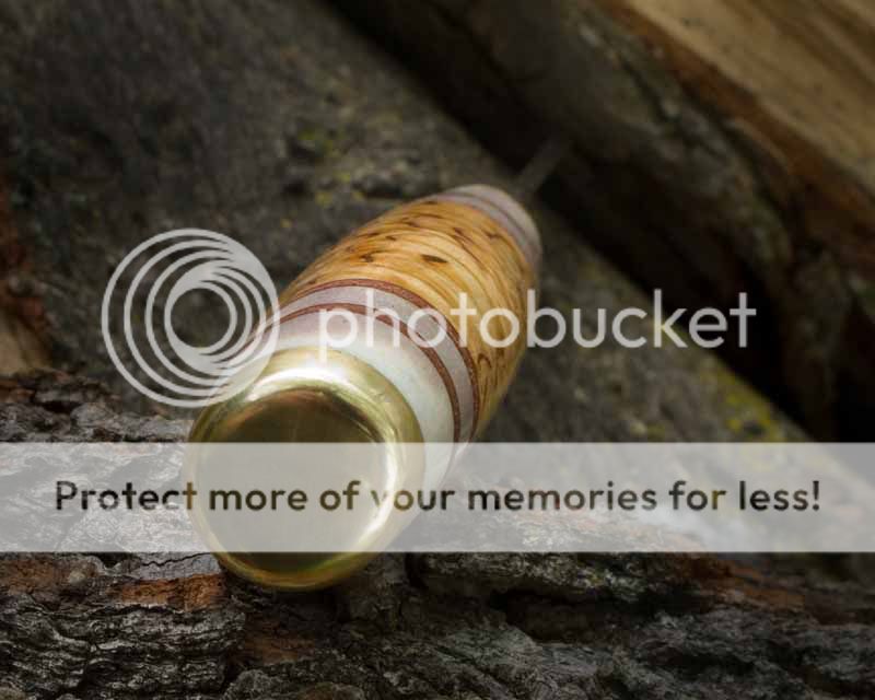

Brian is the brass pommel made to be used or just looks? (HAMMER-Batton)
THANKS!
You can use the pommel. I machined it from a solid piece of brass hex stock. It is drilled and tapped and threaded to the full tang. The handle pieces are fit very well, and finished off with West Systems epoxy. I am beyond happy with the build up style.
I realize brass is not the hardest of metals, and I can do the same procedure with stainless and other steels. But, this is what I wanted. I have some knives like this, where the butt is wood, and I still will hit them with a stick.
Personall, I don’t beat the piss out of the butt, but I do pound on the butt with a stick to drive the knife into a log for “no hand” or repetitive operations. If I do it with wood, I would gladly do it with brass. It is plenty thick enough, and if it got enough scratches that it bothered me it could easily be re-sanded and re-buffed. But, me personally, I like the signs of use. A prisitine knife is one that doesn’t get used enough :)
