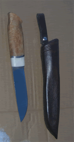

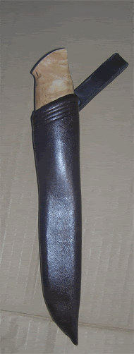

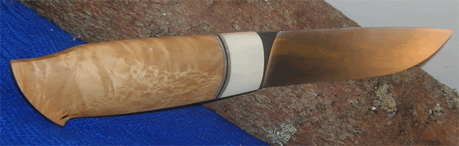

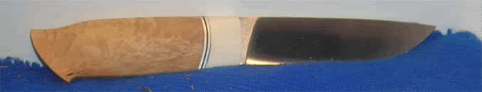

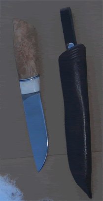

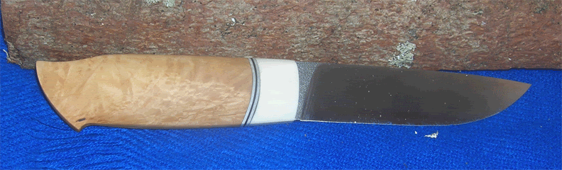

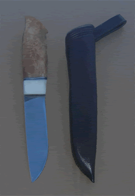

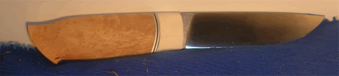

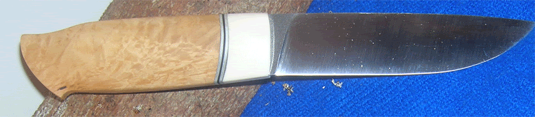

I almost finished this one today. I just have to polish it tomorrow.
The blade is convexground and is in 3,5 mm AEB-L legnth is 110 mm and is 28 mm wide.
The handle is made from reindeer and crotched maple.

now that is a sweet knife. I imagine how i feather a stick for a fire with that one. tell me, how the AEB-L is acting like for a working blade?
Thank you knifemaniac:D. I like AEB-L for my workingblades. Its stainless and is fairly easy to sharp and holds the edge pretty well. A nice compromise i think.
Seved
I still havent ground convexed edges. It sure must be a tough edge to hold the work. Nordic style blade with convex is something interesting.
Try it its good grinds. I have a piece leather glued on the platen that i grind against it works good for me.
