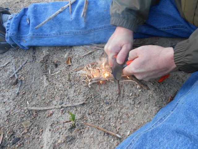

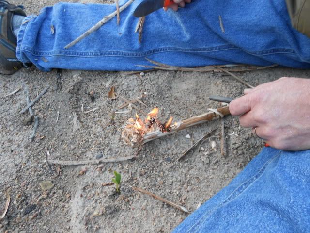

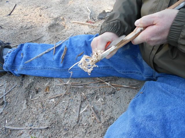

Went out this morning and took part in this little contest. I selected my branch from off a dead willow tree down by the river.
after cutting my branch from that tree, I went down to the sand bar and had a seat and started shaving some curles with my knife.
Got out the old fire steel and started to do some fast scraping with my knife and made shower of shower of sparks till my curls lit.
Bryan
