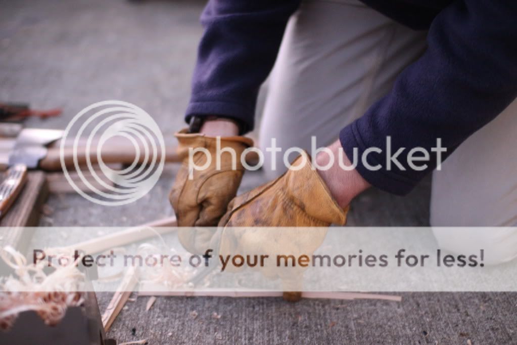

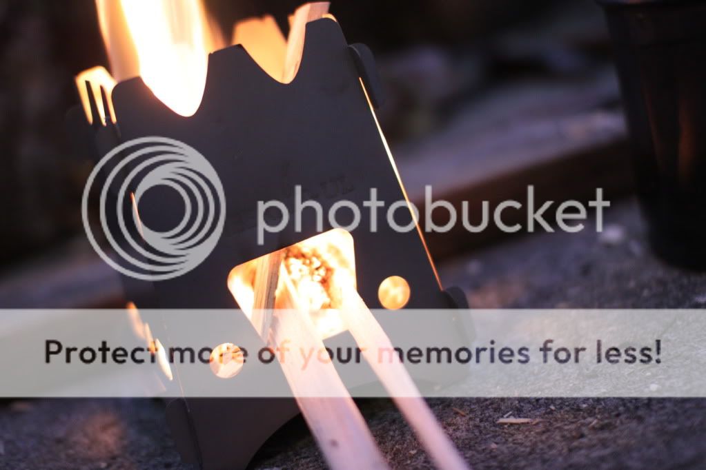

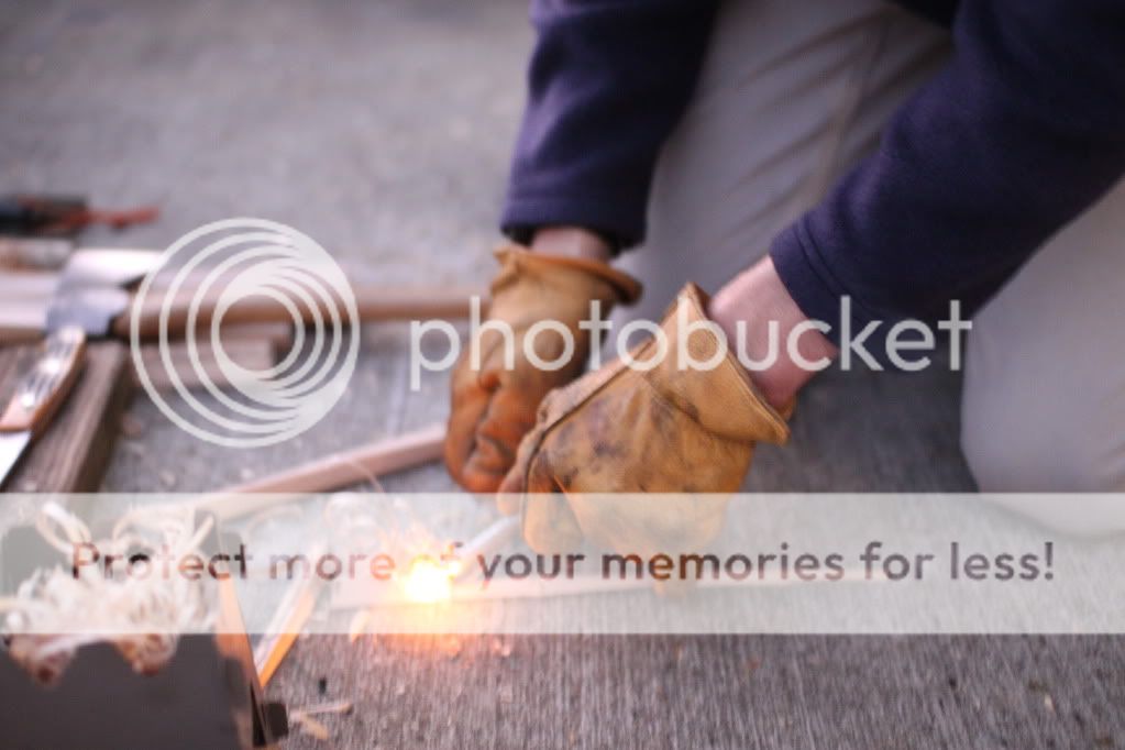

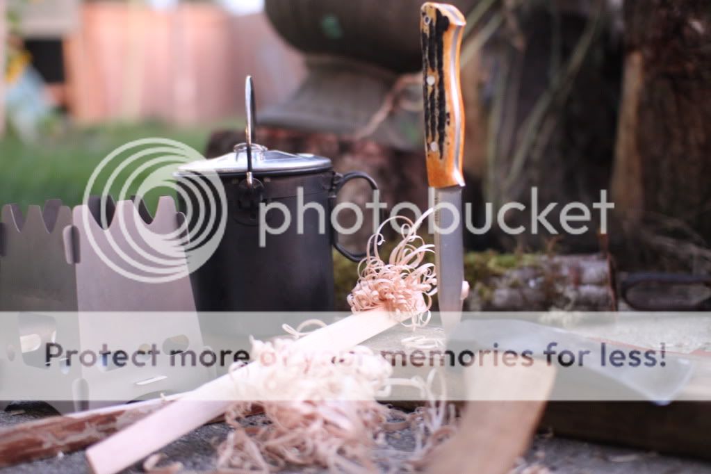

Decided to join the fun. Besides, I have a blast doing this with my son.
The tea is excellent!
Thanks to the folks who posted the tips and videos. They helped a lot. This was my first time trying to light woods shavings with a firesteel and I was 2 for 2. It's pretty cool to have a new skill. Now I just need to practice on a regular basis.

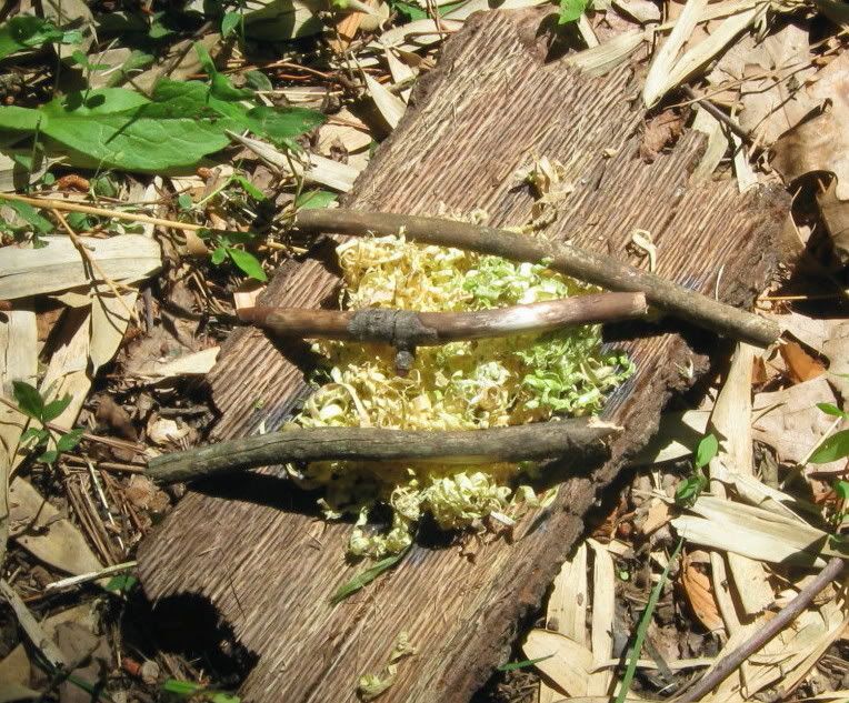

haven't experimented with green wood in this, but I have taken fine green bamboo shavings and dried them in the sun for an hour or so and they light with a fire steel very well, even lighting them one-handed.
The twigs are keeping the shavings from blowing away as they dry.
