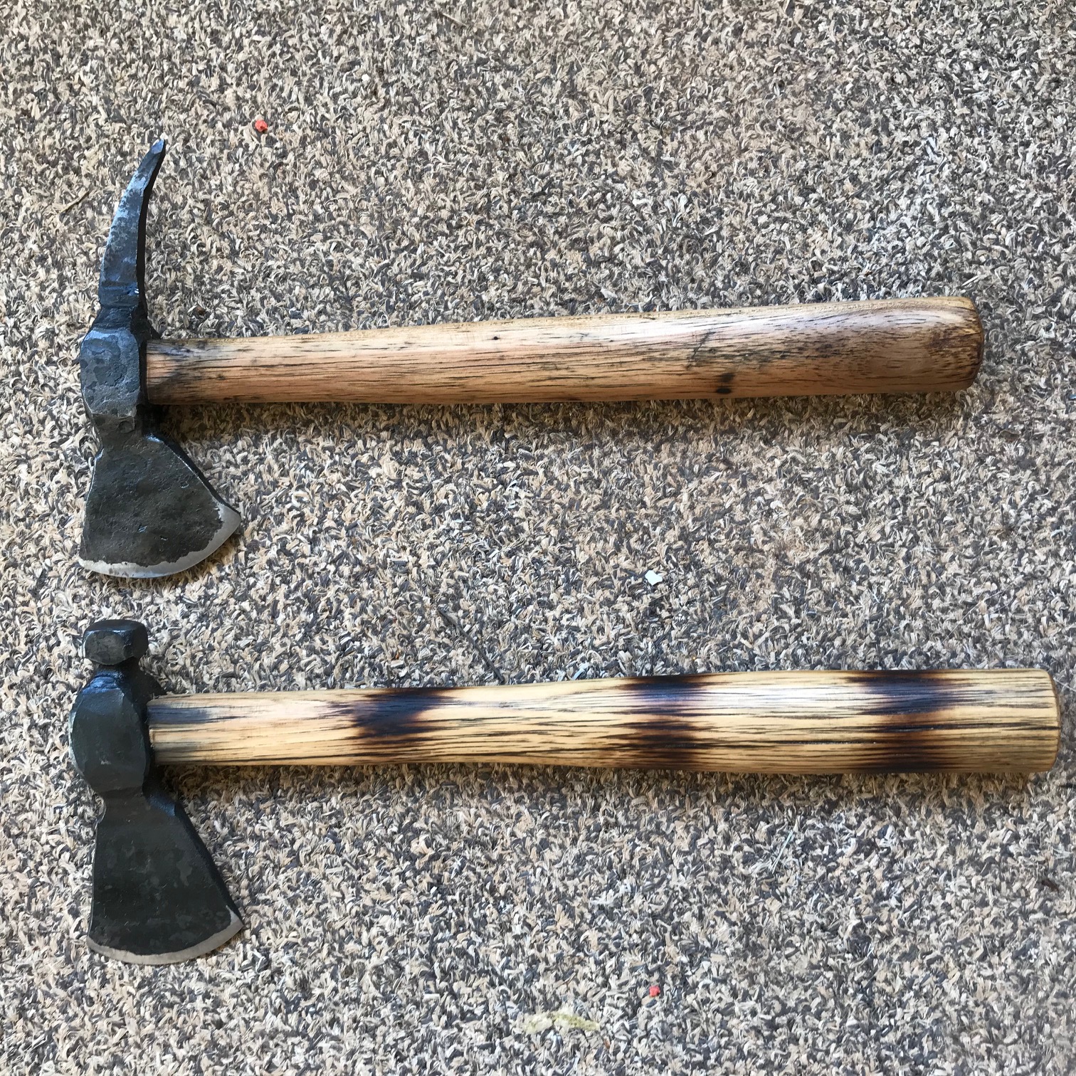

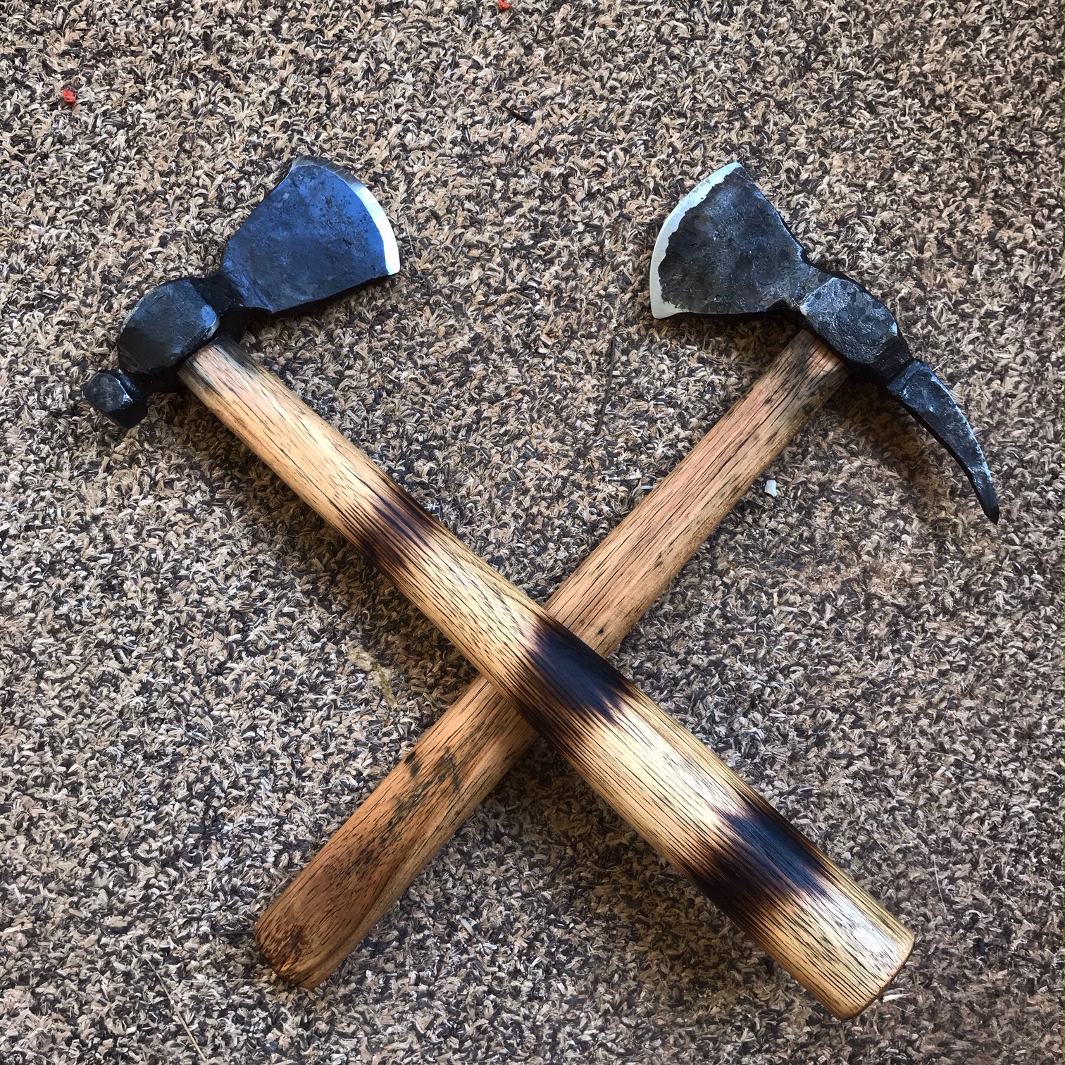

Here's the second iteration of my attempts to forge a ball peen hawk. These two started as 12 oz hammers. Heat treated in a kiln at 1500 into 10 second oil, then tempered at 450. Eyes are drifted larger and rectangle, with handles wedge fit like a modern hammer. Cutting edges are right at 2 1/4", with hickory handles at 12 and 13 inches. Overall weight is around 15.5 oz.
