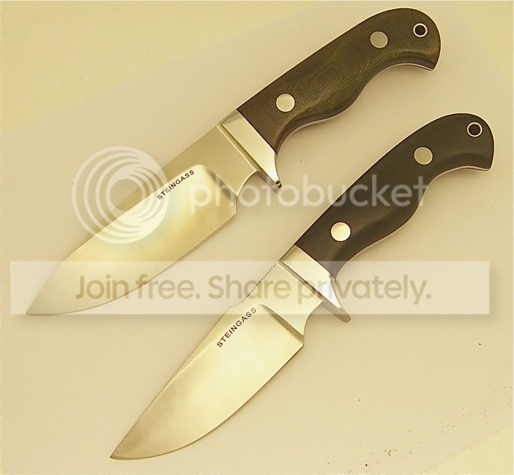

Hi Fellas:
I designed these two hunters using the Man Knife as the main theme - the green canvas micarta model with a tapered tang and black liners has the dropped point. The black micarta model has a hump-backed spine, thumb grooves, tapered tang with red liners. Both knives are made from 3/16" D-2, belt satin finish blades, with 416SS furniture, 4 1/2" hollow-ground blades and 8 3/4" OAL. I'll be showing this pair at the Chesapeake Knife Show in Timonium, MD, December 12. These are the first two of this style - what do you think?
TK
Calvin:
Thanks! Neutral balance about 1/16" forward of front rivet - turned out good! Glad to look at yours, but couldn't find it - can you help?
TK
TK, both look awesome! I'd have to say I like the blade on the BLM version a little more though. The hump and gimping make it a little more unique. JMHO.
I love it !!!
The knife with the droppointblade is absolutli PERFEKT :thumbup:,
Greatings from Austria,
Radhulbh.
They are both excellent but as a matter of utility I think the humpback with grooves will be the superior user. I'd take either one. Very nice!
