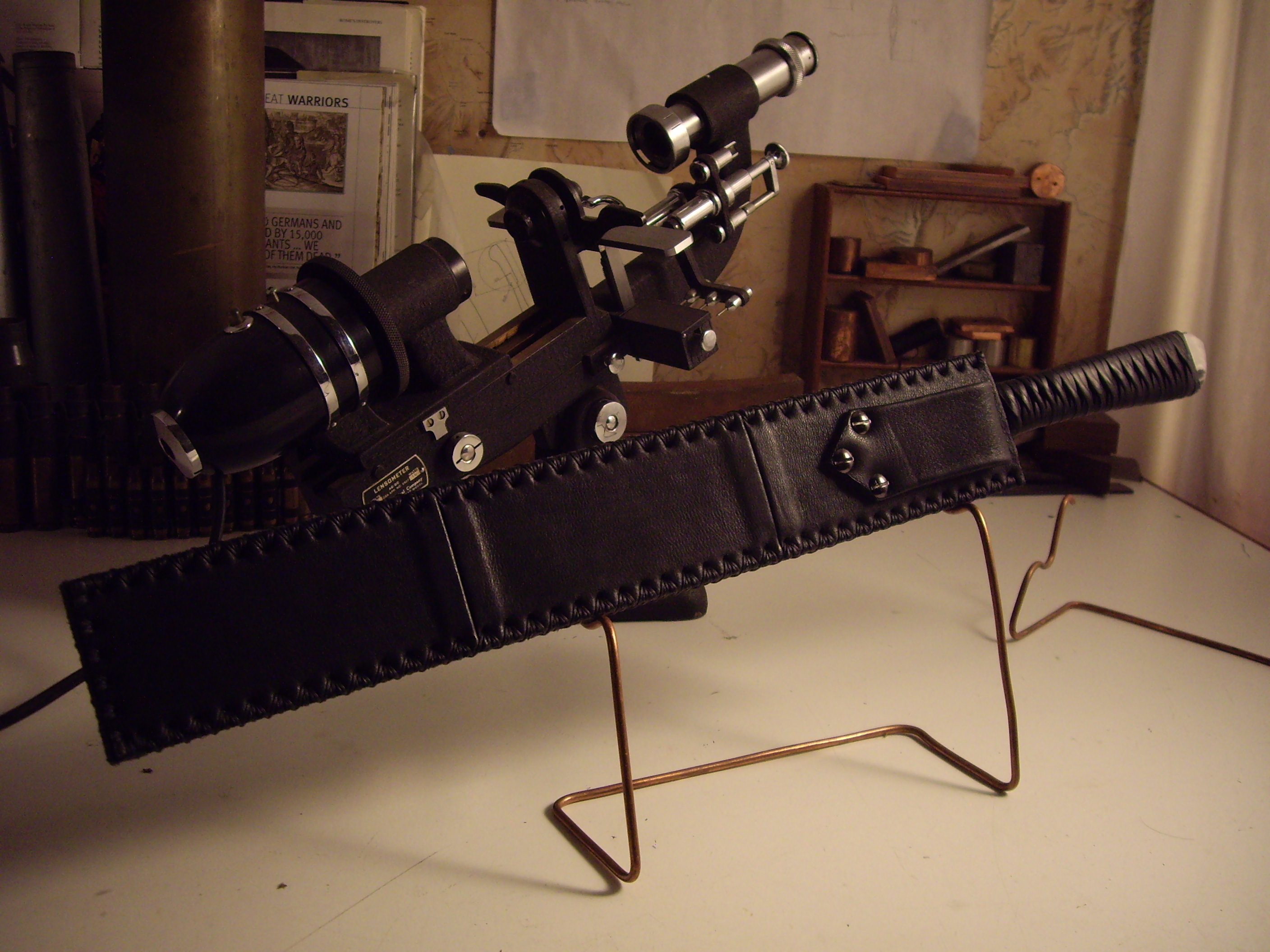

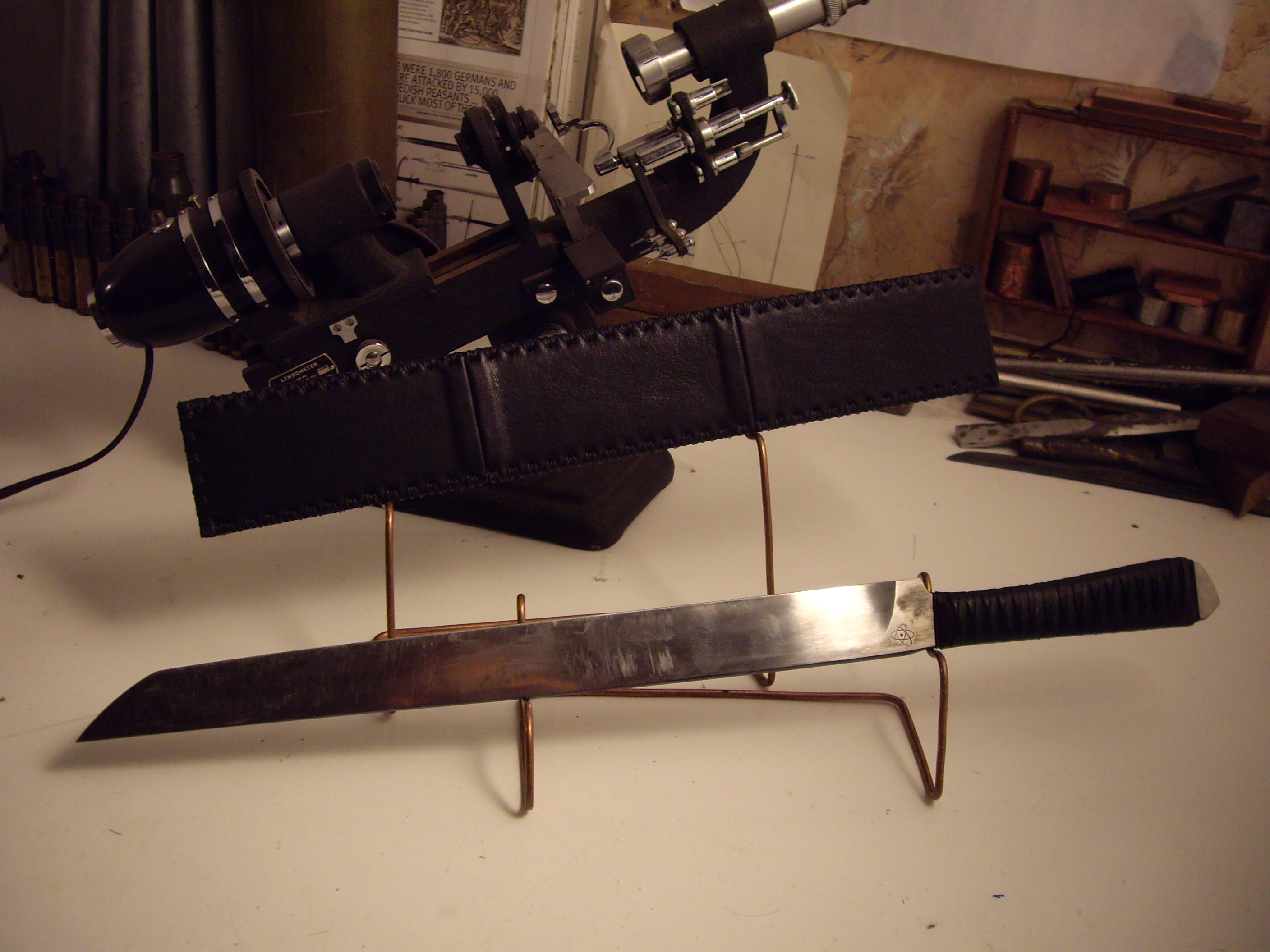

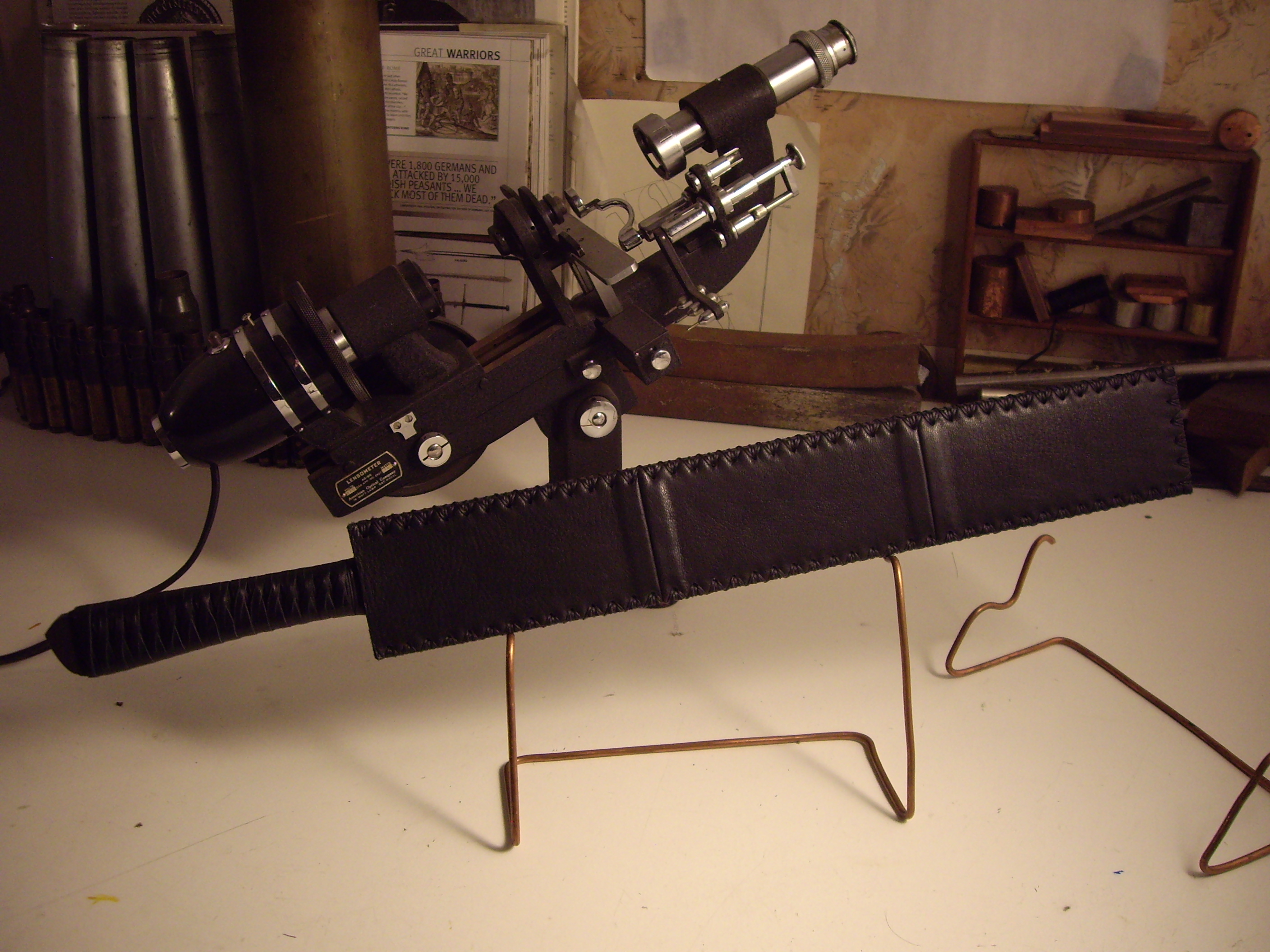

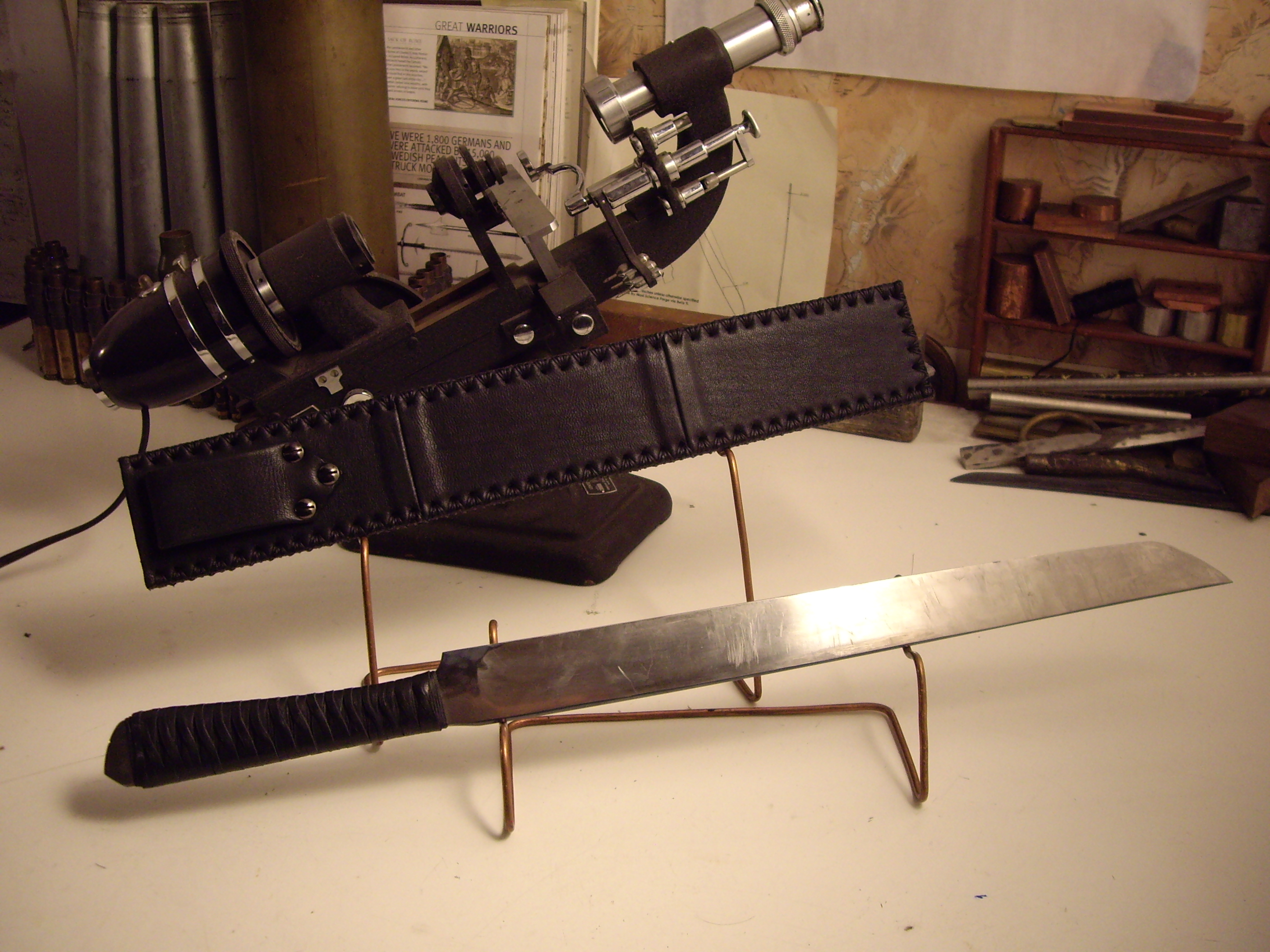

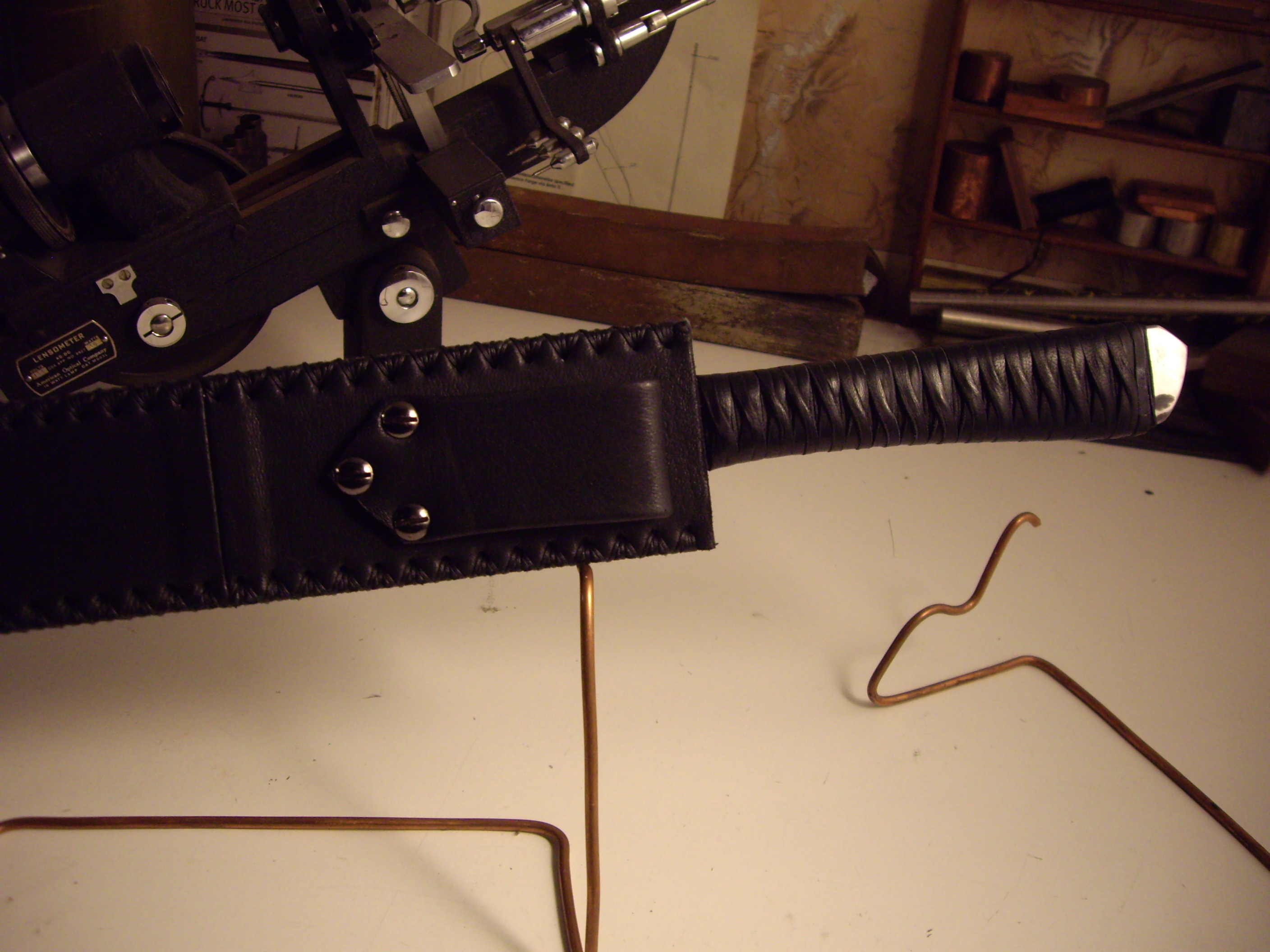

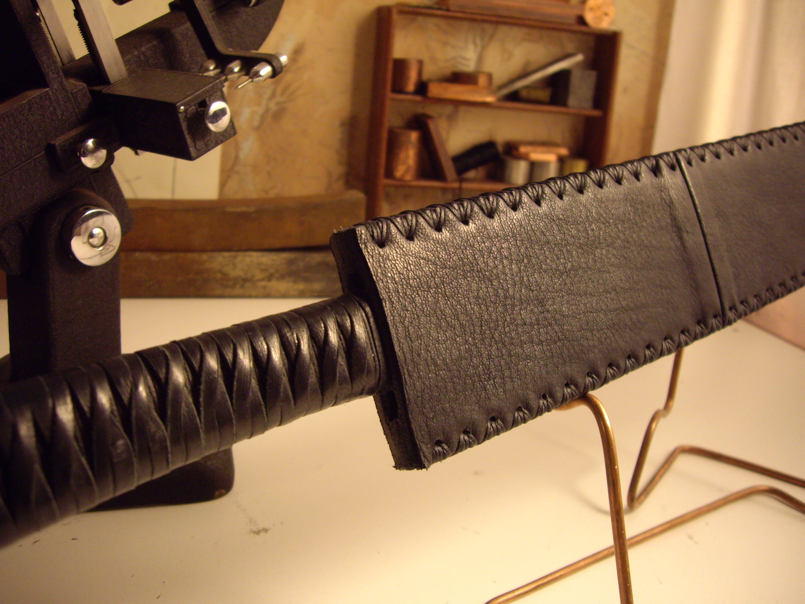

Here's the last round of photos for this blade, as-used from the video plus it's finished sheath (which is not floppy). This type of sheath is getting sidelined in favor of a scabbard with a similar kevlar-stitched paneling of leather, but with a metal superstructure a'la Phill Hartsfield.
Thanks for looking, everyone. Keep a look out for the next big advancement of these forged beta ti blades over the winter: full take-down swords.
