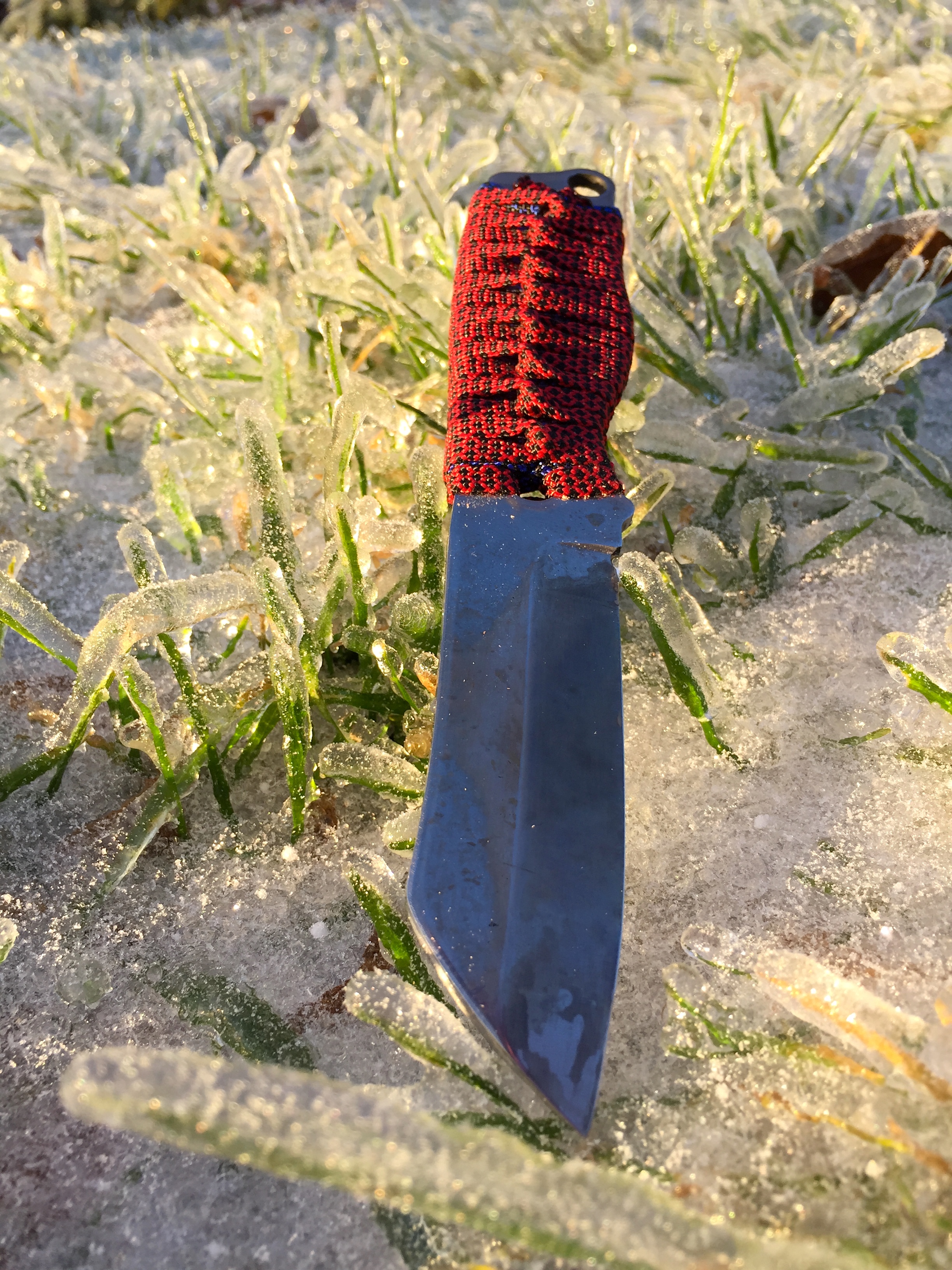

I have a Skrama and a Mini Skrama. That steel is pretty darn good. And the Mini is a really great small EDC. Mine is the one without the rubber handle and it slips in the right front pocket nicely. The flat profile practically disappears in pocket and I often forget I have it. I wrapped mine with paracord and made a leather slip for it. The Skrama is a great knife too, but the Mini Skrama is a more general use knife and a perfect EDC for me.
