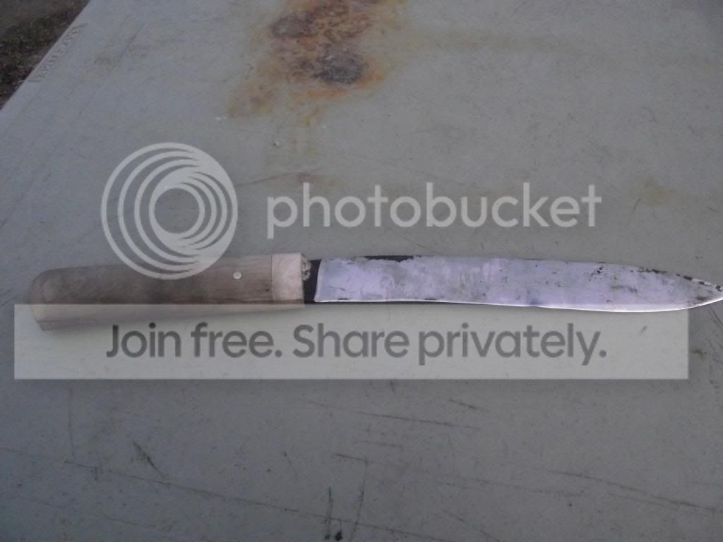

Alright guys, I lost a day last weekend and has an extra this weekend, and so here is the first weekend knife in all its glory:
Specs: About 13 inches overall, 8 inch blade. Steel: chunk of a coil spring.

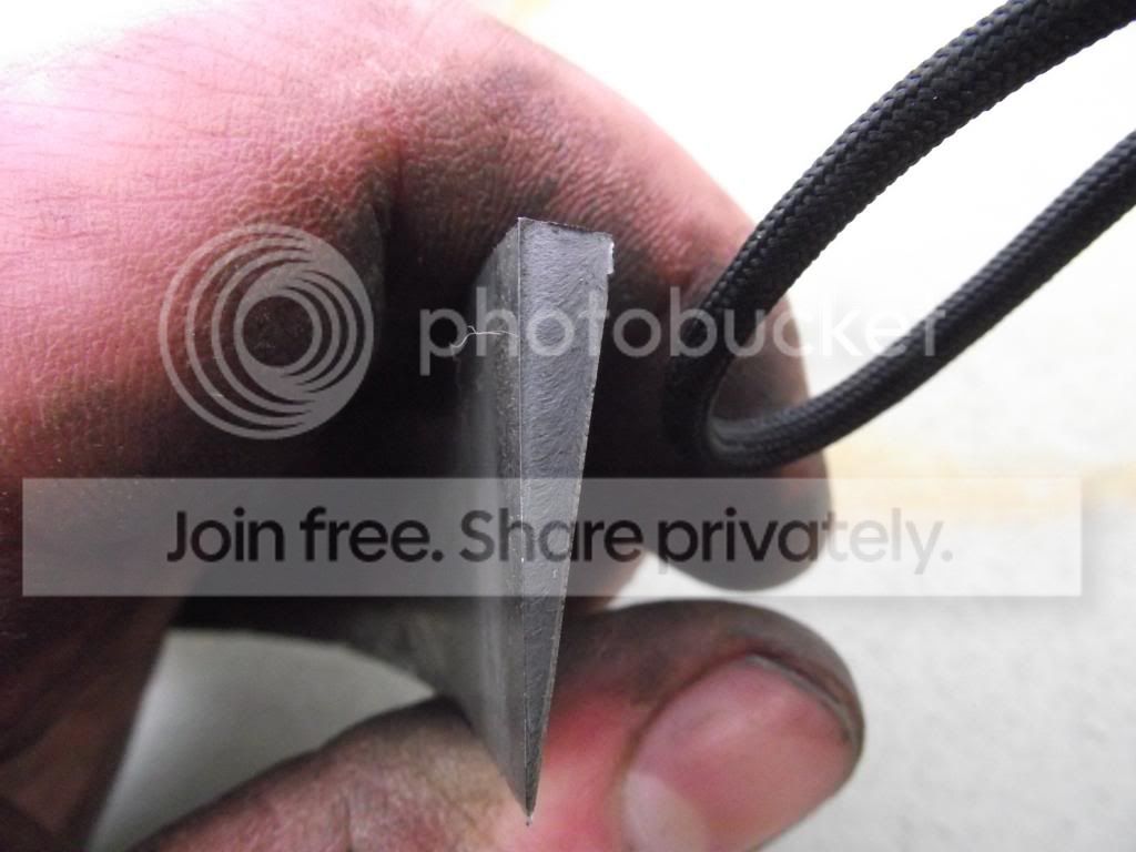

Yep, its uglier than snot, I know, but it was what I got done. As you can see in the second pic, I royally screwed the handle, and so I decided that I wouldn't put a ton of work into making the rest look pretty.
Yep, got a bit grinder happy. My fault, but it was a very valuable learning experience. I did learn some things from it that will be incorporated into the next build, which, weather permitting, will start tomorrow.
Finally, I did a little chopping with it. It was surprisingly light, and so it didn't chop very well, but it was the most effective thing I have ever witnessed for cutting blackberries short of a weedwacker with a metal blade. Then, then final thing. I did a bend test on it. Surprisingly, it went very far before it broke, well over 90 degrees, and the grain was quite fine. For HT with charcoal, I thought it was good. I have a propane forge, but I am just not as comfortable with it as I am with a good old fire.

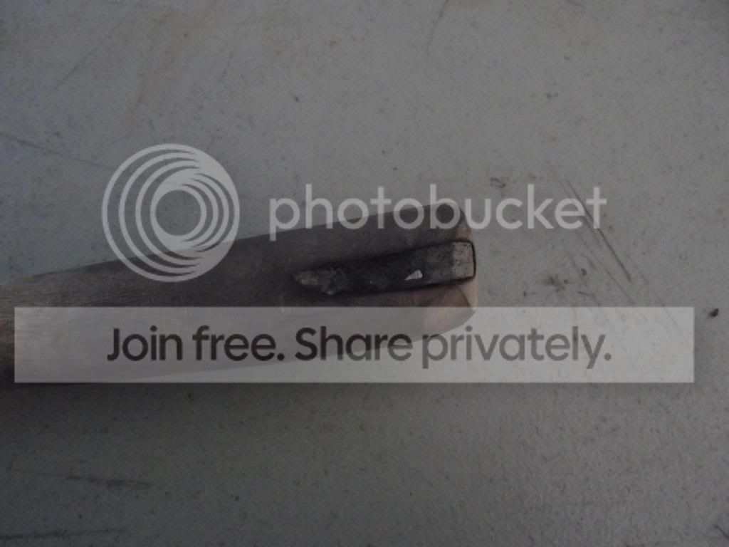

Overall, a good try. I will continue to try these and hopefully get them better and better every week. I didn't get good pictures of the guard, nor was it very good, so I will try again next time.
