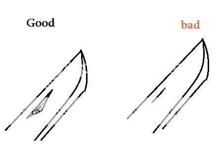

Agreed! A well implemented a nail nick allows you to hook your nail in and pull straight out without lateral movement, even with the type of thin, flexy blades mentioned by On-the-edge, above. I've found Ohta's crescent nail nicks to be particularly good.

I'm also annoyed by blade rub scratches. Opening the large blade first is a great tip. It still puzzles me that people say that blade rub can be avoided if you pinch, rather than push the blade sideways when using the nail nick. I must have weak fingers, blades that ride too low, or nicks that are too small, because I can never manage to do this, particularly on the spey/pen blade on a two spring stockman. Is there some secret that I'm missing?
isko: youre not missing anything. Some knives like sodbuster, barlows, and other single blade folders are natural "pinchers," that is to say that one-third to one-half of the blade is exposed when closed. Now on multi blade folders, in which a tiny space is occupied by several blades, this is impossible. I dont care who you are but youre not going to pinch any swiss army knife (for example) with more than one blade. As stated earlier, the better engineered the nail-nick is, the less horizontal pressure there is, which accounts for blade rub. The trick is to expose the blade by nail-nick to the point where the backspring equalizes (stops pulling down), and then pinch the blade the rest of the way.
Im sure others can chime in on this, but an effective nail-nick is one that is shaped like an "eye," and deep enough so that one's nail can easily slip in without forcing the blade against the liner\adjacent blade, providing maximum vertical force.
