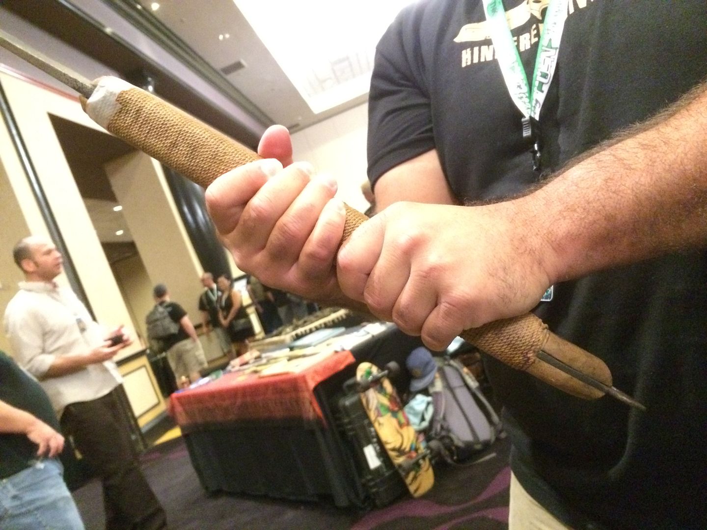

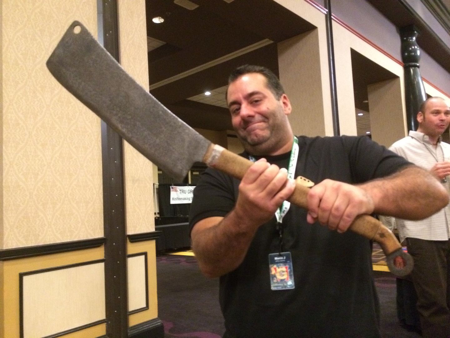

At the Gathering this year Paul Farina the dealer that shared are quad space had a Carcass Splitter from the 1800's
As soon as I picked it up I was amazed at how it felt
The piece exhibited things that today's stuff rarely has

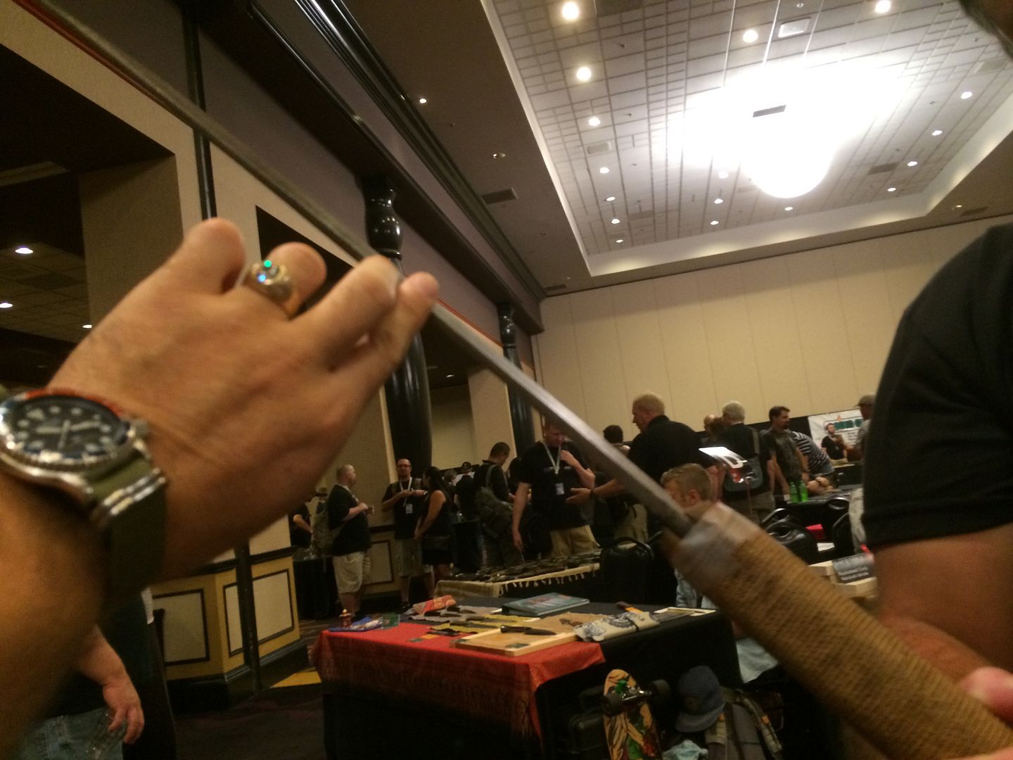

First off it had radical distal taper
Next it had a wonderful tapered tang
It had a differentially heat treated blade
This was a tool meant to be used and its build quality and more importantly its build design echos a time when men built high performance tools and had the advantage of really putting them to use to test them
This is who made this piece
It's survived a lot of use and stands as an example for all modern day makers who have seemed to forget the performance engphancements this blade exhibits
This piece really made an impression on me

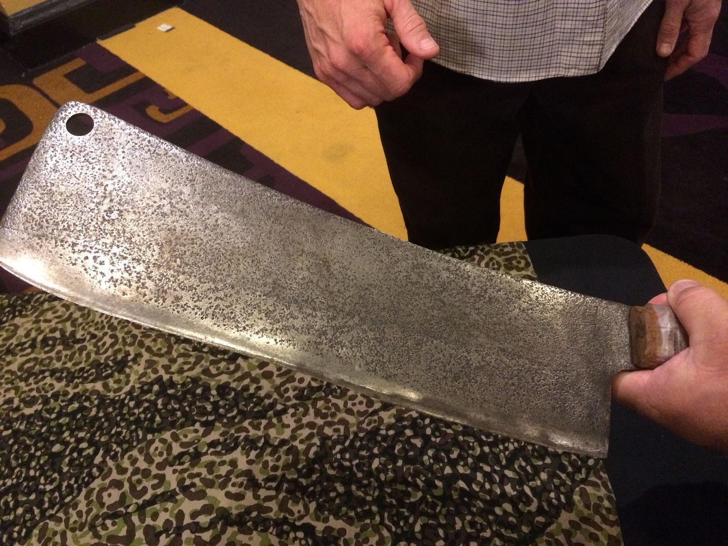

I have one like that. It hangs on my wall, and every once in awhile I take it down and play with it. It's an awe inspiring blade made in the 1880's, still as solid and sharp as the day it was forged. I paid $100. for it at a flea market and consider it one of the best finds I ever found at a flea market.

Great looking massive cleaver, Joe ! :cool: :thumbup:
I consider them a limbo between a sword and a tool; it works in either bailiwick. It was made in the thought that tools should work and not just look cool. :D

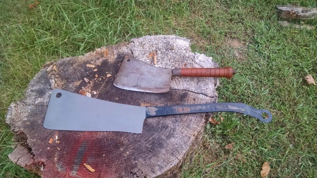

Joe, here is a Foster Bro. #8 cleaver that I redid the handle on and a Foster Bro. beef splitter that I am going to refurb for a customer. The beef splitter is 28" OAL with a 12" blade.
another shot showing the distal taper on both
I turned a new handle out of osage orange for the cleaver and just cleaned up the blade. The splitter is going to be a bigger project.

I haven't done anything to the edge on the beef splitter yet so i can't say anything about the temper. It feels a lot lighter and faster in the hand than it looks like it should. I am sure this is due to the distal taper, as you mentioned. You would still have to be a REAL MAN to swing it all day in a butcher shop but it is definitely designed to be used.
I have played around with the cleaver a lot more. As far as the temper and judging from how a mill bastard file cuts near the edge, i would say it is softer than most modern knives but as hard or harder than most axes or hatchets. It will definitely take a shaving sharp edge and it has held it pretty well while i was making feather sticks and doing fire prep. I am pretty sure that these were differentially hardened based on other ones I have seen. Several have had mushrooming on the spine, I guess from using a hammer to drive/baton it through a big joint.
It feels fairly heavy in the hand but it is almost 1/2" thick at the handle and only has an 8" handle. I have used it a few times for chopping pork barbeque and you dont really have to swing it for doing that, you just pick it up and let the weight do the work on the way down.

Yes, often cleavers were differentially heat treated. Also, the edges are traditionally done as a fairly thick appleseed with an angle more similar to a cold chisel since their job was to cleave through thick bone. The tangs on nice examples were tapered, and the blades were double-tapered, having both a taper from heel to toe as well as from spine to edge. :)
