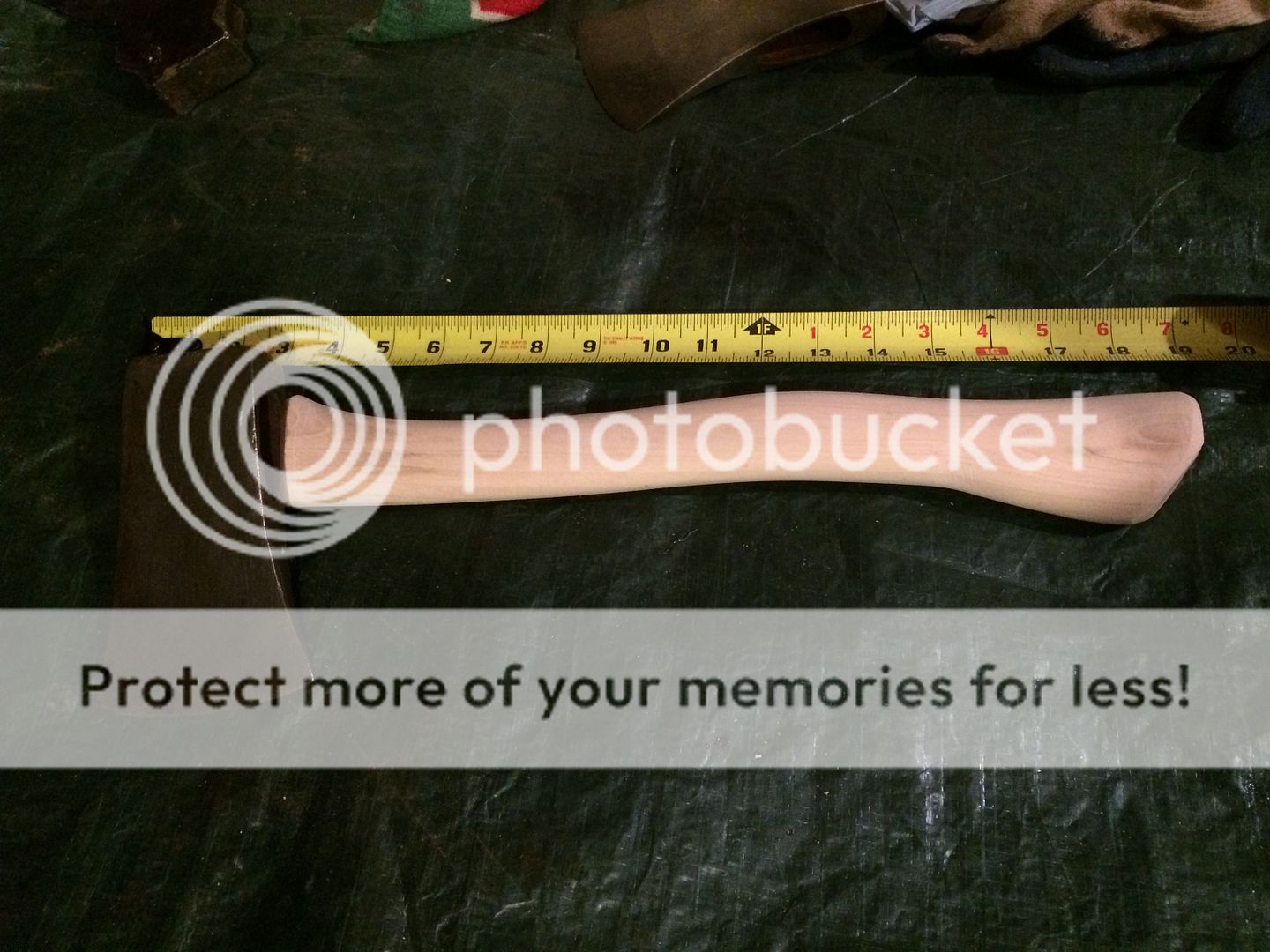

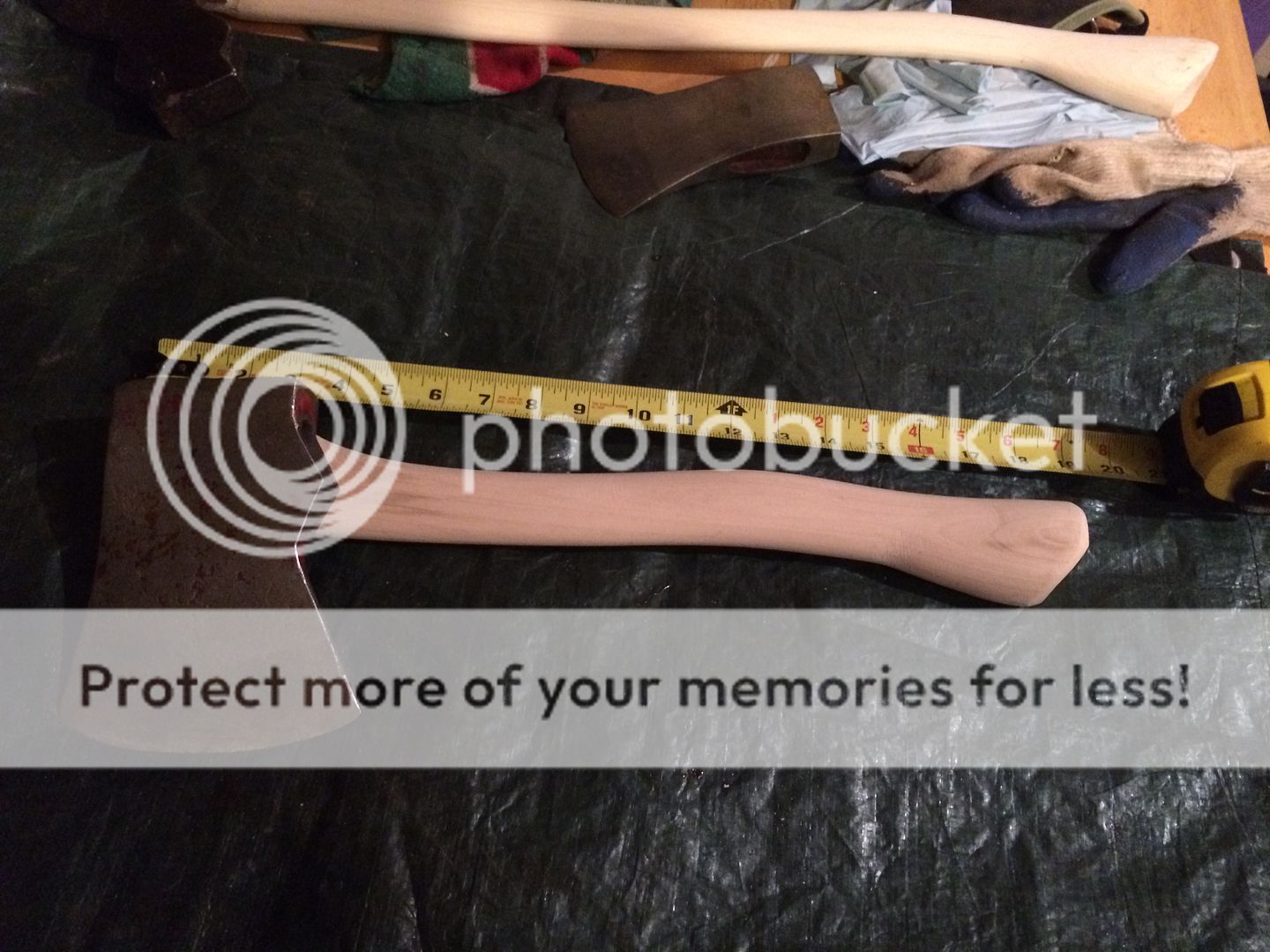

I have a house axe handle from House Handles (ahem) and want to hang a head on it. I have several full sized heads of varying shapes that fit and some look better than others, but all seem a tad too large to my eye. They would work, but just seem big and a bit unbalanced. The last one that I test fit brought the tool weight to 4.2lbs on a 19 inch handle.
My question is: Is this correct? I know that this is a kind of step up from a large camp hatchet, but is there a "standard"? Is there a defined weight and pattern for a house axe? Looking forward to the lesson.

2.5-3.x lbs maybe for a guide?
Inclined to think with a larger head on a smaller handle,the handle completely filling the eye would be a "solid" requirement.

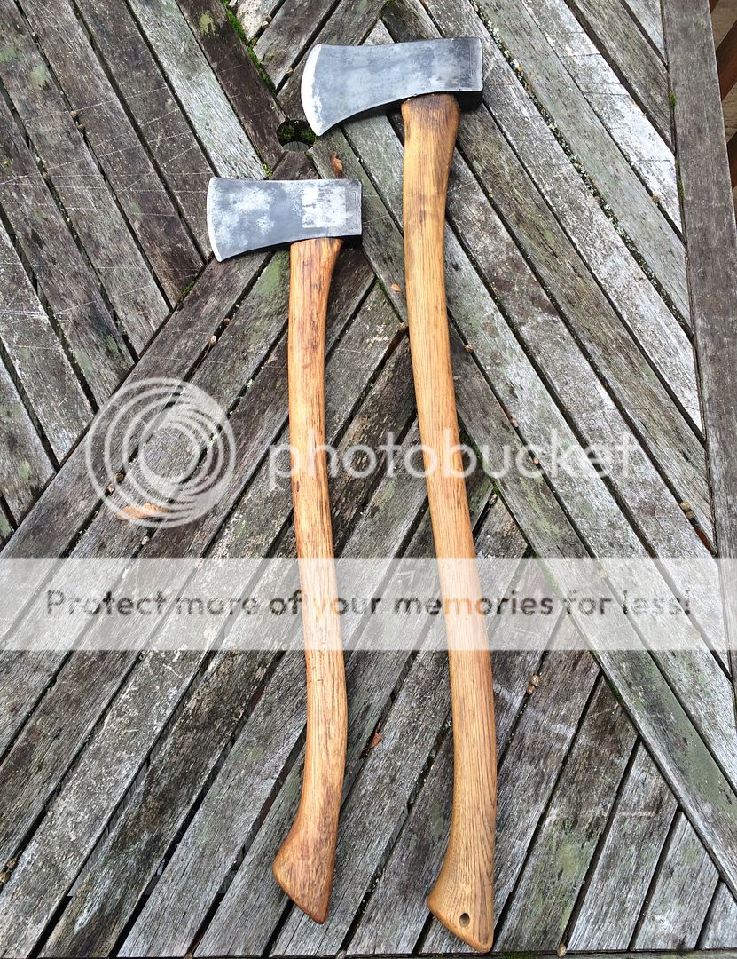

Posted this 3 weeks ago or so. I gave it to a friend who really likes it. Just example of a boy's axe head on a shorter handle. It did require a bit of material to be removed.
I originally hung it on the smaller axe's handle in this pic. Didn't really like how it handled. Felt too far away.
The head is marked with a 2 and the increment is worn away.

Kind of rough but a full-sized (Jersey for example), seems unwieldly.
Same handle with a 2.5lb head pulpwood axe.
Just for conversation's sake.

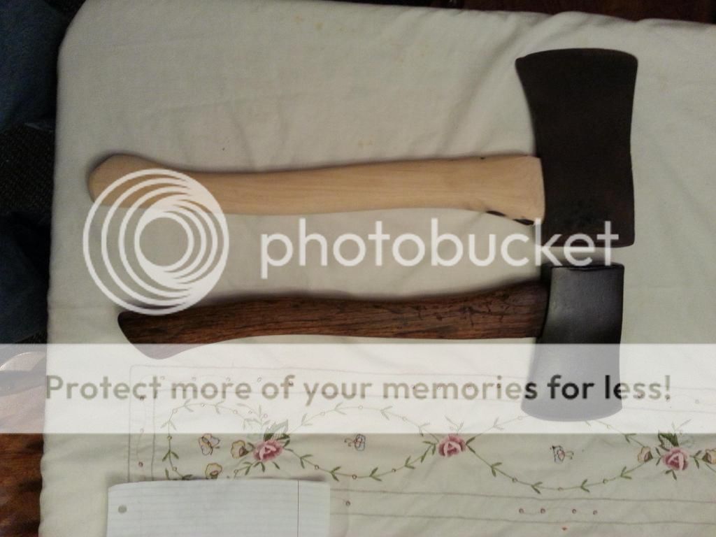

Yes, I have a couple of what I think of as large camp axes. I think of them as the size up from a scout hatchet. These houses axes seem like a plus sized camp axe. Here is my candidate head on the handle next to my Plumb camp axe, which is a boy's axe head on an 18 inch handle. It seems weird but maybe I'm just not used to looking at one.
I've always thought of a house axe as a 2.25-3lb head on a curved 18"-20" handle, and that camp axe and house axe are the same were the same thing. A miner's axe would be similar in head size and haft length but with a straight handle and possibly a hardened poll I think, while a boy's axes would be a 2-2.75lb head on a longer 28"-30" haft. I could be wrong about all of this though, I'm by no means an expert.
Consensus, plus Steve's definition, seems to point at 'large hatchet' or 'short-handled axe' as being a House Axe. I learned something new today.

Yeah. I have the House Handle house axe handle that is set up for a full sized eye, way too big for a typical boy's axe head. They also sell a miner's axe handle which looks similar but straight. They also have a large hatchet handle that looks like a boy's axe short by 10". They have them all, but as I am always told, there is a ton of ambiguity and overlap in axe sizes. As I am also always told, just make it work- which I will. I'll figure out which full sized head that I have that may be a bit lighter and the best visual match and see what the result is.
I ordered a House 19 inch house axe handle. I have a German made hatchet head that has a slightly larger eye and weighs 1 1/2 lbs. I going to try that handle and head combination and see how it feels. Hoping it will be close to a small forest axe at about 1/5th the cost!
I don't think that a one and a half pound head will even come close to fitting the difference and I size is so far off you could make it work with a lot of wood removal but I think that would be not the best approach I think that house handle has a regular hatchet handle and the 16 inch range that might be a better see how it goes
