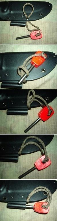

I was thinking. how does the fire steel remain in the kydex mold, once the fire steel gets used? Would it become too thin and slip out?

Ideally you want to use the same side of the firesteel up until you get near the center as this will gradually give greater surface area for the striker. The rest of the steel will maintain it's diameter enough to hold. That said, an extra insurance would be to have a loop through the hole that is just long enough to stretch and loop aroung the tip on the other side of the kydex.

It will take some time to wear one down.. However when it needs refitting it is fairly simple to do.. Heat up the back of the loop a little with a Bic,,keeping the flame moving over the tube,,when it starts to get warm,,pinch the back with your thumb..Before it cools,,insert the steel and redo until you get the right fit..
MC is correct on the tether..
He's a demo pic one of my customers did for me..
Hope that helps...

I had some sheaths made for my son and daughter with the firesteel attached to the front. All the tension is on the handle not the steel:
That's good advice...if it's important enough not to lose, "dummy" cord it! It's cheap insurance to keep from losing any of your essentials.

Rock6, that looks like the most secure spot for a firesteel.
It is pretty good, but I'm going to dummy cord the firesteels to the sheath (may have to drill a small hole). As Normark pointed out it's simple insurance and even though the firesteel is quite secure in it's piggy-backed sheath a little para-cord is simple to double-secure it.
