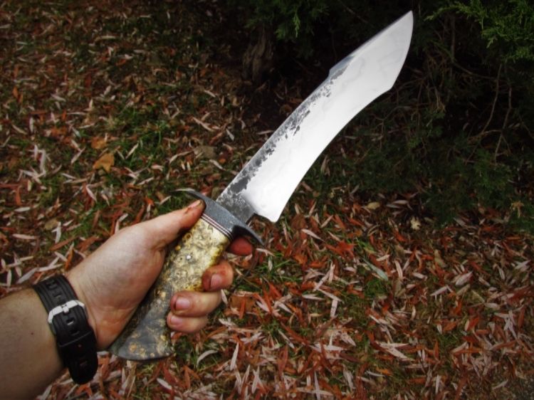

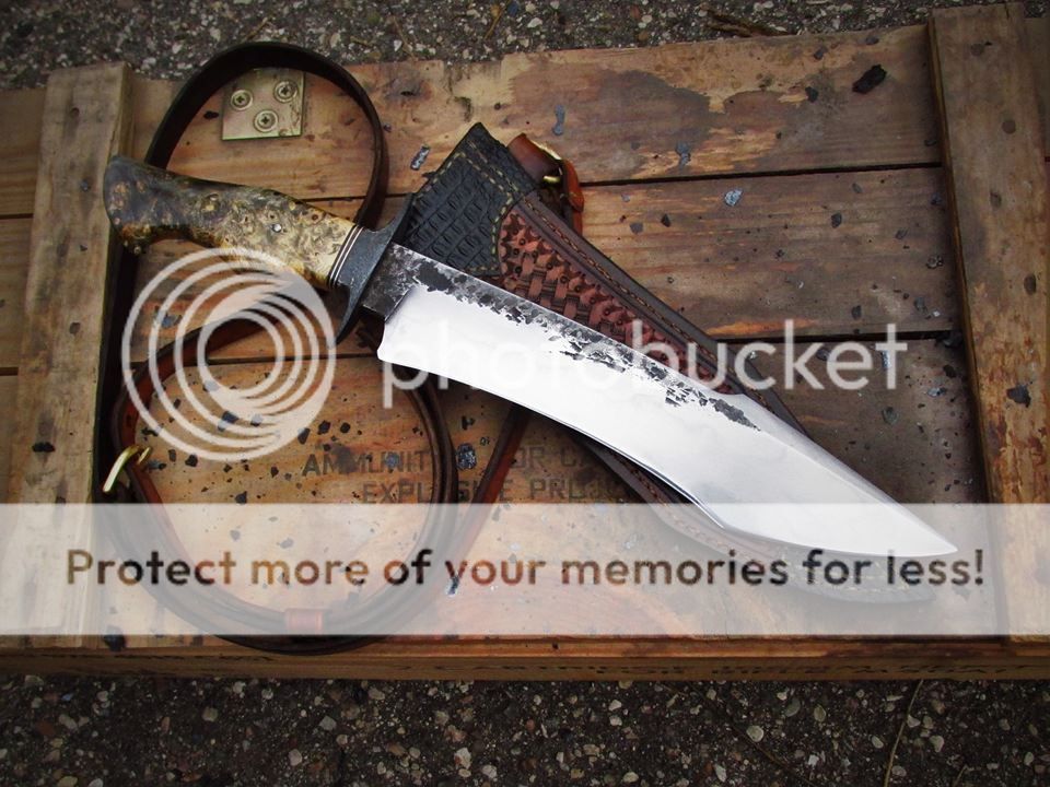

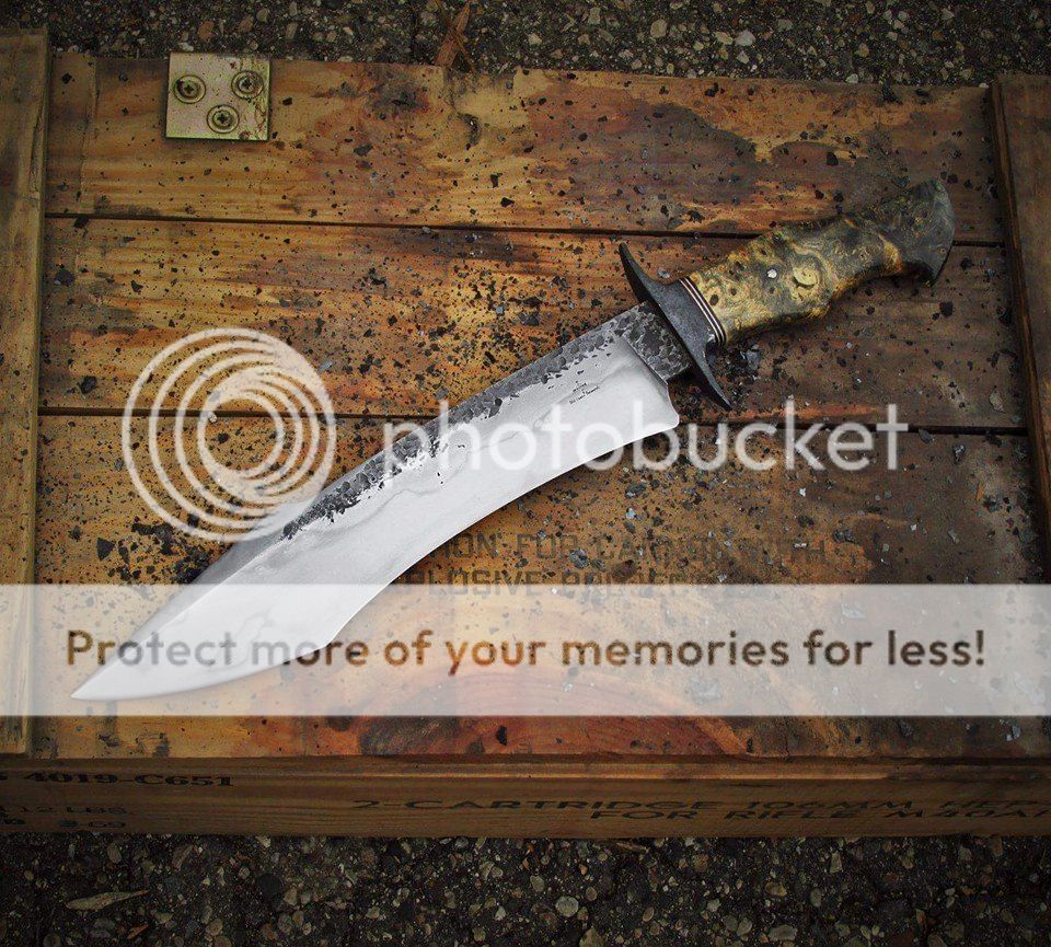

Here is one I am just wrapping up (no pun intended). I had the urge to do one more BIG knife before the year was out and came up with this one. It ended up going together very quickly with only 25 hours in the whole project. But as always comments and criticism are welcome.
Thanks for looking!
-Robert
Hand forged W2 with hamon.
Specs:
Blade length: 11 1/2 inches long
Blade Width: 2 1/4 inches
Handle Length: 5 1/2 inches
Over all length: 17 inches long
Guard: Forged and hot fit 1020 mild steel
Handle: Leather/ stainless steel spacers, stabilized buck eye burl with domed stainless steel pin.
Also this knife features a crowned spine.
Side view:
In hand:

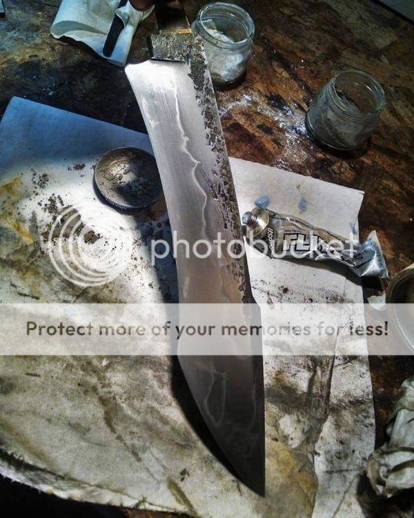

Hamon:
Wow, I like everything about this knife, esp. the handle shape and blade profile.
The last image is very dramatic showing details of the Hamon.
