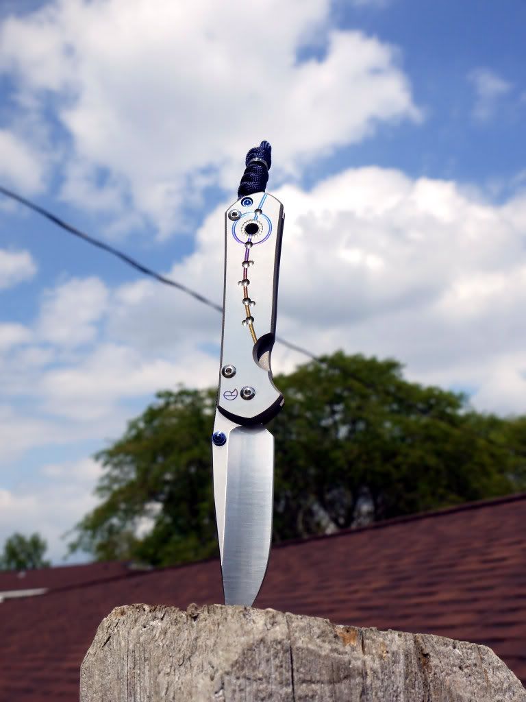

By the way, here's the picture of my new one.
Best,
That's a great picture of a really great knife!:thumbup: Huge congrats on that bub.
As far as lock up I think 80% to 90% might be to far? I'm not positive, but I am sure more of the experienced members will chime in. I really just wanted to say you've got yourself a beaut! :D
If you want to know about your lock up in a hurry I say go to the source and give CRK a call. They'll let you know what's up :thumbup:

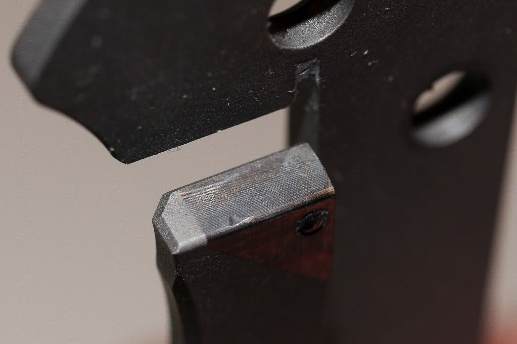

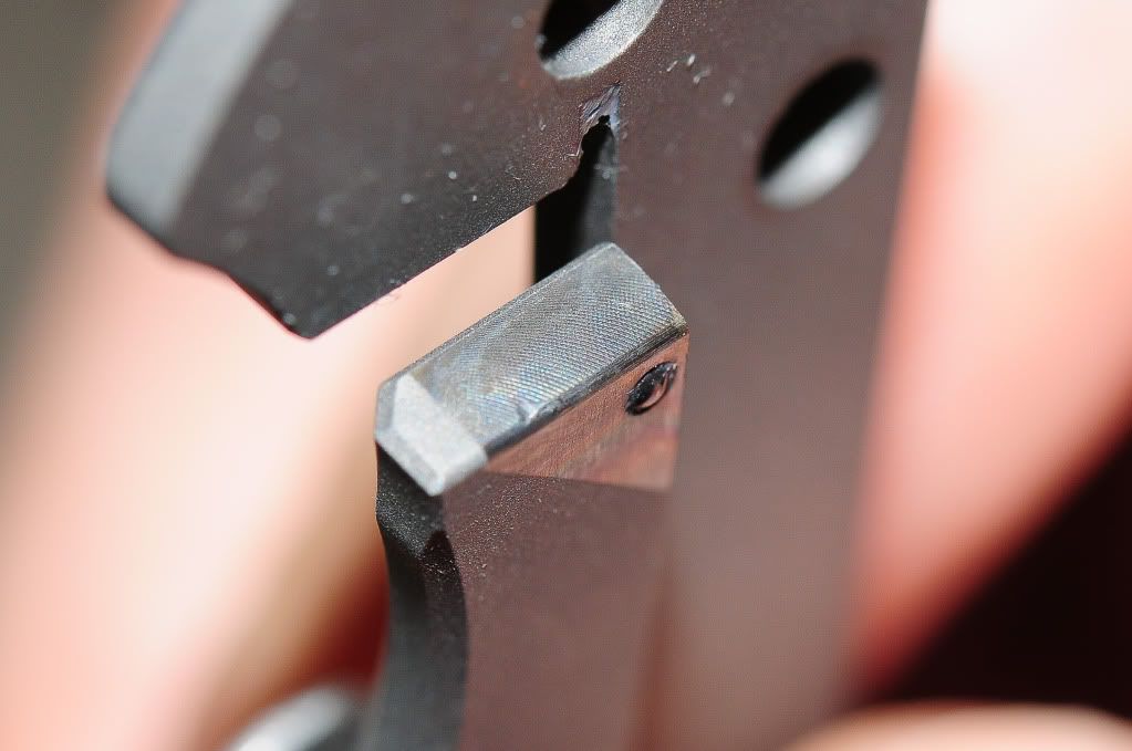

Here's a quick question that I am very anxious about. While I was cleaning the knife, I noticed that there was a little tiny dent on the surface of the lock bar. You can see the pictures below. I'm wondering if it is a normal dent or not. Do you think this type of dent is common? Or do you think this dent has to do with my problem? I mean, can this type of dent happen on the 3 day-old, brand new knife?
In fact, I was very worried about the lock bar, I sent an email to CRK right away last night. But I thought that it might be useful to listen to your opinions too. When I hear from CRK, I'll also update here.

That lockbar looks like it's almost checkered. Mine are smooth. That alone could make the lock tough to open
I remember mine and some I've seen (in pics here on bf) were smooth, not checkered
the "dent" is not nice to see, actually (but not sure it's a big issue even if I don't like it)
one thing could be, the tang has a bad/steel grind and is making bad contact with the lockbar, I had a small insingo I sent back as it was very lightly sticky and came back perfect but I don't remember any dents
CRK may say to send it in to fix the torched part
Maxx
With bare eyes, you won't tell if it is checkered or not. It just looked smooth to me at first. However, with the 60mm zoom lens, it turned out it is checkered.
As Maxx said, I hope CRK reply to me as soon as possible with a definitive answer. Maxx, I think you're probably right. The tang must be the culprit.

as said on my small insingo the tang was steeper and ground rougher, send it it, came with a bit more % (obviously) but stickyness is gone
its ALWAYS a matter of geometry, pure and simple AND anyone can make errors :thumbup:
CRK warranty will make it right for you for sure if it's few days old and given the quality pics you can supply. It'll be worth the relatively small outlay in cash to have Chris make it work right.
I sent a 2 day old inlay large 21 in for opening/closing problems not too long ago. The knife was repaired and sent back to me that day after they got it. Works like butter - as they say around here. I'm sure you'll be well cared for. ;)

Can't wait to hear what they say, or what the fix is. excellent images of the lock bar face. Almost, looks like some form of peening, to adjust the lock to blade engagement never seen that before, a couple thousandths of and inch goes a long way. Hope you get a perfectly functional Sebenza back, looks fantastic.
