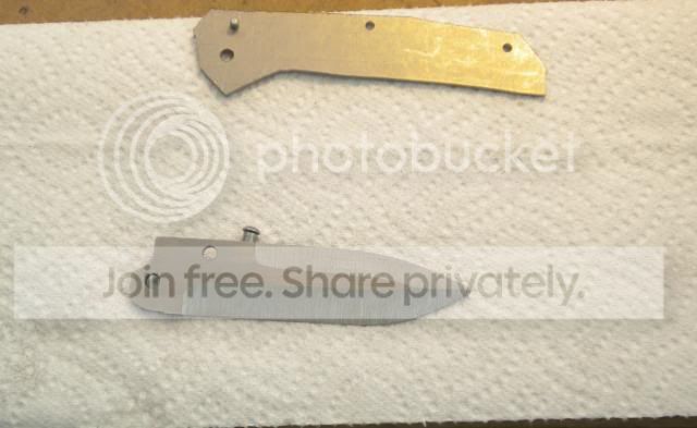

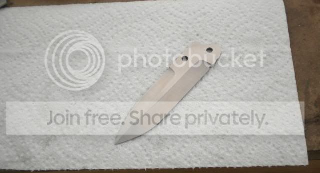

The rough profile of the blade and liners, with the holes drilled undersize and then reamed to size. The blade is .125" precision ground 154CM (it's really a few thousanths over, which allows the flats to be finished), and the liners .08" thick titanium. The dimensions and hole placement were taken from my shop drawing.
The edge is also coated in layout fluid and scribed for a .030" thick edge, which I will thin out as the finishing progresses. The lockup area on the blade is also ground at a 10-degree angle in this step and polished down to 400 grit.

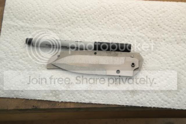

Rough grinding the blade bevels in by hand, for the cutting edge and false edge on top. They are taken to 120 grit here for now.
The roughed in bevels, and the flats are also carefully sanded- just enough to get an even scratch pattern on a ceramic plate attachment. The blade thickness measures around .127" now, and should be perfect after the final polishing. Calipers and micrometers are handy things to have when building a folder!

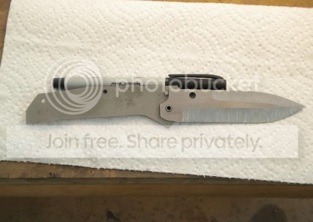

Checking the fit in the open and closed position. I leave the stop pin surfaces on the blade oversized at first and remove metal slowly to get the fit I want. This is done with the blade between both liners, one is removed for clarity. If your holes are not straight and round, it will usually show here.

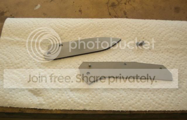

The blade, bevels and flats polished up to 400 grit and ready to ship to Paul Bos for heat treating.
The blade is back, and is hardened to 58-60rc. Paul Bos does an excellent job, the blade is nice and straight and ready to finish. The liners are final shaped and polished up with sandpaper on a flat surface, and the materials are all here. Time to assemble!

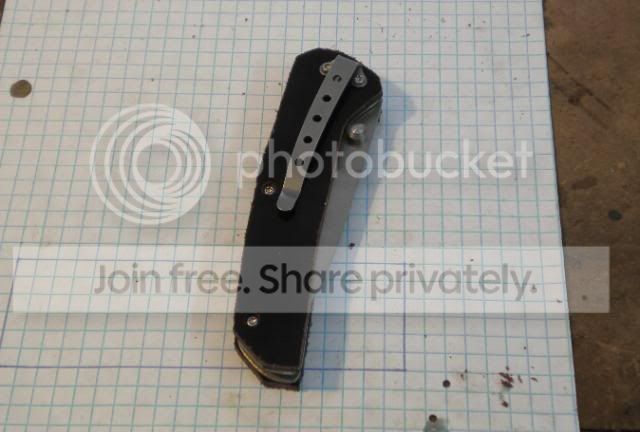

The assembled handle scale is also drilled for the pocket clip, and the liners tapped for the screws. These holes in the scales are drilled just large enough to clear the pocket clip screws, and the whole knife is assembled for another check.
Everything checks out, so I remove the blade and put in its its place a spacer- a small square of the blade material scrap with a hole drilled for the pivot. This lets me shape the handles together and keep them the same size.

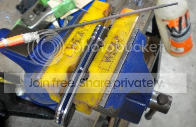

Once the handle is rough shaped, the thumb grooves are cut. I use a file by hand, but the mill works also. Grooves are also cut near the butt of the handle for the thumb when holding the knife in a reverse grip. The grooves are polished up with sandpaper once they are even and straight.
The rough ground scales, and liners with the lock bar cut. I cover the liners with tape to avoid scratches in these final machining steps after they are polished. I cut my locks in with a 1/16" or 3/32" diameter TiN coated carbide end mill using my Sherline variable speed mini mill.

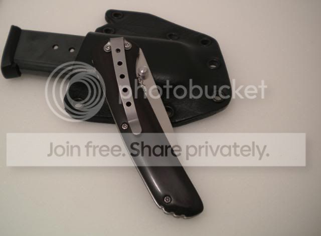

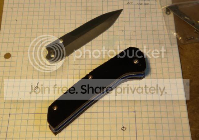

The scales are finished, the lockbar hand fitted, detent ball is pressed into place, and the blade is polished and etched. Everything is ready for final assembly.

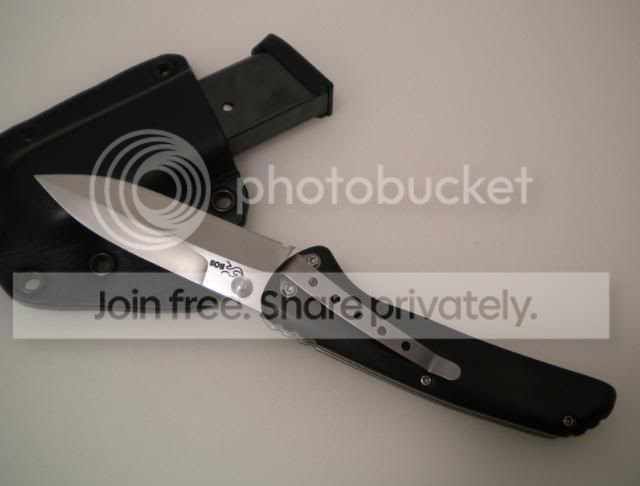

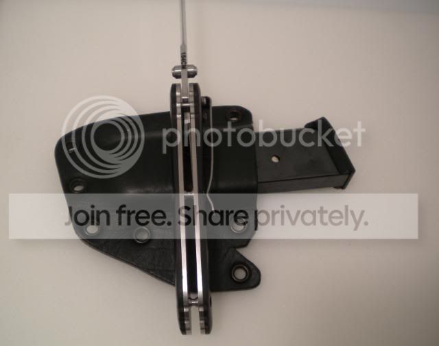

The almost finished knife being sharpened. You can also see on the lock the filework I added for a sure thumb purchase. Once the edge is hair-splitting sharp, the thumbstud is installed and it's finished!

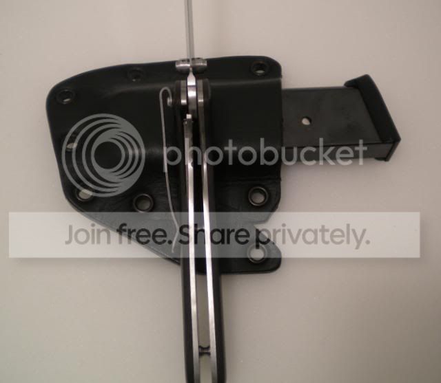

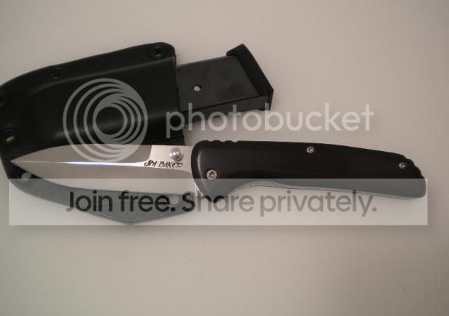

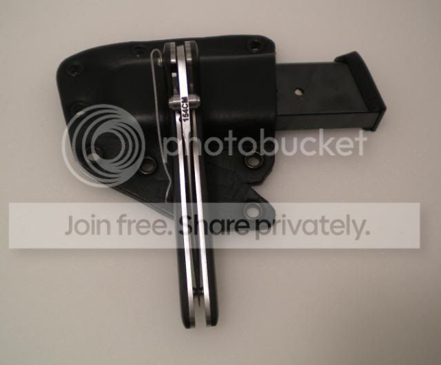

The finished project, ready for its new home! The lockup is solid and free of play, and has plenty of engagement but still has room to cover eventual wear. The blade is held securely closed by the detent but still flips open easily, and the blade is centered in the handle when closed. The handle scales are actually maroon micarta, but the color was so deep that it looks almost black in the pics.
A very nice knife- I was very happy with it, and more importantly the owner is as well:D
