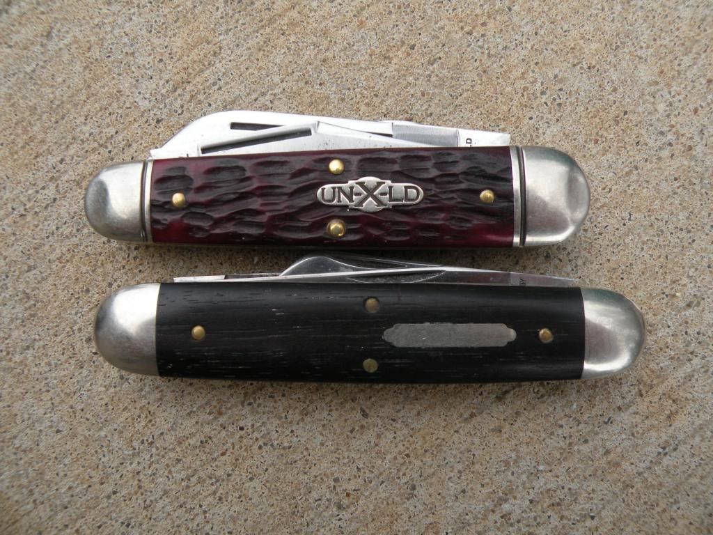

Well I have had the pleasure of carrying around these two knives for awhile now and felt I should do a little comparison on these hard working knives. First lets lay out some specs to compare the two. (all measurements are approx.)
#53:
3 blades, 2 springs, 4 1/8" long, 9/16ths thick, 1" tall
Main blade and coping have their nail nicks on the mark side, spey on the pile
Clip - 2 3/4" usable
Coping - 2"
Spey - 1 3/4
#79
3 blades, 3 springs(half stops), 3 3/4" long, 9/16ths thick, 1 1/8th" tall
Main blade and clip share pulls on the mark side, sheepsfoot on the pile side
Spear - 2 3/8" usable
Clip - 2 3/16"
Sheepsfoot - 2 3/16"
The stats speak for themselves. If you are purely after blade length to frame ratio, the #79 would be your choice. On the other hand if you are looking for a frame thats big enough to choke up or down on, the #53 is perfect. For me I have found 3 3/4" frames are the perfect fit for my hand. I can cut sheetrock comfortably with the 79 and I think thats my new standard for testing, scoring and processing pieces of sheetrock gives me quick feedback on weather the frame is comfortable for hard use. I feel both of these knives excel for me at that task.

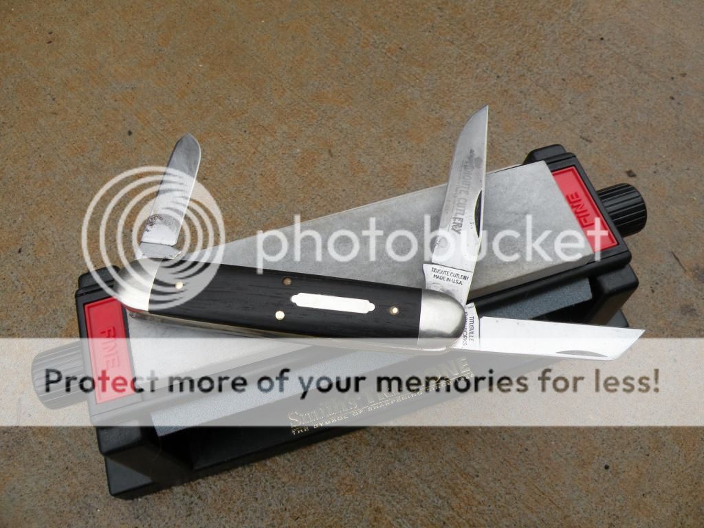

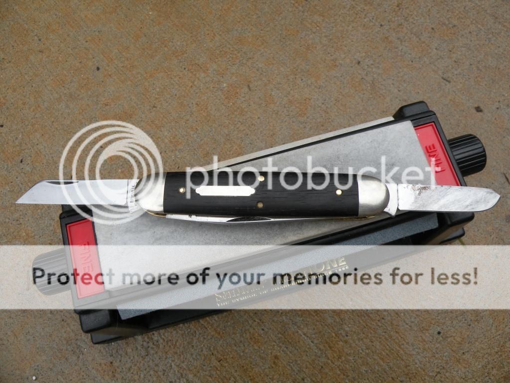

These last two weeks I have gone without sharpening the 53. I put a hair shaving edge on all three blades to start. I was very impressed with the performance of the steel. GEC's 1095 is perfect in my opinion, dont know what it rockwells at but it is not too soft and not too hard. At the end of two weeks the blades where dull but still cutting stuff just took a little extra effort. Well this Monday(the last day I used it) I forgot my tool bag in my personal truck :sorrow:, luckily my boss was working with me that day so I did not have to turn around. Anyways I did not have my utility knife with me so the 53 was going to get some pretty tough tasks thrown at it. And honestly this is part of the reason I carry this knife, I dont want to use it super hard but can if I need to :thumbup:. About mid day I needed to cut some 1/4" foam for templating a shower wall. Normally the blade slices through that stuff like its air but without sharpening for 2 weeks it was dragging, hanging up and ripping it a little. I had to lay into it hard to get it to cut clean. To make maters worse the easiest and fastest surface I could use to cut on was tile. The belly on the spey was already dull and after this it was rolled but was still cutting stuff, just not very well(good for rough tasks). The coping blade got used a few times for this job as well and saw other use notching a piece of wood and shaving sheetrock etc... After the day was done it had a few little chips I could see near the tip. The clip blade still being razor sharp was used whenever I really needed a clean fast cut. I was pleased to see the 53 could make it 2 weeks of constant use and still perform, marginally yes, but still going non the less.
I gave it a break yesterday and carried the 79. My boss needed it to cut some foam and couldnt believe how well it cut(he is a Case guy, trying to convert him). Glad I have such a capable combo and a backup when the need arises and life gets in the way of me sharpening up my go to. Well just a few minutes ago I grabbed the sharpener and decided to see how bad I had screwed these blades up. Now I use a Smith tri-hone, nothing fancy and use the backside of my leather belt to strop it on when I am done. I think I spent less then 5 minutes per blade for the spey and coping. The roll of the spey came out with just a few passes on the coarse as was the result when removing the chips on the coping. Just a few passes on the rough and I was on to the medium in no time. I think I spent 30 seconds touching up the belly of the clip as it was the only part not still razor sharp. I was very impressed with these results. The 53 got a good flushing, cleaning and oil job. It looks and feels brand new now and ready to tackle anything 2013 throws at me :D

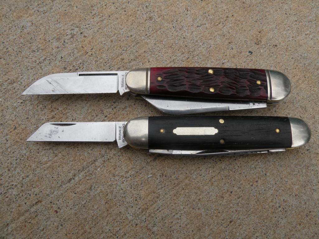

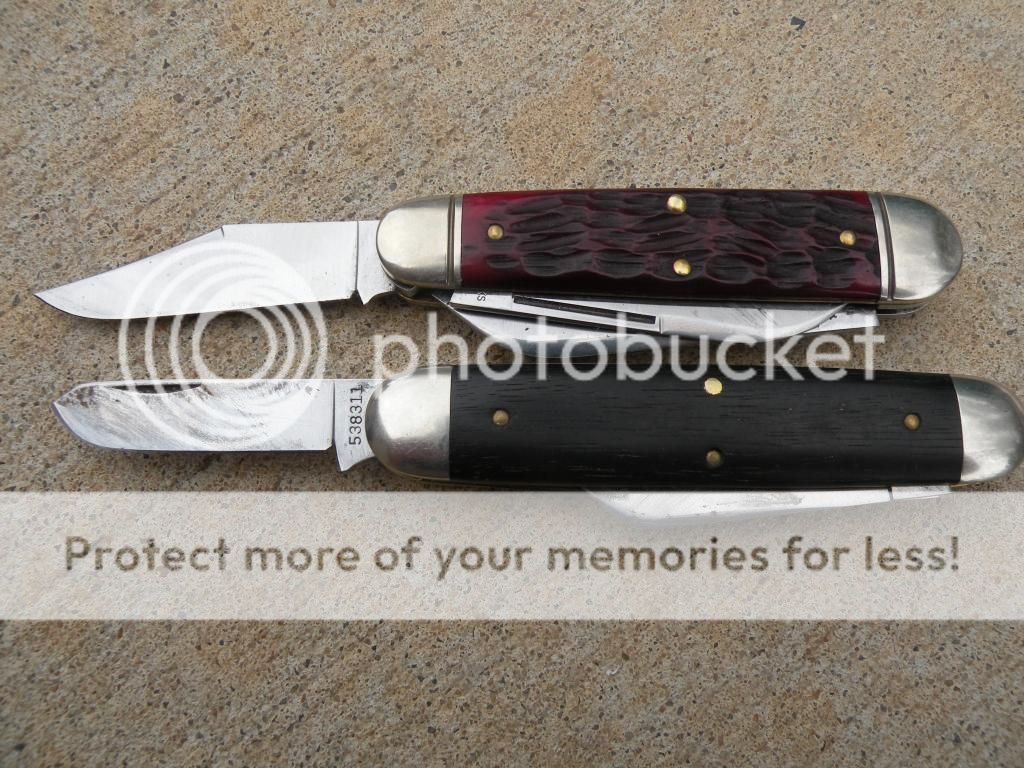

Well, lets take the main blades of the two knives - spear blade for the #79 and Muskrat clip for the #53. The spear blade is a broad blade with a wide spine. Perfect for making that last 1/4" or 1/8" of radiator hose, hydraulic hose or heavy branch/piece of wood where you need to wobble/twist your wrist in order to make the final cut. The narrow Muskrat clip of the #53 is too fragile for this type of work. As to the sheepfoot (could be called a sheepcliffe) blade of the #79, it is fairly stout - stout enough to make a good scraper on a hose flange, vise ear, square the end of a reinforced radiator hose etc.. The sheepfoot on the #53 is a bit short for my taste. The clip blade of the #79 is just there as far as I'm concerned. Very thin as the OP stated but has a slinder, delicate point for good penetration on clamshell packaging, and your finger should you get careless. I'd sum it up by saying that the #79 is a great knife for farm, ranch, commercial shop, heavy home shop, and garage use. The #53 can accomplish those tasks but is a bit lite for really heavy stuff.
#53 Stockman
#79 Whittler (not a true whittler in the collector world sense)
The #53 is a heck of a work knife but the #79 will work rings around the #53 any day. Of course - my .02¢
This #79 is in my pocket almost every day now. It's just a great work knife for the property I live on and to have around for general heavy duty use.
Uploaded with ImageShack.us
ED, I welcome and respect your opinion. Certainly agree with you on the main blades. If I had to choose I would take the broader, thicker spear of the whittler and transpose it onto the 53. I just dont think it would feel right on the knife but in theory I would be on board. I also agree with you when you say "The clip blade of the #79 is just there as far as I'm concerned.", although it is nice to have a very thin slicer. It is becoming obvious to me that any three blade knife I own will have one blade I barely use but leave it laser beam sharp for when I really need it. I am sure I could combine aspects of these knives to make MY ideal EDC, ill save that for another post ;). Thanks for the comments guys, always welcome :)
Heres a few pics I just took with it on the sharpener outside.
