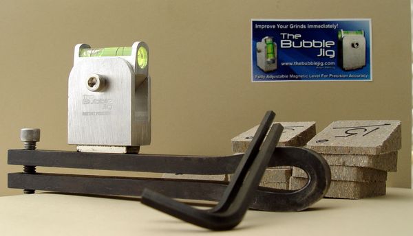

Excuse my ignorance but what exactly is this angle wedge you are referencing here?
Hi,
These are from fred.rowes
Those wedges don't look pointy enough , the ends are too thick,
lots of blades would come off the wedge before contacting the stone,
like a mini clothes pin on a swiss army knife blade,
but those things are much thicker than the mini clothes pins I have
Now this is pointy
Maybe fred.rowe has pointier wedges for use with knives directly ...
