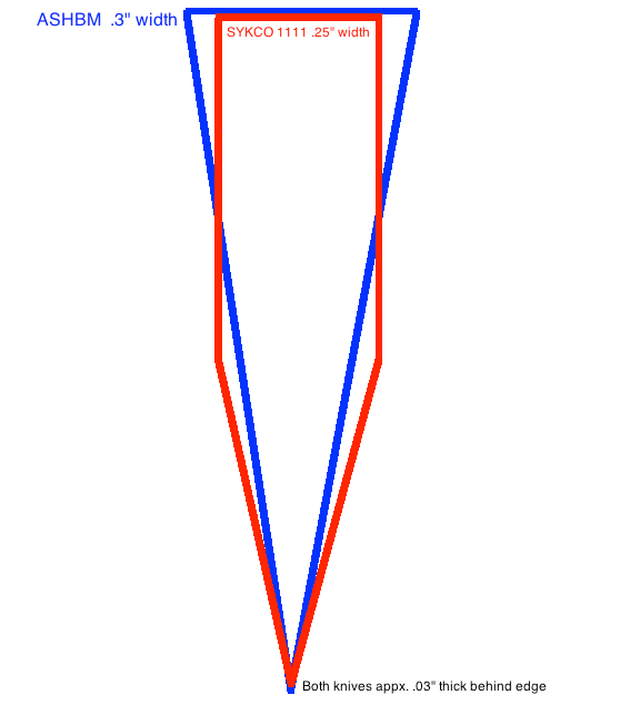

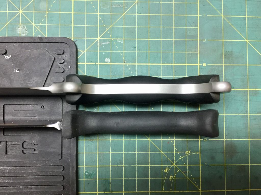

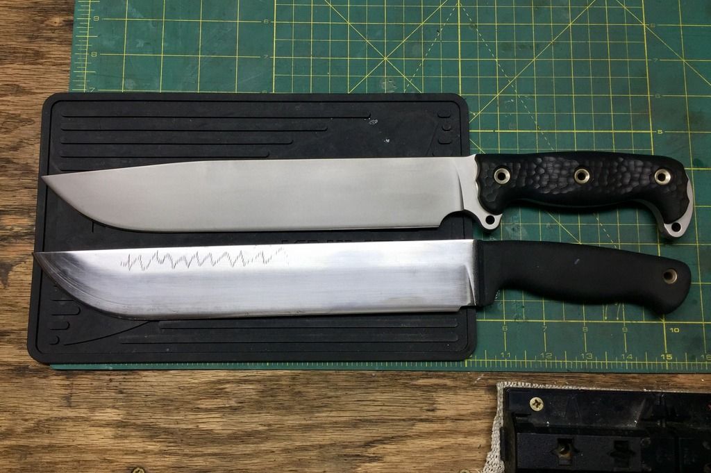

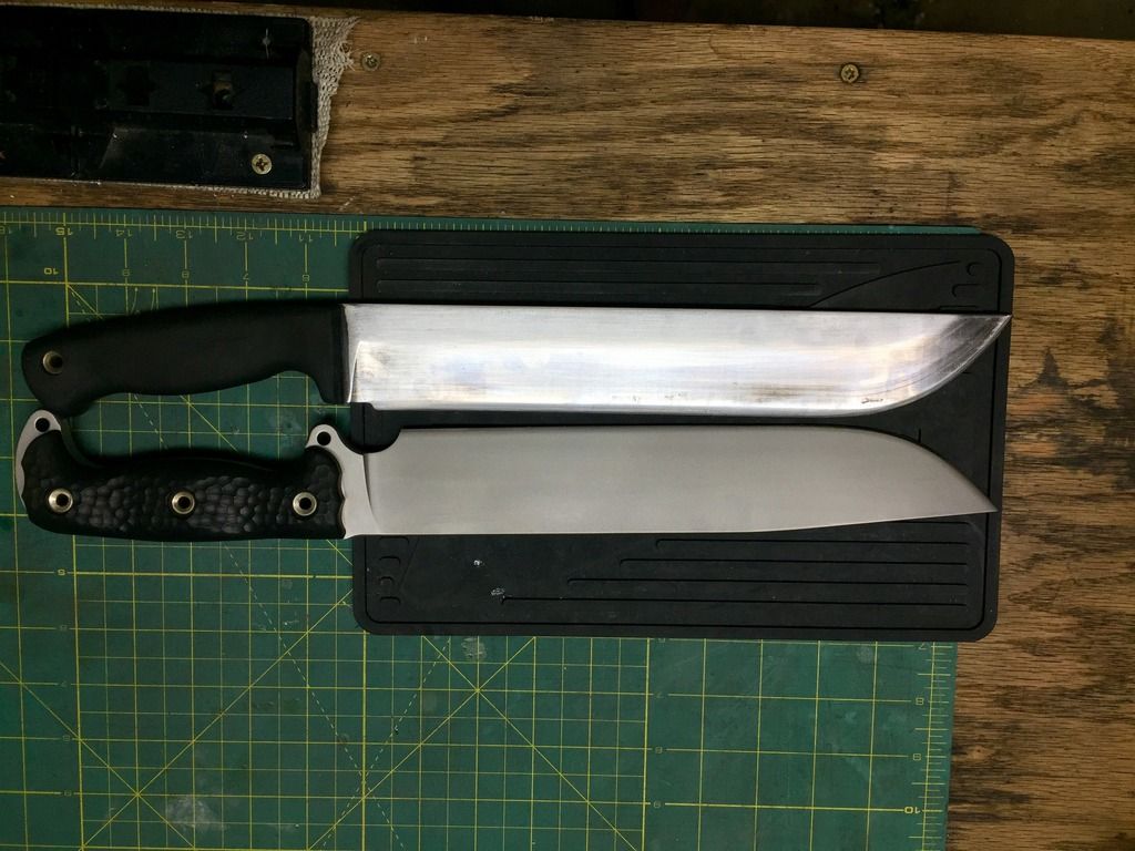

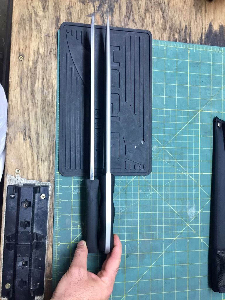

I'd always thought of the 1111 as the "poor mans battle mistress", I think it was Legaleagle who first told me that. As you can see from the pics, he was pretty spot on.
So after measuring the ASHBM a bit, next to my 1111, I think I understand how a thicker blade can bite much deeper. I'll spare you too many caliper pics,, but here is a crude drawing of my findings.
Like the wise Resinguy has told me before "geometry cuts, geometry cuts, geometry cuts, what I tell you three times is true"
Someday I'll get around to sending the 1111 off for a reprofile,, I think it has A LOT of potential with a little regrind..
Cheers
The 1111 really is an awesome knife. I really like it's chunky feel and beefy blade, even if it doesn't bite the way it could. I pair mine with a saw for camping. The thicker geometry splits like a motherBEEEEEEEP and it certainly chops well enough for me to keep it around :)
That's a great little mock up you've made of the knives cross sections and observations on their ability to BITE! Nice work Ready Cooked Bacon :thumbsup:
Oh don't get me wrong, that 1111 is no slouch as is!
Plus those shoulders should make it better at battoning than a flat ground blade, as well as add some lateral strength.

Imagine that 1111 with a full flat grind, or even just the original bevel transition knocked down significantly.
