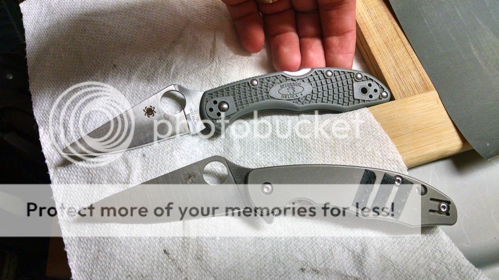

I've been wanting to straighten the spine on my Spyderco Mantra for quite some time.
I could appreciate the design as is, but spyderco and aesthetics is such a personal thing I just couldn't get used to it. In my mind the mantra builds on a Delica platform, that has a straight spine, and also carrying my PM2 I'm just used to this particular style of spyderco.

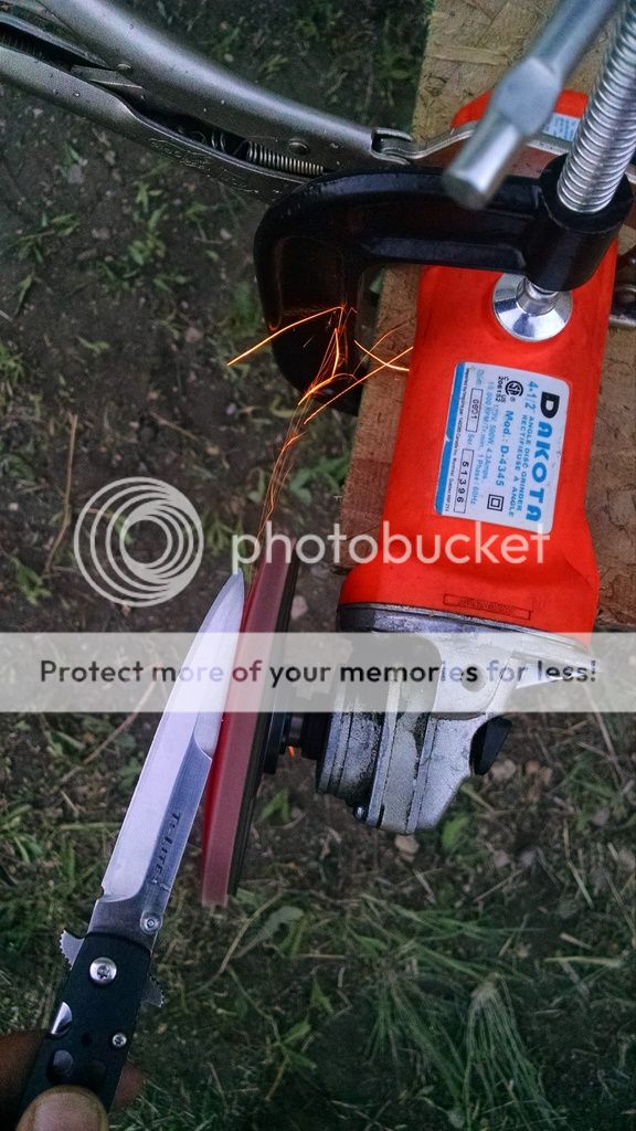

Decided I am going to use a grinder and bought a 60 grit ceramic disk. It was pretty similar in price to everything else I saw and I wanted something that could take on the M4.
I thought ceramic spyderco rods so it just clicked. These small individual segments of the disc are somewhat like a beltsander.
My setup looked like this utilizing all the clamps I have. Safety first. This proved to be a sturdy throughout the whole procedure.
I tried it on a CS knife that I like to abuse. The way the grinder is oriented makes the sparks fly away from me and the pivot. Also, the clamp created an unintentional spark guard
This grinder was missing a couple parts like the inner flange
. I couldn't find it so I used 2 outer flanges. It works out with this kind of a disc.
Proof of concept was established to me at this point so I went back to the drawing board.

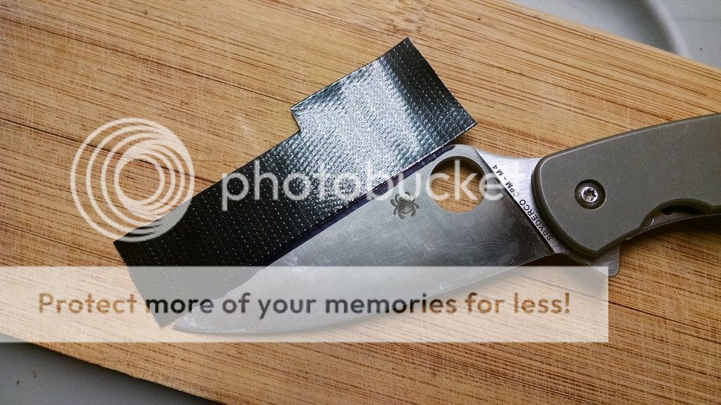

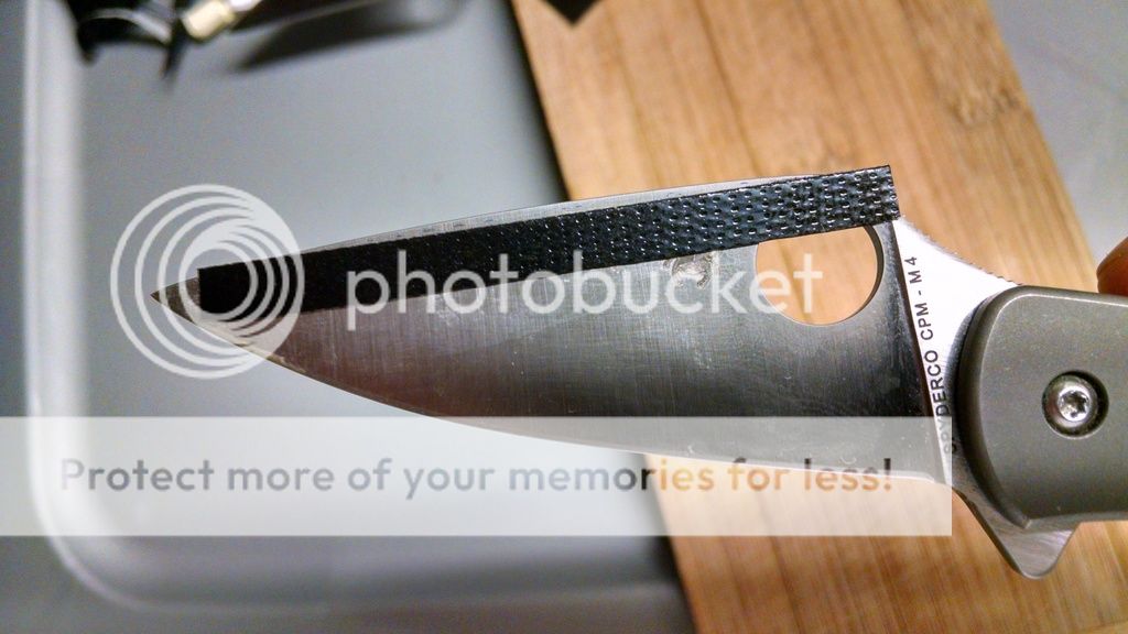

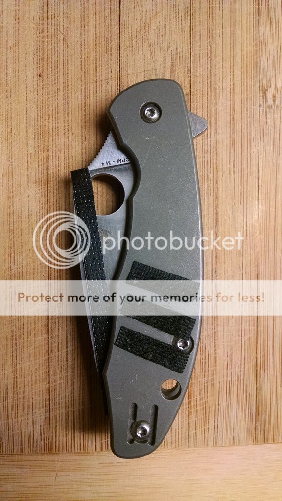

I used gorilla tape and placed in on the blade to have a visual reference.
then when I was happy I marked it with a marker.
Took off the tape and put another tape with straight edge to provide me with a straight line visual.

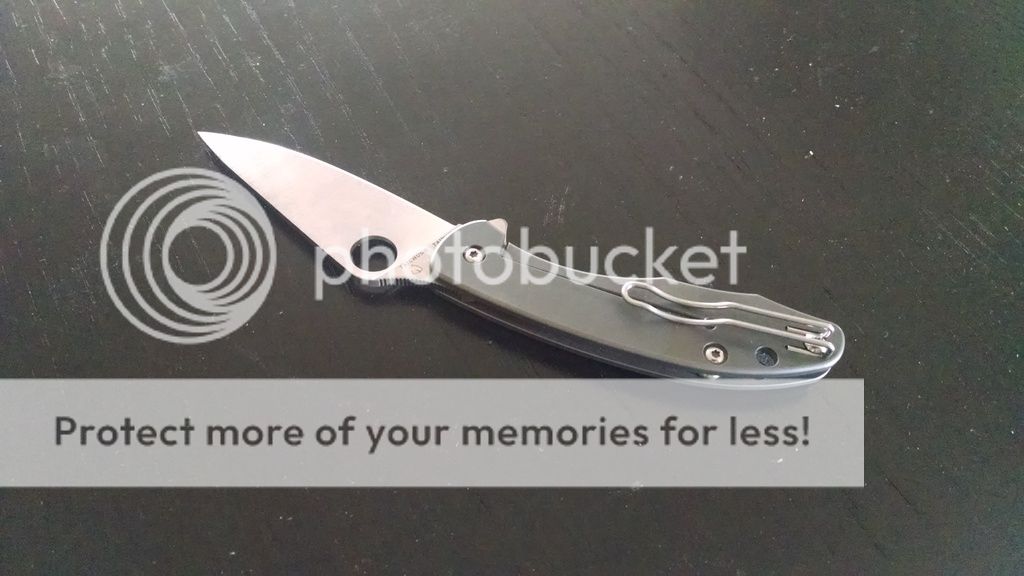

It was going to be so much slimmer in the pocket now
Then I just went to town.

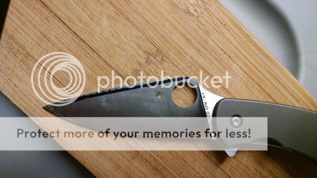

This tape survived numerous dips into the water to keep things cool. It was also easy to inspect the progress, just had to flip the knife and look at the opposite side. I ground it more after this picture was taken, almost to the tape, with a bit of silver still showing. This M4 steel didn't throw any sparks compared to AUS8 and took a lot longer. I wasn't rushing it and made sure it wasn't getting hot.
Came out pretty straight from the grinder. I tried to use the corner of the grinder at some point and that was a mistake, as I did touch the underside of the blade and it left a small mark.

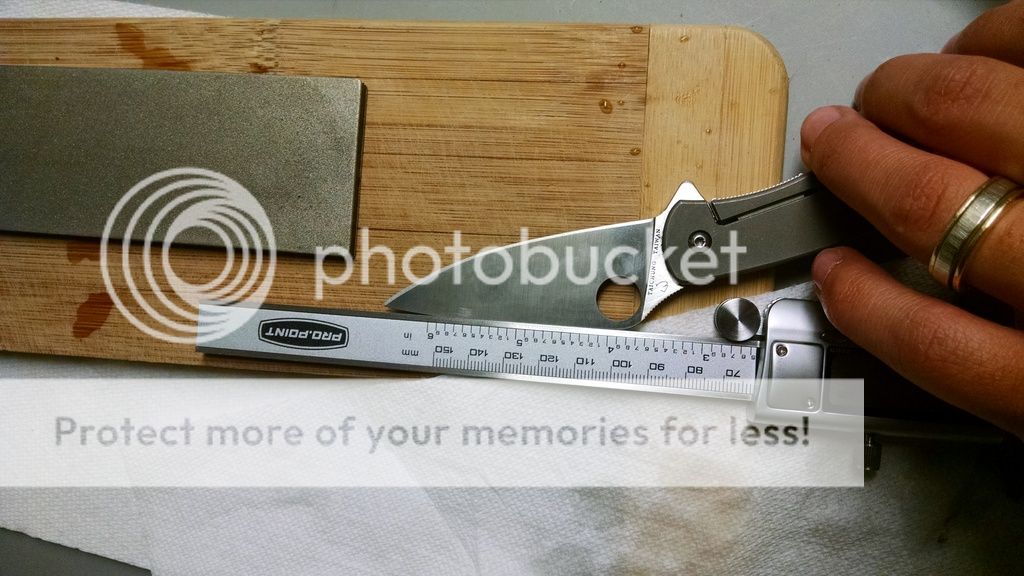

Next day the perfectionist in me decided to make it as straight as possible.
So I ground it a bit on a diamond plate from china. It's probably 400 grit
I did a bit of work on that drop towards the tip also and finished things off with 800grit sandpaper.
I like the little drop at the end that was created. My thought was if I don't like it I can always take away more material. It has grown on me, a true delica successor should have one
