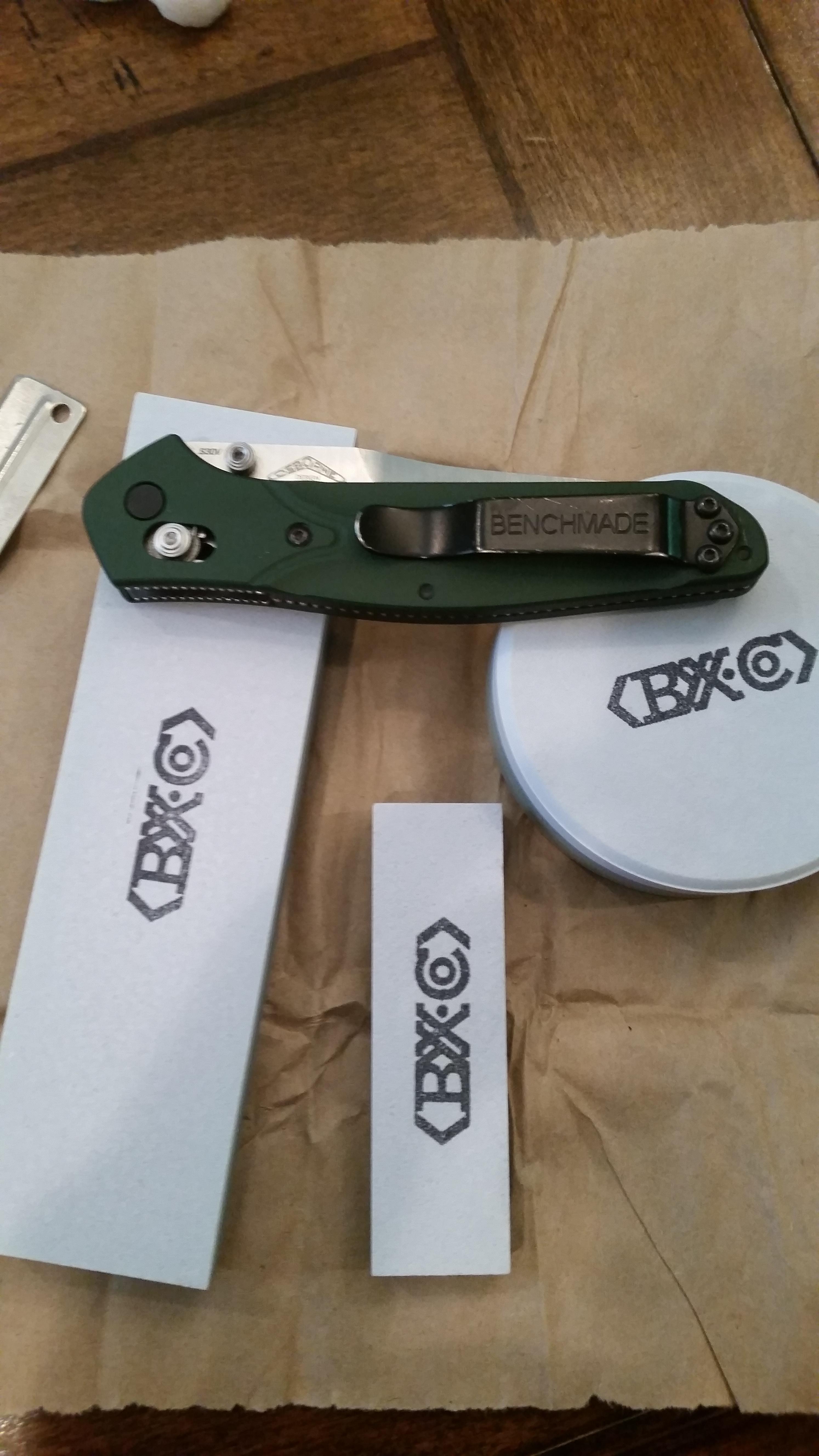

Just got some new things in the mail, I set my knife next to them to reference size, I can't wait to try them out!
I haven't got the Manticore but it does seem like something I will get in the future.
I picked up the Arctic Fox scythe stone also, will be interesting to see how I like it as I've never used a stone shapes like a canoe before. I wish I had some recurve blades now, one of the main reasons I don't have any is because of the sharpening dilemma. I guess now I have a reason to pick up a knife or mod one of my knives to be recurved now.... :)
