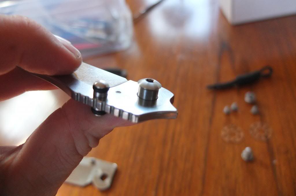

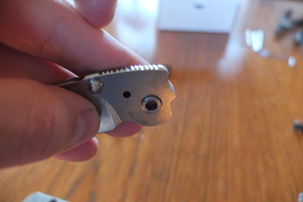

First up: The 21 pivot (bushing)
Here is the myth I would like to dispel: "the 21 has the smallest pivot". The 21 pivot is not the screws! The 21 pivot is the bushing!. Glancing at the outside of a 21 in comparison to a 25 or an Umnumzaan is not the whole story! The screws only serve to sandwich the bushing between the TI slabs and are not part of the rotation of the blade. The 21 bushing is identical in diameter to both the 25 and Umnumzaan pivots, so has similar properties as far as the notes I have listed above. No normal human could shear through the screw and sleeve that pass through the bushing when using the knife, so I feel the strength of the screw and pin sleeve that pass through the bushing is not the greatest factor in this pivots strength. What is very important, in my opinion, is that the 21 bushing is firmly held between the TI slabs (sandwiched), and that those slabs are very rigid due to both the pivot screw and the stop pin screw being so close to the pivot bushing. Unlike the 25 and the Umnumzaan, the 21 bushing is butted up against the inside of the Titanium slabs (the bushing is larger than the screw holes in the slabs). I suppose my point is that unless you think you are going to press so very incredibly hard on your 21 that the blade shears through the bushing screw and sleeve, the 21 bushing pivot is a very strong and robust system, equal or greater in strength to that of the large screw in the 25 and umnumzaan. The ultimate goal of the interface of the slabs and the pivot is not to allow the blade to be torqued to one side or the other. Both the pivot screw and stop pin on a 21 are working to keep the pivot bushing true and square, and preventing deflection of the blade.
Photo of a 21 bushing in a 25 blade
Photo of a 21 bushing in an Umnumzaan blade

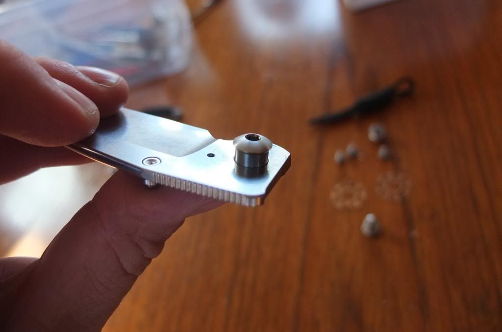

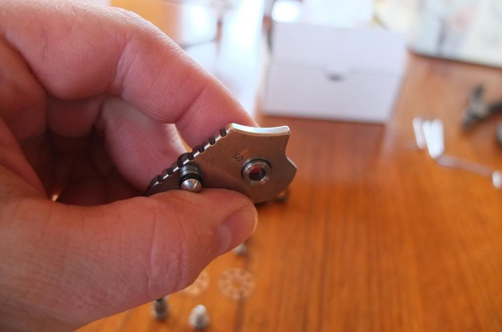

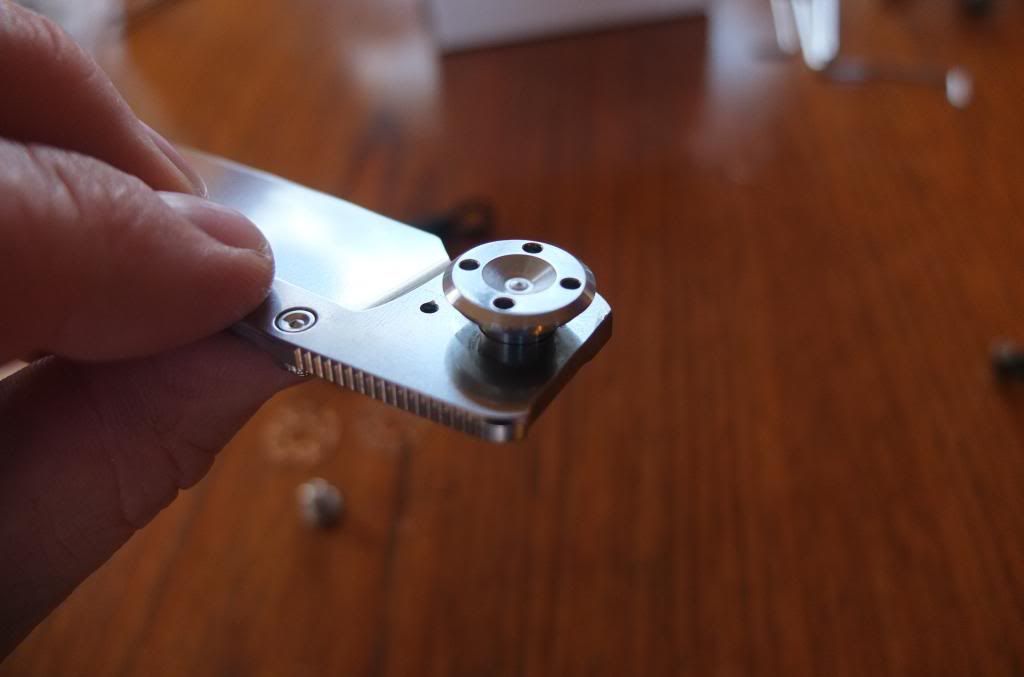

Second up: The Umnumzaan Pivot (old style):
Again this pivot is identical in diameter, to both the 21 pivot bushing, and the 25 pivot screw. The primary difference is the the umnumzaan (old style) pivot screw has side bolsters that sit in machined pockets in the slabs. I would argue CRK added these bolsters to make up for a percieved lack of strength due to the Umnumzaan having no stop pin to assist in the "sandwich effect' that the 21 bushing benefits from. In the case of the Umnum, the pivot passes right through the slabs, so it needs something to help prevent sideways deflection of the pivot. The thickness of the TI slabs, resting against the screw in not enough. By adding these wide bolsters to the pivots screws, CRK achieves some torsional stability if the blade is torqued left or right, that otherwise could be provided by the bushing being butted against inside of the Ti slab, like it is on the 21.
Photo of Umnumzaan pivot in a 21 blade
Photo of Umnumzaan pivot in a 25 blade

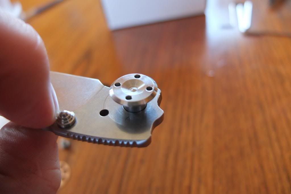

Third up: The 25 Pivot Screw
Again this pivot is identical in diameter to both the Umnumzaan screw and the 21 bushing. It does not have the large bolsters of the Umnumzaan (old style) pivot, but is protected from sideways torsion by the stop pin holding the slabs rigid. The screws themselves are counter-sunk so they have some of the bolster affect of the Umnumzaan old pivot. If my theories are correct, this would make the 'new pivot' Umnumzaan the weakest pivot of the line-up of CRK large folders (is has small bolsters, and no stop pin), but still likely strong enough for any human's purpose.
25 Pivot in a 21 blade
25 Pivot in an Umnumzaan blade:

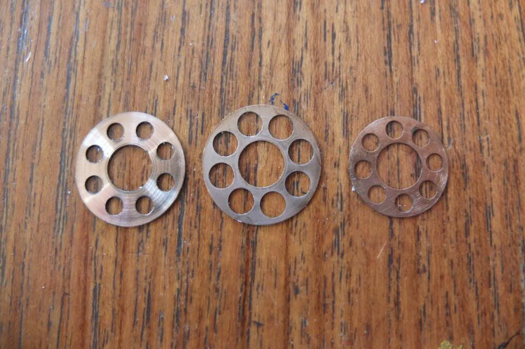

What was really interesting to me is that the washer are all proprietary to each knife, including the non-locking side washers. In this photo you can see a (left to right) 21, 25, and Umnumzaan washer. I know the 21 has a small washer on one side, and the 25 has the one with the tab, but you would think the other ones would be similar, but they are all unique.

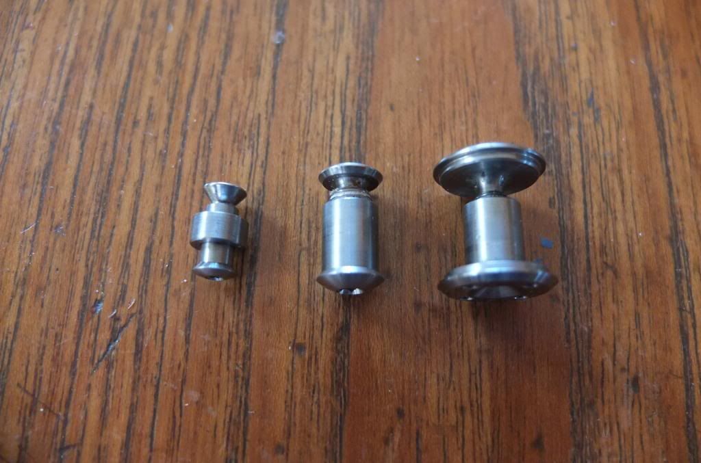

Here are the three pivot subjects lined up:

Nice write up KID... Very good thoughts and comparisons you have made here... With all that being said I agree that none of us could actually shear the pivots with out bending or breaking the blade and or lock face first.
Now I will add this.. That the pivot screw on the 25 is larger. So if taken into account it has a higher load/shear strength then the smaller screw of the 21. I think if it were possible to test the lateral strength of each pivot the 25 would take more lateral load then the smaller screw of the 21.
Thank you Kwazy, I would agree with you 100% other than the fact that the pivot bushing on the 21 is held rigid inside the slabs, which possibly helps it oppose the lateral forces more than if you had the smaller screw alone. All in all this is just my guesswork and speculation, and I think either of us could be right, and unless the knives were tested to destruction in some calibrated hydraulic press, we'll never know. What my point is is the 21 pivot has more to it's strength than the smaller screw, and it shouldn't be assumed its lighter duty than the other two.
Yes indeed kid... But aren't both held the same way in between the slabs??
Which would only say give more steel around the blade, but not making the screws any stronger. The diameter of the screw gives it more strength. Not the bushing. Which like I said adds more steel around the hole in the blade not giving more strength than the larger diameter screw.
