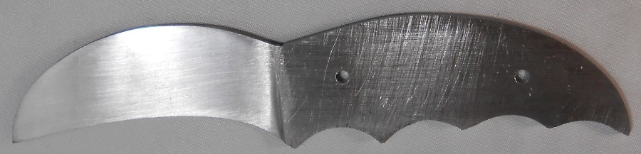

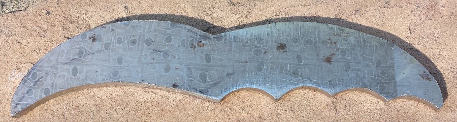

In another thread I mentioned that my sister requested a "talon" knife. I interpret that as a karambit without the finger hole. So I drew up the design on a piece of damascus, and she approved it. Today I cut out the blank.

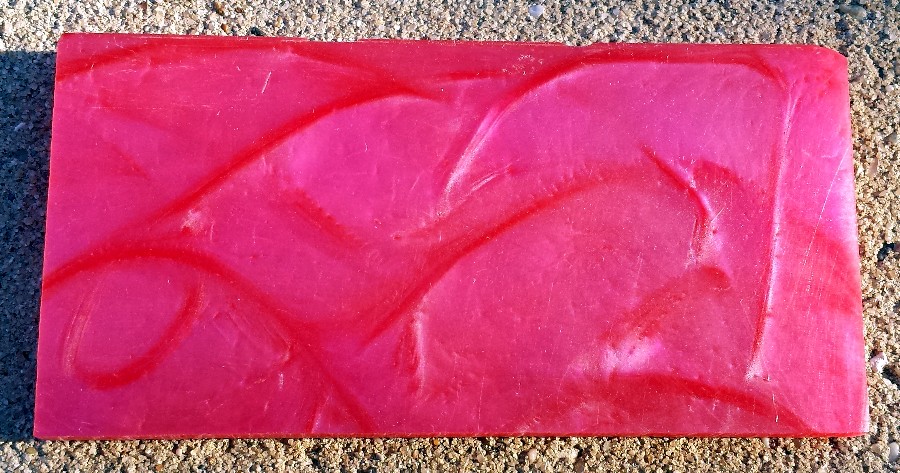

Then I asked her what color handle she want. Of the colors offered, two came from a box I received today from Texas Knifemaker... and she selected the watermelon PolyPearl.

Phil, I cut triangles off the billet with the band saw, then used the grinder to smooth out the curves on the top, and a round file to cut in the finger slots.

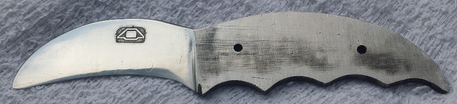

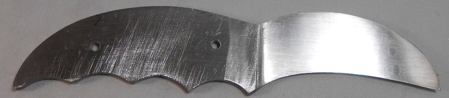

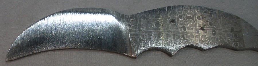

Finally got back in the shop today. I spent some time with files trying to cut in the bevel. I did a reasonably good job with the plunge, but I noticed that the bevels were badly concaved and had some dips, so I bit the bullet and went to the grinder. It came through the first phase of grinding better than I anticipated, given the awkward size and shape of the blade.

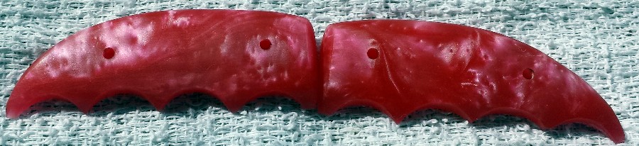

The last few days have been warm in Houston, so I haven't had much time in the shop. I did manage to hand sand the blade up to 320 grit in preparation for heat treatment. I also drilled the holes for the handle mount pins, and cut the coarse outline of the scales, and drilled the pin holes into the scales. So all in all I am making progress.

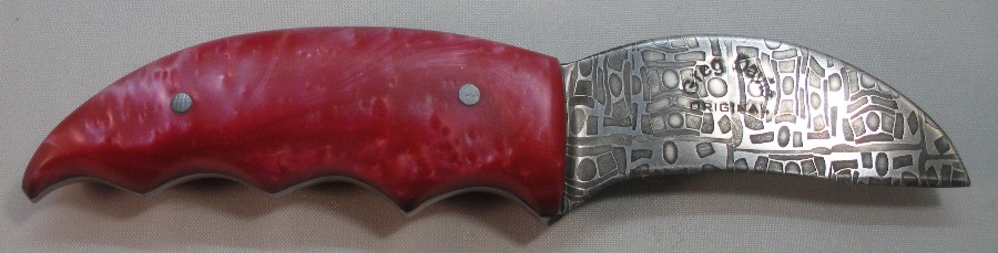

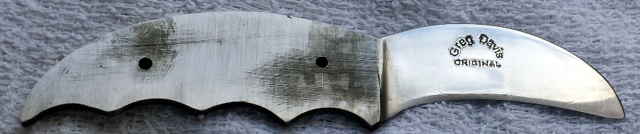

Today I finished the hand sanding to 2000 grit and marking of the blade. Still to be done, sharpening, etching, handle shaping/polishing and final assembly. I'm hoping to finish the project this weekend.
What may not be obvious from the images is the fact that I rounded off the top of the blade. This is, after all, a talon knife, and talons have rounded tops. ;)

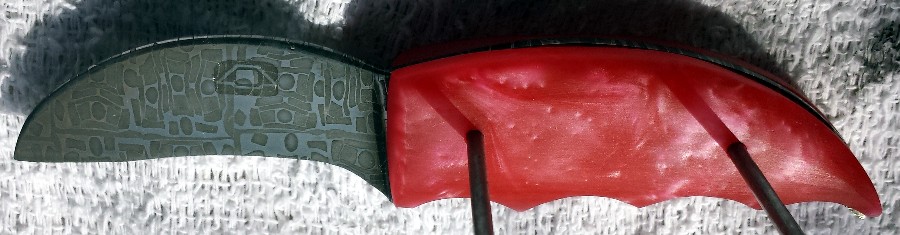

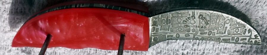

Before the heat of the day set in for real, I managed to sharpen the blade, etch it, and get the handle much closer to the final shape and size. Then I rubbed a little butcher block conditioner on the handle so I could get a glimpse of what it will ultimately look like. I'm pleased.
From here out it will be all hand sanding and final assembly.

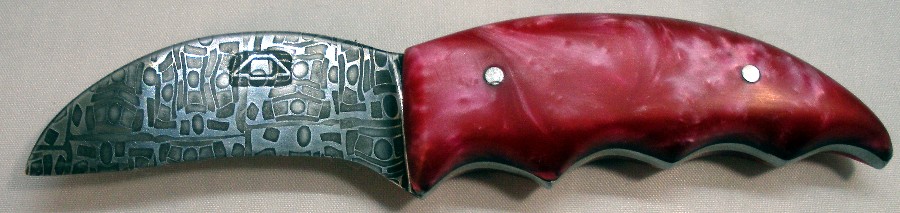

Finished the knife this morning.
