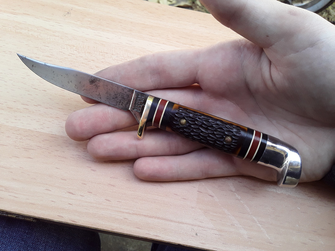

How interesting. I wonder what the special purpose of this kind of tang design might be.... if not just to be different?
Yeah, that tang looks plenty strong enough to be a knife tang. :thumbsup:
I wonder the same thing, and have for a long time.
To me it seems manufacturing related.
It allows them to do a handle setup like this that's consistantly easy to do.
I also think it could potentially in some way prove better for the life of the handle material than a narrow straight or stick/ rat tail tang running through a hole.
Here is a snip of the visual part of the patent for Western Boulder's bifurcated tang knives.View attachment 1630585
The story I've heard is that the H-washers in the forked tang were to avoid O-washers on a through-tang splitting when the tang swells with rust. Which I've seen a few times in Kabars and non-forked Westerns.
