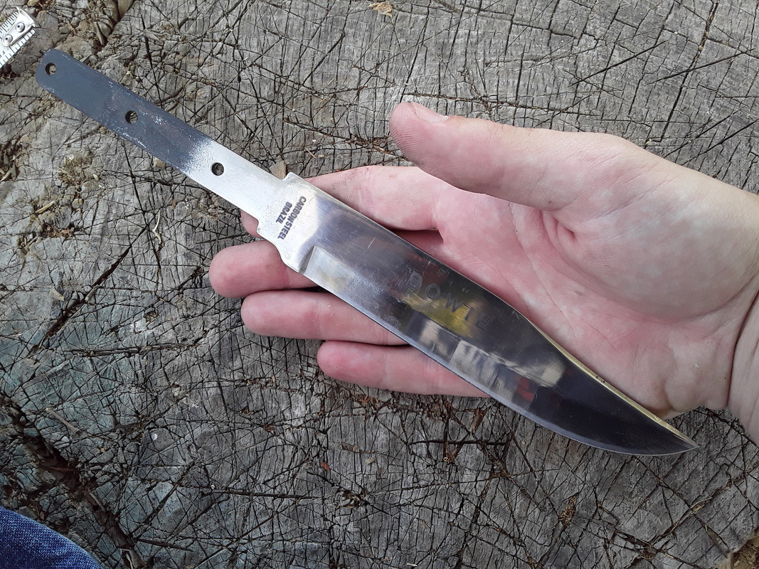

Any ever rehandled one of these budget friendly TRAMONTINA Bowies ?
I just scored this one on Ebay pretty cheap ( Tram makes good machetes, so I figure with decent steel it should be a good project knife )
The plastic scales enclose the tang, so I have no clue what the tang is gonna look like when I remove them.

I wish I could help you, but I have no idea on what that tang may look like under that handle.
If I had to guess, I would imagine it will have a similar profile tang to what the Ontario Kukri knife has in the post above.
I am curious to see what you find when you remove that handle... Please share that with us when you do 👍

Yeah from what I've found I believe it's going to be a standard hidden tang , likely full length.
The one post I found from someone who had rehandled one simply remembered it being " pretty long ".
I was kind of expecting something like you'd get with a rubber molded handle where it's often like a full tang but a bit oddly shaped.
