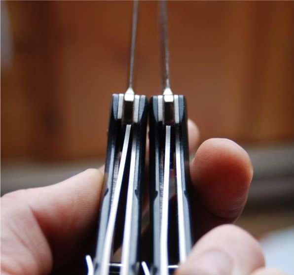

Here is the Avid on the left and my Pro on the right which is straight when opened.
So what does the Doctor order??
The Avid looks to be at 90% engeged which is a liitle much. The pro looks good. Unless you really like the avid the way it is I would try to get is replaced.
