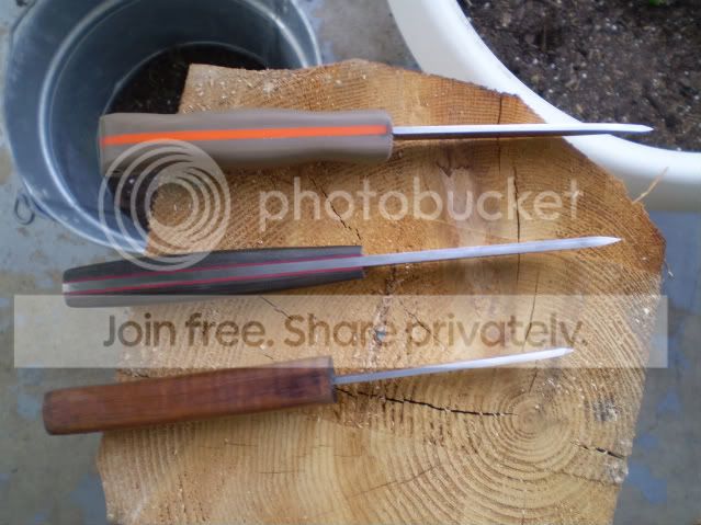

Thought I'd put a few of my favorites up to show. The top one is a Mora carbon blade, I got a long one and cut it down so I could have a bit more width to the blade. The handles are garrolite (G-11 I think, supposed to be a step up from g-10???) They orange is g-10, hidden pins and the tang is mortised in . My first one like this. The photo is misleading , cause the blade is not longer than the handle.
Next is my Enzo, well used and loved, all though I have been thinking of convexing it lightly. Hot vinegar patina on the flats. Oops, pic was before patina...Sorry. 0-1, true scandi.
Bottom knife is a reg laminated Mora blade I made into a drop point. Koa handle with a lot of Danish oil, a lot!
Anyway, I use these knives a lot, maybe less now that I have a micarta handled Fallkniven F-1 on the way, but I'm sure there's still room in the bag for another knife.

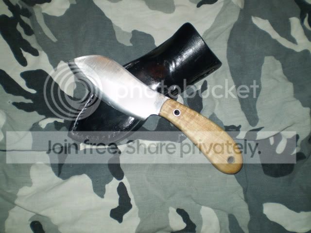

Here's a quickie I did a while back, I got a really wide old band saw blade and made a Nessy. Not too much polish and shine on this one, I made it for the wife, for a small camp knife. Knowing it would get a lot of use and charachter marks anyway. But she stole my Benchmade Activator instead. She has done this more than once! But if I get her one, I can buy another one, right??

Thanks for the compliments guys. Sketchbag, I just cut out and then sanded it to the shape I wanted. Then glue and pinned it together. Then more sanding. til it fit my hand just right.
Thanks Guys, Untamed, I made that Nessy as a proto to see if I should make a run of ones (with a bit higher degree of finish), but there are so many folks that make them now I don't know if I should try to jump in with them too. I don't want to step on any ones toes. So I'm gonna try to come up with something else. BTW that Nessy is about 8 in total length. I like it because it's light and still big enough to really work with. It's pretty thin stock, like 3/32 but I've done everything but baton with it. I'll probably eventually try that. Just to see how much I can beat it and it survive. But it whittles pretty good and makes an awesome slicer.
I like the nessie too. I prefer them a bit thicker though. I don't have one at this time but looking...always looking...
I'm gonna make some thicker ones too , sooner or later. Got some health issues right now waiting on surgery and then I'll start working on them. I'll post one when I get em done. This was the thickness I had on hand and it was to be the wifes camp knife so I thought it'd be a better slicer. It's stiff, has no noticeable flex either. Bu I do prefer about a 1/8 at least or really 5/32 .

Yep, I ground both Moras to drop points. Talk about a PETA! Try doing scandi grind free hand. I got them close with the grinder , then finished them on a stone. Gotta make a jig! Thanks for the compliments .
