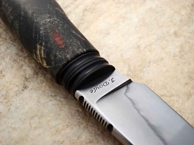

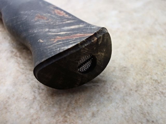

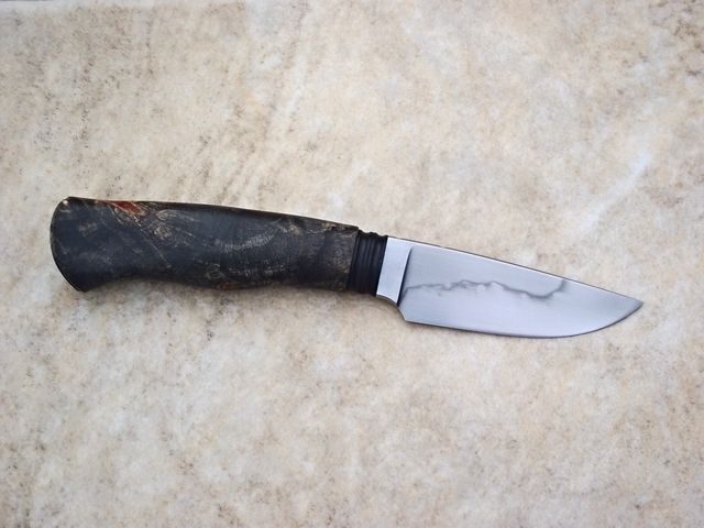

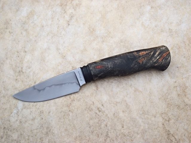

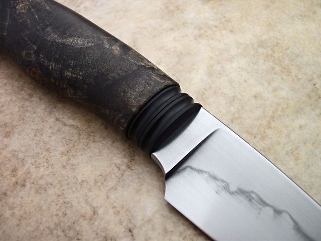

This is a nice little basic hunter that was a commissioned piece. Very compact, yet still a powerhouse. I was given some parameters but got to choose the wood. I picked out some buckeye burl as I think it's a very unique wood and flies under the radar somewhat. I can't hardly think of another wood that has such a range of natural colors and figure patterns often times in a piece of wood the size of a knife handle.
Specs:
Hand forged from 1075 steel, clay quenched and etched (the hamon has much more activity than I know how to capture)
7 3/4" overall, 3 1/2" blade, .175" thick at the ricasso
Full distal taper
Rounded spine and ricasso edge
Rounded filed thumb grip
Black g-10 collar
Stabilized buckeye burl handle
Checkered stainless steel finial nut
All comments and discussion are welcome.
