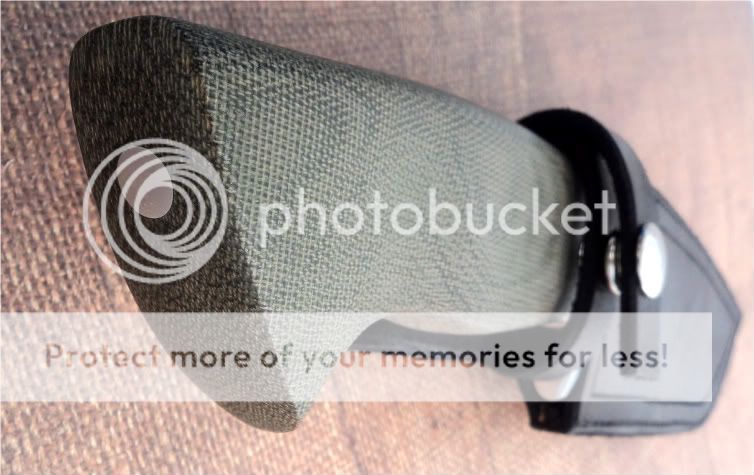

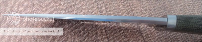

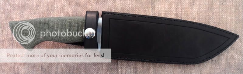

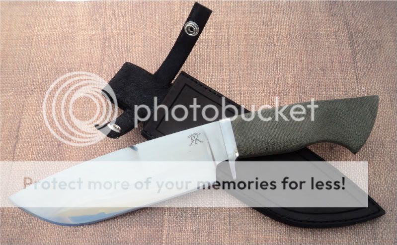

Here's a new one I just finished up in A2. The blade was heat treated by Bos Heat Treating to RC 59. The tang is almost an inch wide and extends to within .5" of the end of the handle where it is held in place by a corby bolt.
Blade: A2
Blade length: 8"
Total length: 13.25"
Handle: green canvas micarta
Guard and bolt: 416 stainless
Sheath: leather

Rob - as nice as your pictures are they don't do this knife justice. The fit and finish on this knife is superb! And it fits my hand like a glove. I can just sit and stare at this thing - it is truly a piece of art!
This won't be my last Loveday!!
